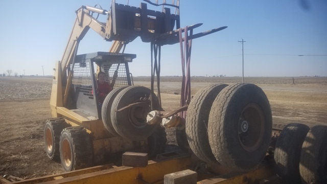

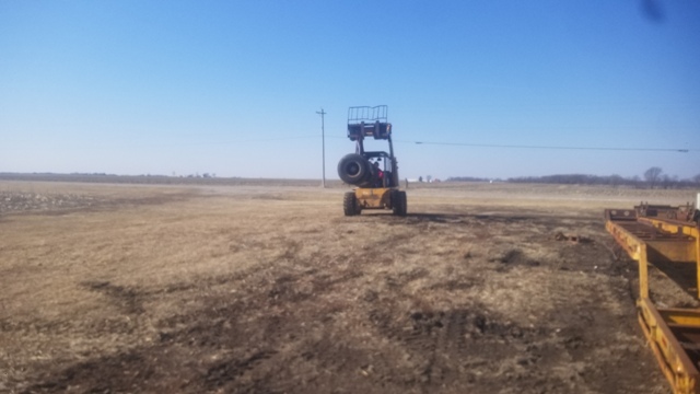

Being a firm believer in the power of "Slave Labor", I enlisted the help of my 14y.o. grand daughter to pick the axles clear and stage them while I drink coffee and watch:
Will be a bit easier to work with now.
