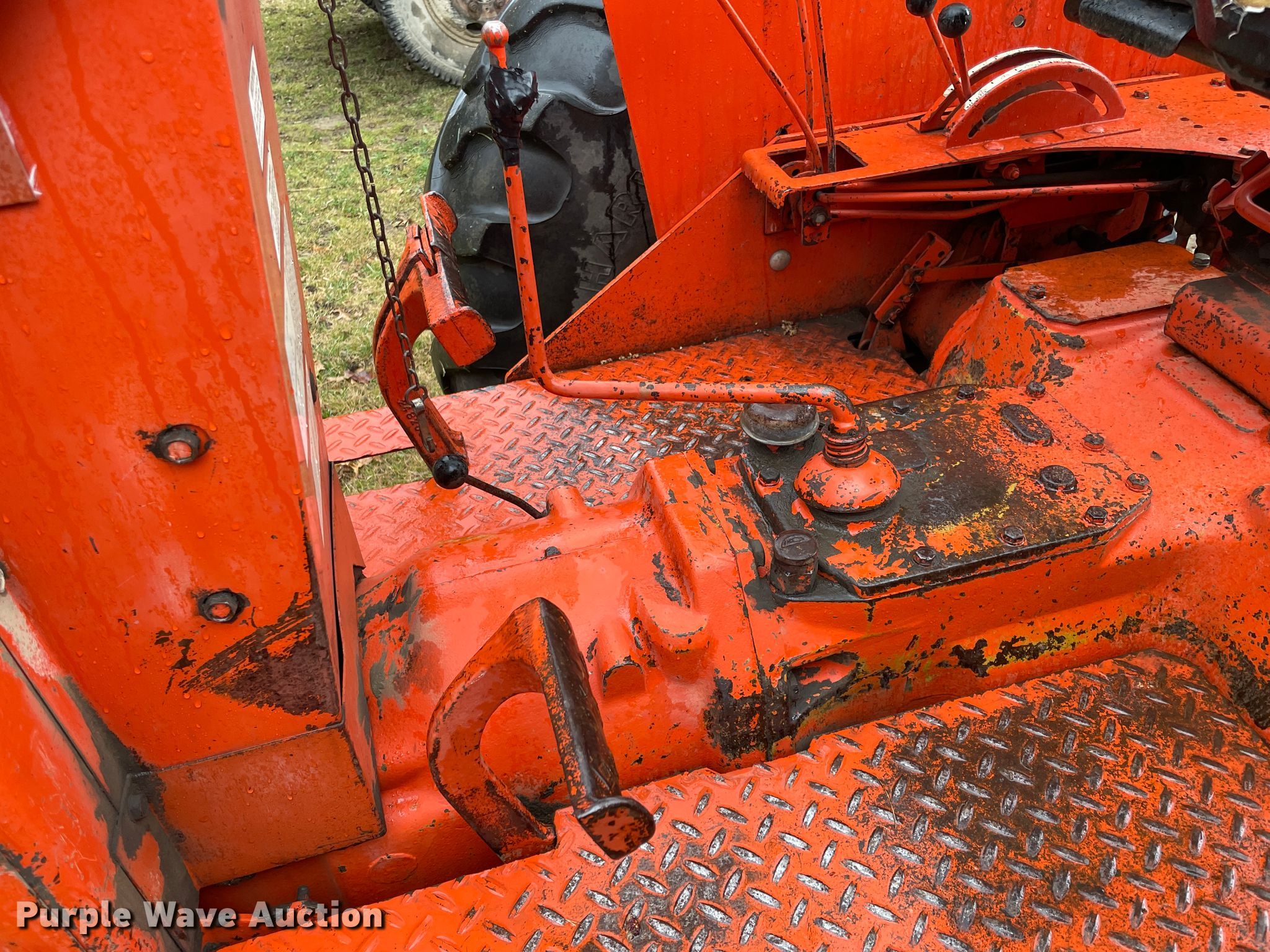

Hello all, wondering if anyone has pics of the traction boost linkage on a 180? Multiple issues on this tractor, one of which was an inop 3 point. Right brake was locked up also so I had the control valve and linkages on the bench (removed final drive). Cleaned and greased everything. Once I reinstalled, the linkage seems to flop around. Afraid I put it together wrong. The attached picture shows the top portion, I needs pictures of the bottom part under the step. Any help is appreciated. Thanks
