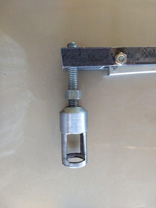

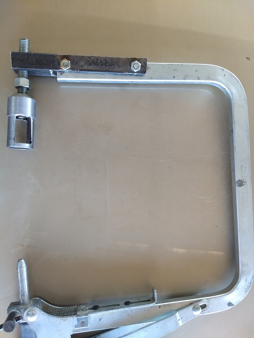

  a OTC 4572 large valve spring compresser,,(OTTAWA TOOL CO.),??  That is what is required to remove and re-install the valve springs on a Nissan KA24DE cylinder head. I have two different valve spring compressers but neither one has the attachment needed to reach the valves and keepers that are recessed down in the casting. I fashioned a "back yard special" ( I know ole Shameless will be so proud)  and got them off with great difficulty but almost lost one of the keepers that went flyin by my head and just happened to land on a piece of cardboard 10 feet away and just luck I heard it land,,,whew,,, Any of you mechanics got one of these,,??

 Nope,,Shameless,,,,,the top of the valves are recessed down into the casting bout 1",,, I'm gonna try to NR a piece of 1" round stock on my lathe and see bout makin it screw onto my big spring compresser,,,,Dang,,I wished ole Thad had of bought thet mill a couple of weeks ago,,,I could of had him mill it out for me,,,,,,,Wink

Back before I had enough cash to purchase a gen you ine store bought valve compressor I cut about 3" from a pipe, 1" I think?  I cut a couple notches in the side so I had access to the keepers. Then I welded a 3/8 bolt head down on a pipe cap and screwed it on the pipe. chucked it up in the drill press and  used the quill feed to lower the retainers. Later I bought a K-D but that shop built rig is still my go-to unit for installation works much easier than any other tool I have been around. That being said its lots easier to remove the keepers with a 3/4 (or so)  deep well socket and a hammer. Just hold down on the socket so it traps the keepers and give the socket a good rap. They even make a real store bought tool for this with magnets to retain the keepers.  Even with a real compressor things go much smoother if you knock the retainers first to  unstick things.

 Hey Butch,,,yeah,,I seen some youtube videos of one dude using two vice grips 180 degrees from each other on a deep socket and pushing down on the retainers  til the keepers came loose,,,! Very ingenius if I say so,,,,Clap
  Hey DakotaDave ,,,thanks for the info,,I already have a big Craftsman spring compresser and a smaller version  as well and didn't want to have to buy yet another $50 tool,,,, What I'm wantin to do is make that little threaded on one end "barrel" piece with the open sides that will adapt to the tools I already have. I guess the Ottowa Tool Co has gone out of business as I was hoping to buy that piece and then make an adapter to my tool but I can't find any info on them on the net,,,, Thanks for your input, Guy.Clap

 OK,,,,,ok,,,,I NOW have my own OTC 4572,,,,heh, heh, heh, ,,,,,,,,,,(I just know ole Shameless is gonna be SOooooo proud of me and my "resourcefullness" ) It just took a couple of ideas and a couple of hours of hard labor on my trusty lathe,,,,DANG,,,But I love thet machine,,,Clap I did take ole Thad's suggestion and made good use of two of my 5 grinders and fashioned the part I needed for my Craftsman spring Compresser. I removed the pusher ears off it and built this little number in it's place,,,
Chit,,I removed all 16 valves off the cylinder head with this in about a pair of minutes,,,,,,,,,
