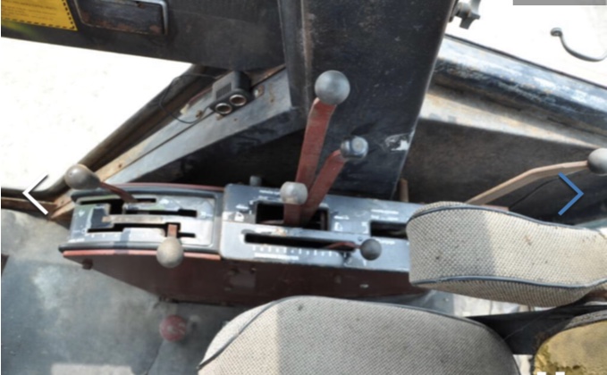

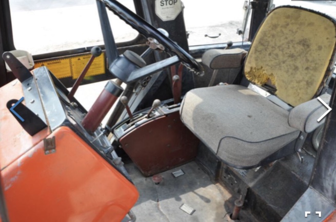

No. All power shift transmissions have the 6 speed gear selector in place of T-handle( black belly PD in right hand console). Here’s some internet photos of 1976(maroon) 7060 power shift cab console, which is also very similar to a black belly 7060.
