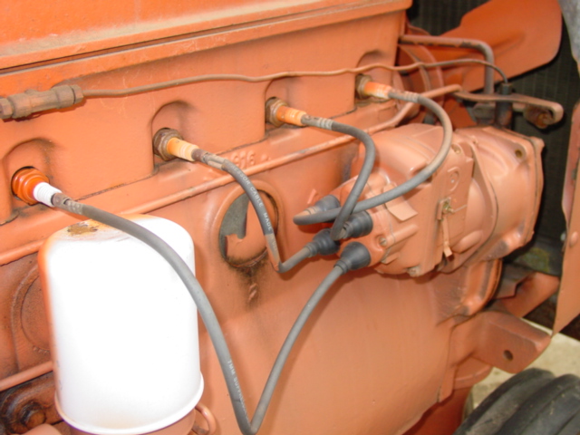

Actually it does not matter where the wire goes to the distributor as long as it fires on the number one cylinder on the compression stroke. Then calling it number one and go clock ways on the cap for a 1-2-4-3 firing order.
It is easier to keep track of if you set it up as intended like in my picture.
On these engines the distributor is just tipped up 90ยบ from a magneto with the wires in the same locations
