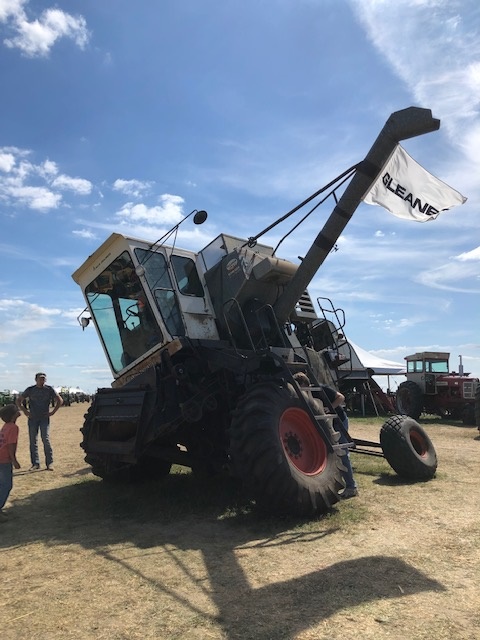

Saw a M/H at the half century of progress show in 2019

Brian F(IL) View Drop Down
Location: Paxton, IL
Points: 2719
Post Options Post Options   Thanks (0) Thanks(0)   Quote Brian F(IL) Quote  Post ReplyReply Direct Link To This Post Posted: 25 Jan 2022 at 7:59am
I think this is the one I saw at the HCOP in 2019 but I believe it was a G model hillside.

Post Options Post Options   Thanks (0) Thanks(0)   Quote SteveM C/IL Quote  Post ReplyReply Direct Link To This Post Posted: 25 Jan 2022 at 8:33am
Pretty neat what they came up with to navigate slopes.

tom51 View Drop Down
Bronze Level Access
Bronze Level Access
Joined: 04 Apr 2019
Location: USA
Points: 63
Post Options Post Options   Thanks (0) Thanks(0)   Quote tom51 Quote  Post ReplyReply Direct Link To This Post Posted: 25 Jan 2022 at 10:02pm
That’s the one I saw Brian may be mistaken on the model
