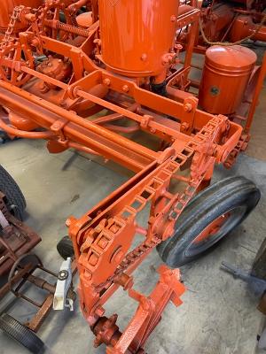

Trying to figure out the detachable chain size on an AC G 2 row front drive fertilizer.  From the charts it looks like 42.  I believe it is the same size as the AC G 2 row corn planter

Do you have a picture of the unit.
I see two.
912493 which says #32. Average pitch 1.157
And
913857 which says #25. Average pitch .904

Assume your talking about the missing chain in picture. Parts book says 912493 which is #32 link.  Average pitch 1.157. And takes 46 links.
#32 link is also 10 roll 545040
