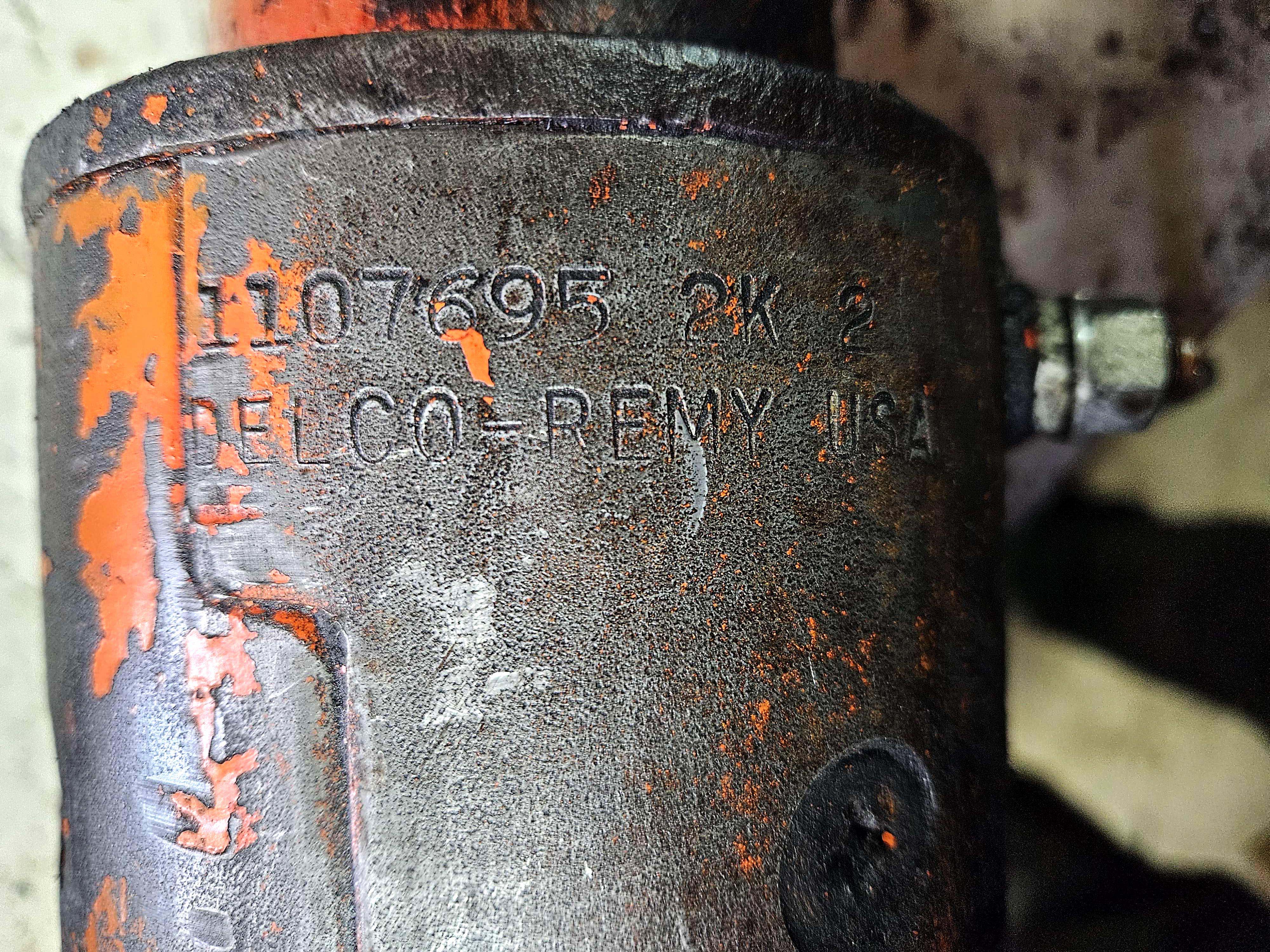

Delco starter 1107695 - broken teeth
ElementalEarth View Drop Down
Joined: 05 Oct 2023
Location: Canada
Points: 127
Post Options Post Options   Thanks (0) Thanks(0)   Quote ElementalEarth Quote  Post ReplyReply Direct Link To This Post Topic: Delco starter 1107695 - broken teeth
    Posted: 18 Mar 2024 at 6:30pm

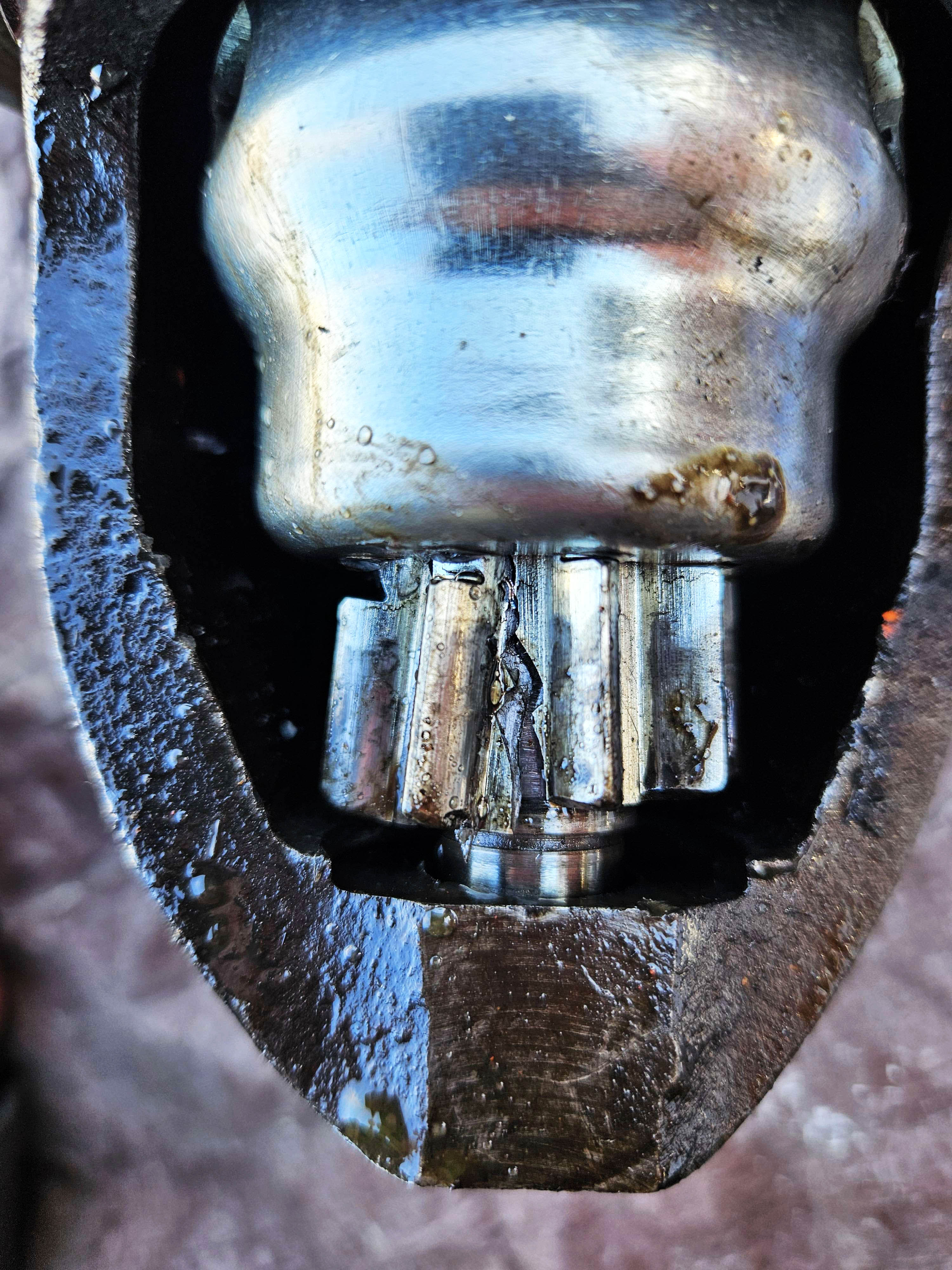

Well, today I swore a lot. I was almost done with the repairs of the tractor, see my other lengthy thread, and I wanted to start the tractor as I was diagnosing an erronous temp gauge. Much to my surprise, the tractor started right up, but it seems the starter gear was stuck in the flywheel as I heard the starter still spinning while the engine started running.
I turned it off and tried to turn it on again, but unfortunately, no game.
The starter wouldn't budge anymore. So after a long session of swearing and trying to get that inner bolt off,I still haven't found the best way to get that in and off, I managed to peel off the starter and behold.. it needs new teeth.
How hard is it to replace the teeth gear ? Is there a reason why it would get stuck in the flywheel? Can I get a replacement gear or do I need to get a new starter?

That is the starter drive that is broken. It is replaceable separately. Ensure your flywheel teeth are good as they may be the root cause and require a ring gear replacement.

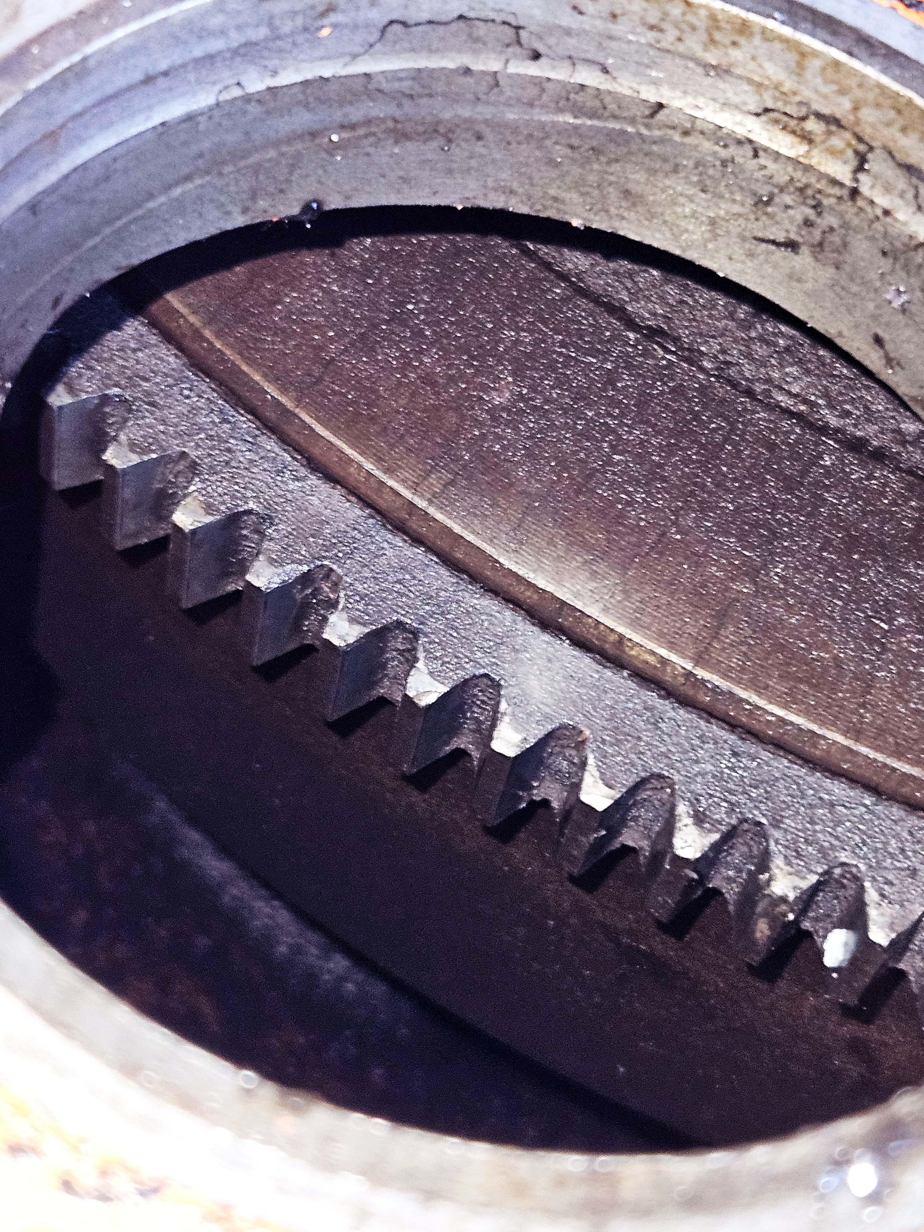

How hard is it to dismantle the starter and replace the gear?
The teeth on the ring gear look in good condition, other than some damage where the starter broke its gear, what do you think ?

If the ring gear is bad, you have to split the tractor to replace it. It's not expensive, but quite a lot of labor.

Just checked the ring gear. Teeth are all there, other than a bit of surface wear in the spots you mentioned, looks pretty good still. I think it's alright. The starter however is not. I located a new gear for it and am eager to dig in to see what i find.
It does turn the tractor over slowly sometimes.. is that the usual way it goes?

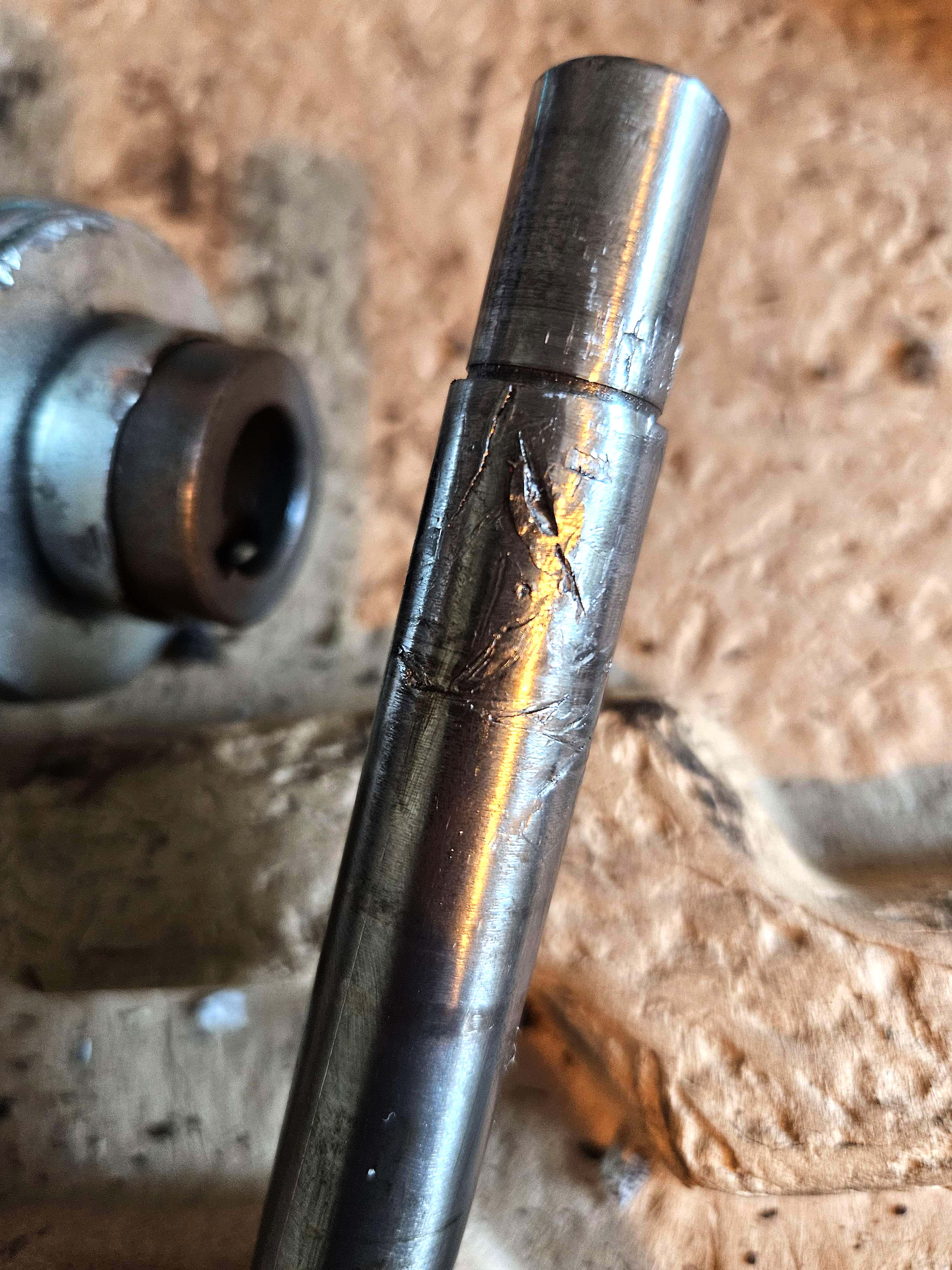

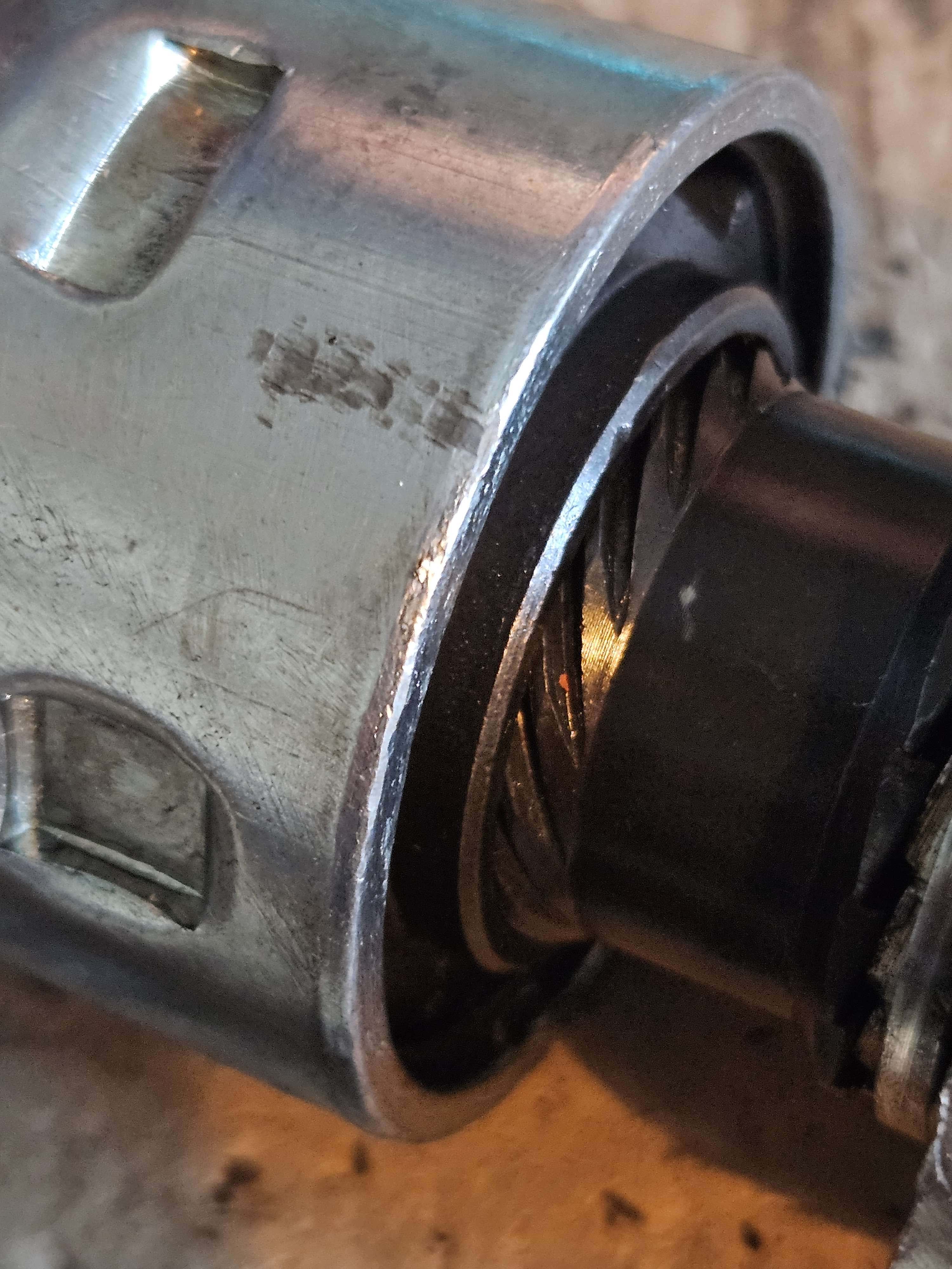

Hello again, and here with the latest greatest. Here are my findings.
The problem seemed to have occurred when grease/oil along with debris particles made their way into the starter drive spiraling screw.
A particle binded up the screw part of the drive so it was not able to retract fully back into the housing and voila, a broken gear as the result.
Here in the picture it is only partially showing anymore, as I had worked it back and forth and removed the bind. A new starter drive is ordered and on the way.

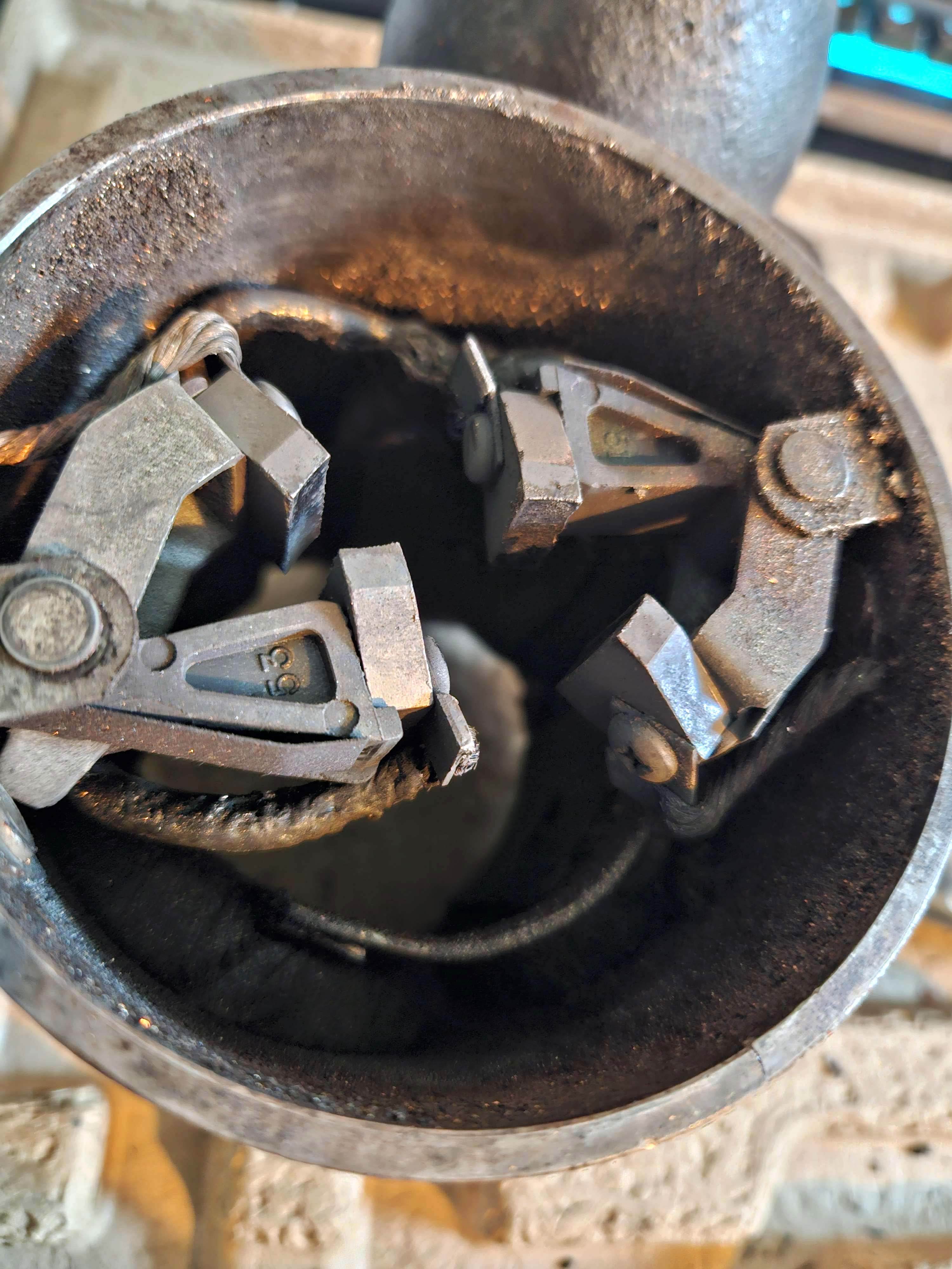

As my further findings, the destruction of the gear itself created a bit of disturbing scarring on the armature of the shaft, I'm hoping with a good sanding and polish I can work out the rough spots on that and have it function like before hopefully.
It was shards of the broken gear jammed by the flywheel of the engine that created these cuts.
As far as the rest of the starter, a lot of this golden metallic dust was found at the bottom, I assume this has to do with the brushes wearing out over time? What are these made of I wonder, that they "shed" shavings like this and is this potentially where a fleck of this debris came from that ended up in the starter drive further up front of the starter.. it is a possibility.
I will clean out the end part really well and hopefully that takes care of that for a while.

No idea what the clearance should be for the gear to the full front of the nose of starter, but it's looking much better than with the old broken starter drive that didnt want to go back in.
