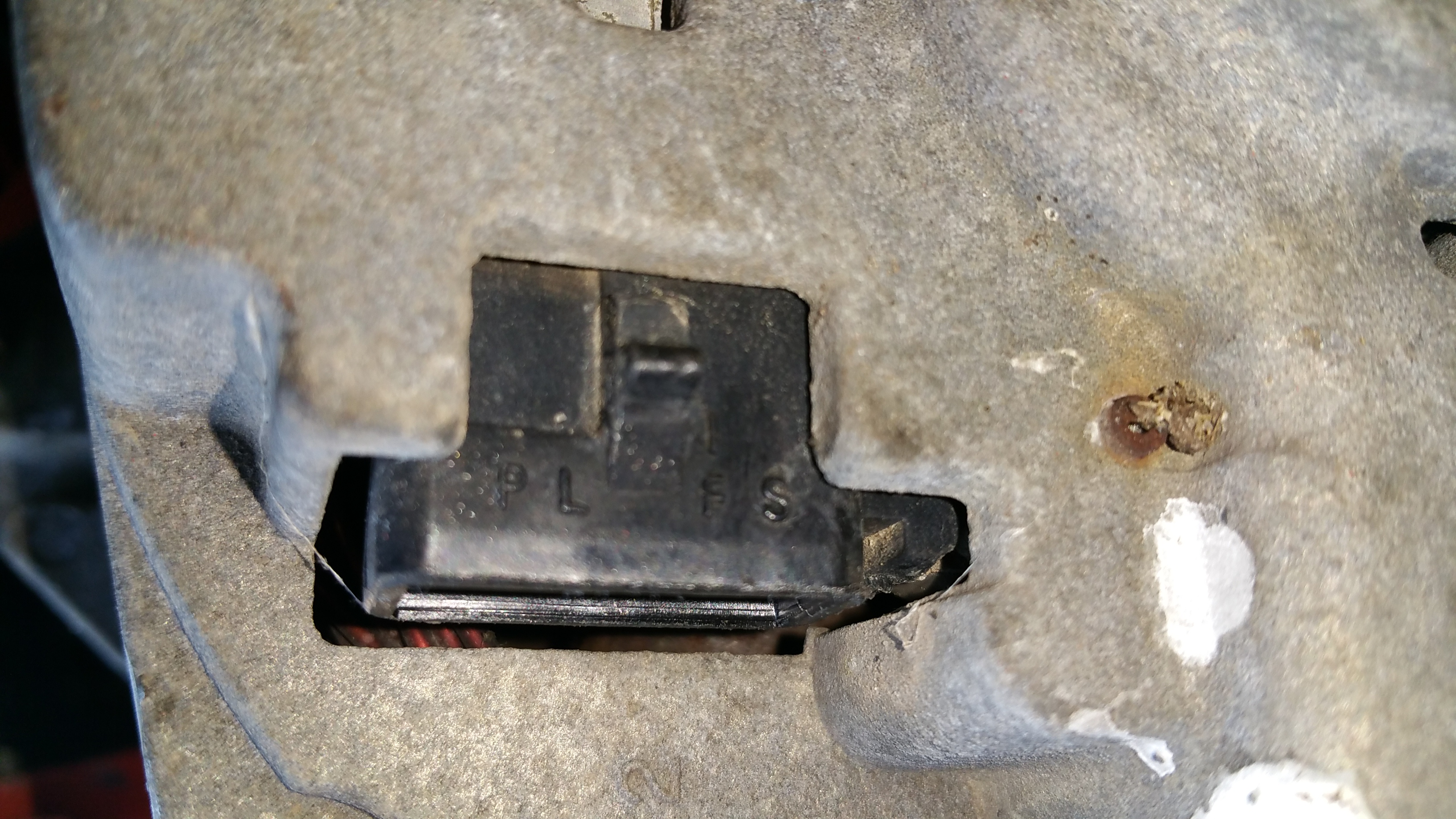

All,
I bought a tractor that has what I believe to be a CS130 alternator. It's not charging. I've looked at various diagrams online and I don't think that it's wired correctly. However, I've never worked on one before. It's currently wired using the L and F terminals. I need a little help to determine what the correct wiring should be and if the alternator is good/bad. I have another unit but I don't want to throw it on there and risk damaging it. I also don't know if my spare is any good.
Thanks,
Aaron

This is from a DELCO book.... I use a 100 ohm resistor........... Not the same wireing as used on the 10 SI..
this is what you have now... You have the BAT and the L terminals connected, and no kick in resistor........I dont know how BIG your switch is, but not a good idea to switch the BATTERY cable to alternator ON and OFF..

Post Options Post Options   Thanks (0) Thanks(0)   Quote WD45 Aaron Quote  Post ReplyReply Direct Link To This Post Posted: 07 Jun 2022 at 9:05am
Steve,
Thanks for the info. Couple of questions. What should the wattage rating be of the resistor? The last diagram is for a magneto. Where would you pull coil power from in that diagram? It would have to be switched to shut it off.
The switch that was installed by someone previously is just your basic toggle. The alternator, coil, lights all run through it. No fuse either.
It seems to me that there is no way that it could produce power with the field grounded. That was throwing me off when I was looking at it. There's a video on YouTube where a guy talks about his vehicles that have both the L and F terminals wired, but mine is not the same (nor correct).
