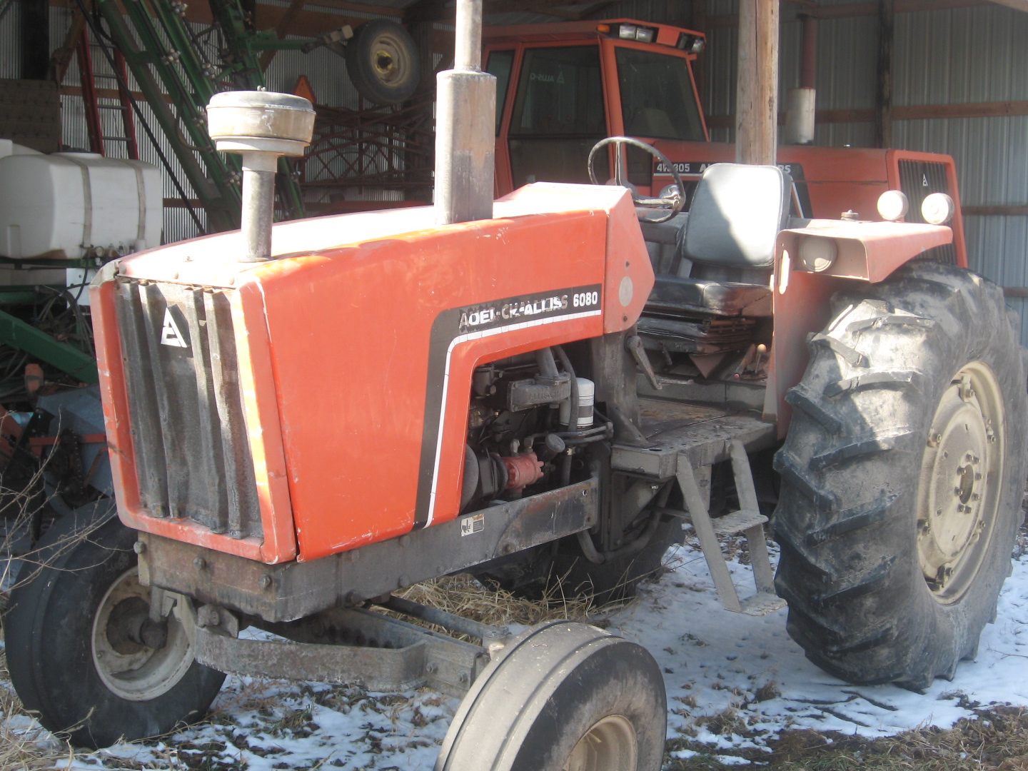

My 6080 had some of the Deutz-Allis decals left on it. I got them off with no problem. The only problem is someone else had tried to take them off and left a film of sticky residue on the Allis decals. When I tried to use the heat gun to take it off it gets the Allis decal too hot. How can I get this residue off? Any help would be appreciated. rrhead(SD)
