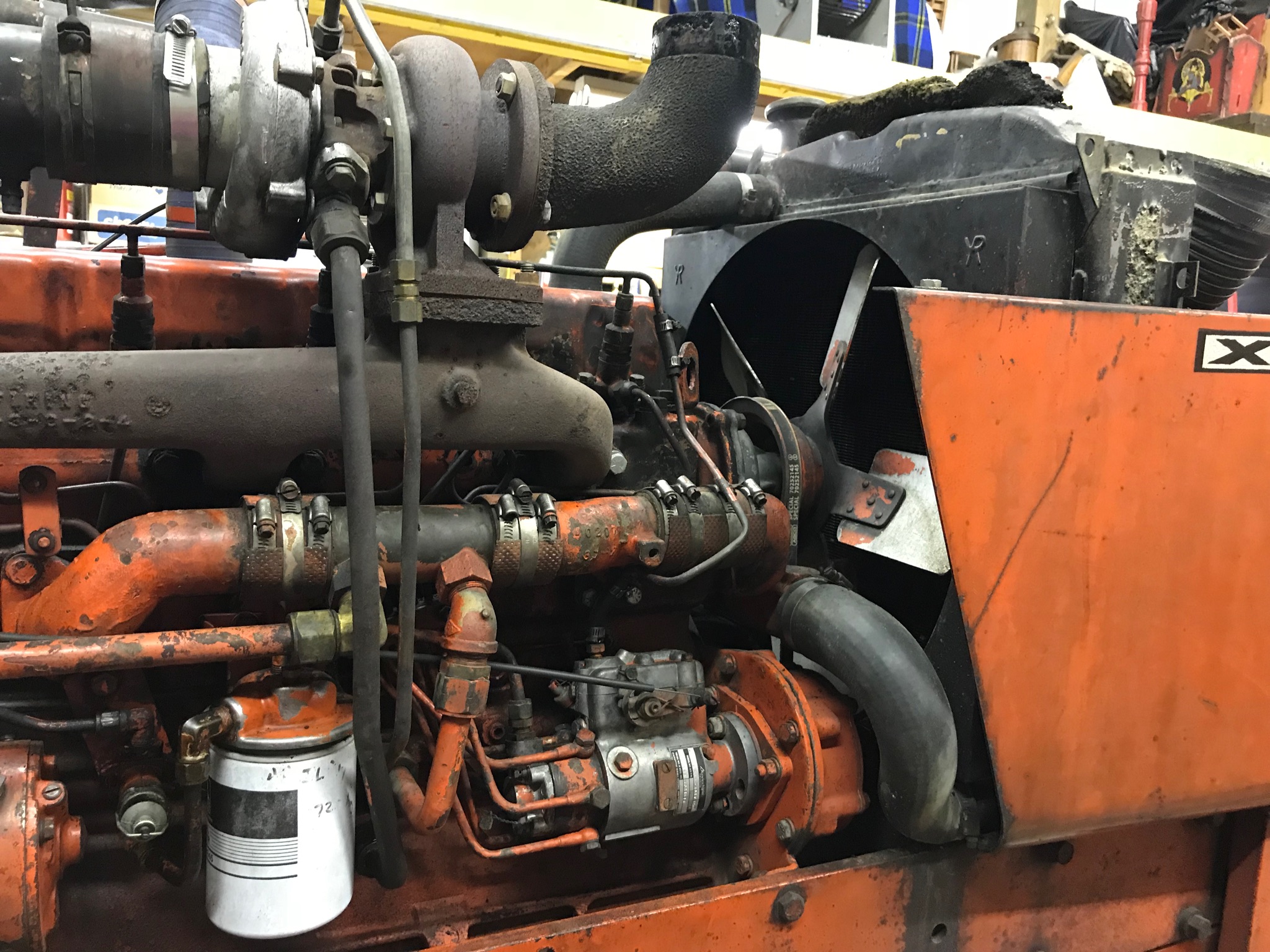

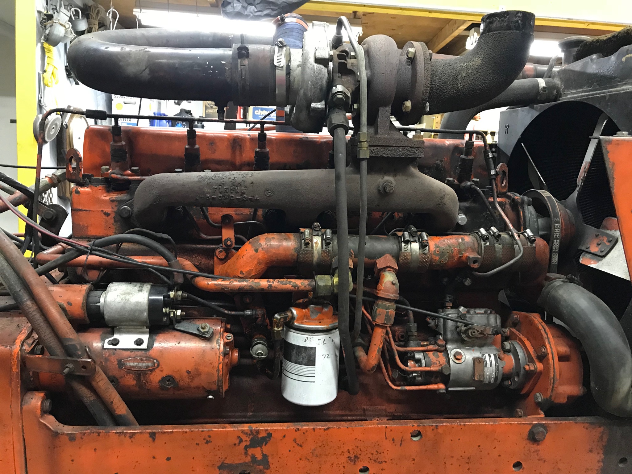

Please post a picture of your engine while the hood is off... thanks

JC-WI View Drop Down
Points: 34621
Post Options Post Options   Thanks (0) Thanks(0)   Quote JC-WI Quote  Post ReplyReply Direct Link To This Post Posted: 17 Aug 2018 at 6:39am
I am thinking he has a straight 190 and the ex is coming straight up from the manifold...
 unless somebody slipped a turbo in backwards on a straight one-ninety...  thats why I was hoping for a picture of engine.

  I am in the process of doing just that but won't get them on "here" 'til tomorrow evening. All I am saying is that "his" pipe in the pic looks WAY far forward unless it is the "PRE CLEANER" stack and NOT the exhaust?? Perhaps the pic of his is "optical" illusion to me?? No dis respect intended to anyone. BTW,what is the 2-2 1/2" piping with the rubber hose clamps above and to the rear of the injector pump on the pictured XT?? I will have to get out to the farm tomorrow to take a "peek". Thanks!!

After seeing your pic Charlie, you are 100% correct!! It just seemed like D's pic showed the stack way ,way forward,LOL! I have a feeling I am confused with our gasser 180 that has discolored the A/C decal on the muffler side?? Thanks

The oil cooler is what your looking at with the hose clamps above the injection pump.

Engine pics, BTW. Thanks to all that replied!! Thumbs Up

Looks like a 190XT to me with an updated turbo...
  Thanks Jeff for posting your posting your pics.
