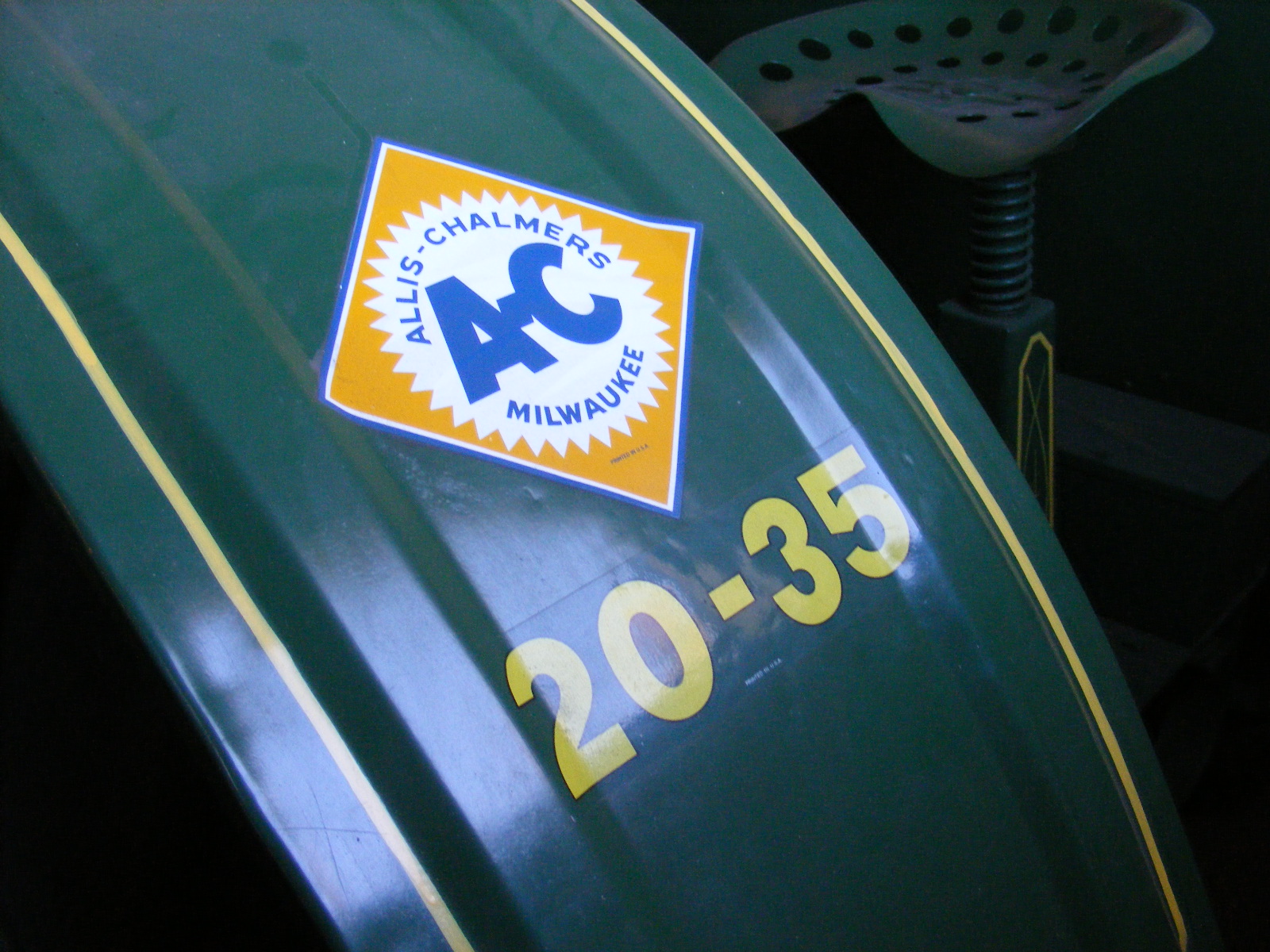

Dave,  Rear fender decals are as shown. One set on each rear fender. The model numbers are 13 inches from the end of the fender to the bottom of the number decal. It is 16 inches from the end of the fender to the bottom of the diamond.

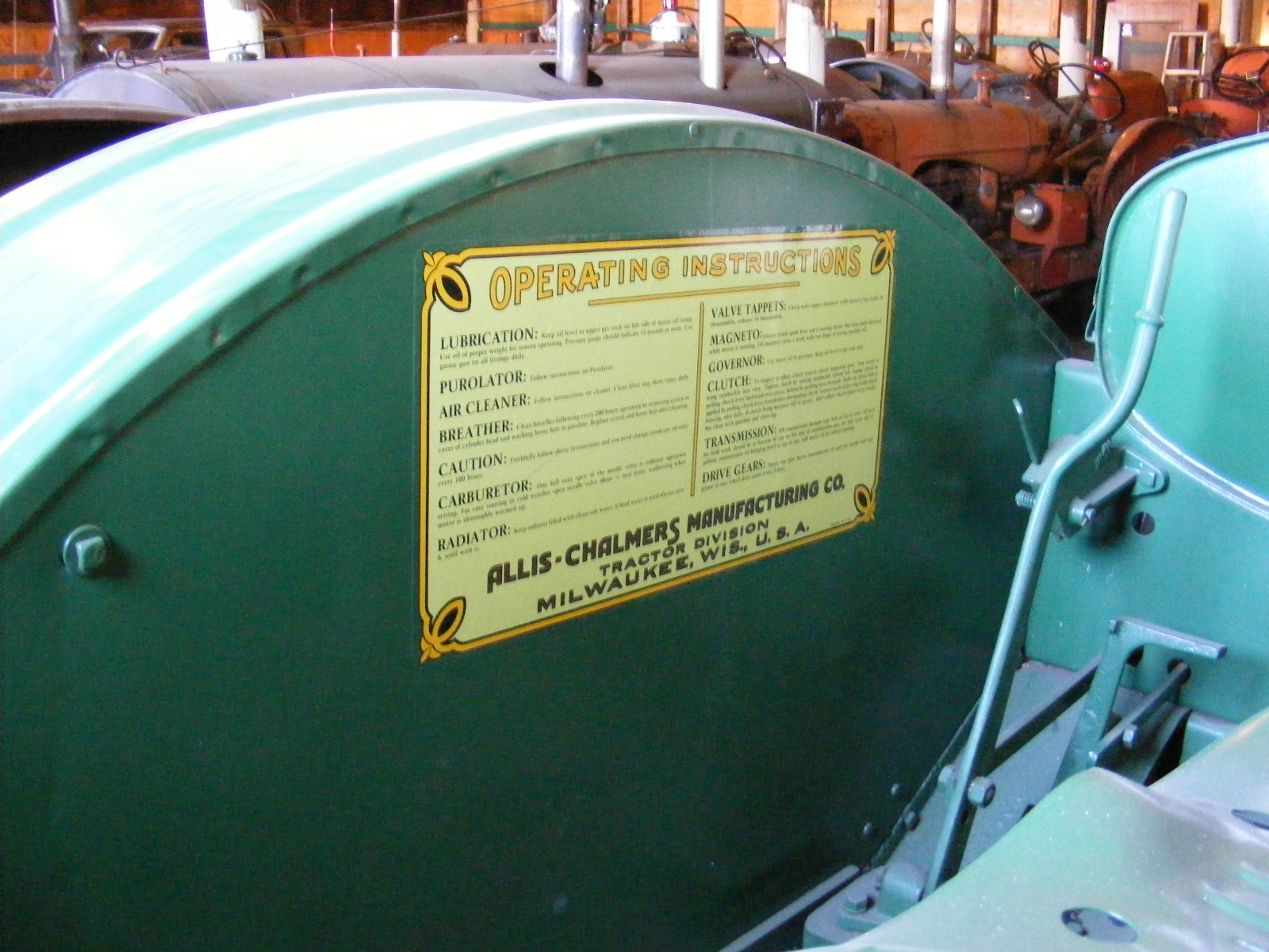

The large instruction decal is about in the center of the fender panel and measures 3 1/4 inches from the top of the decal to the top of the fender.

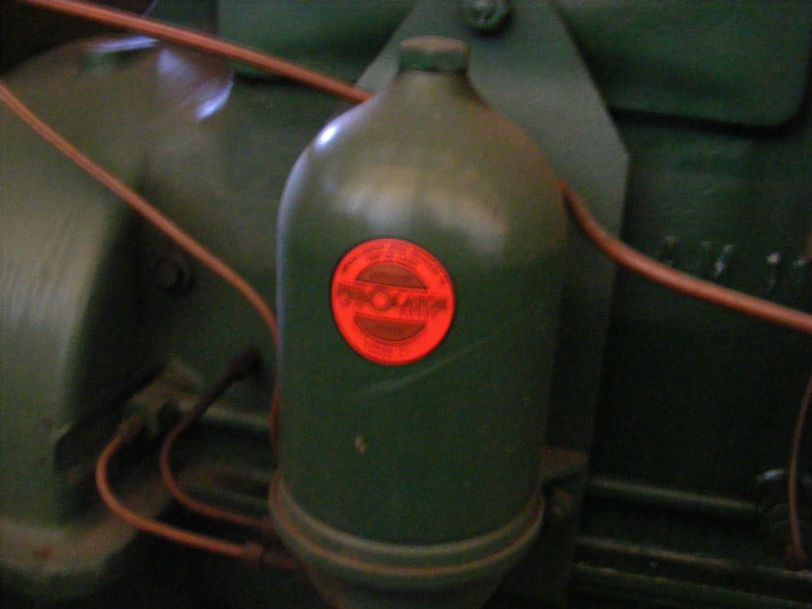

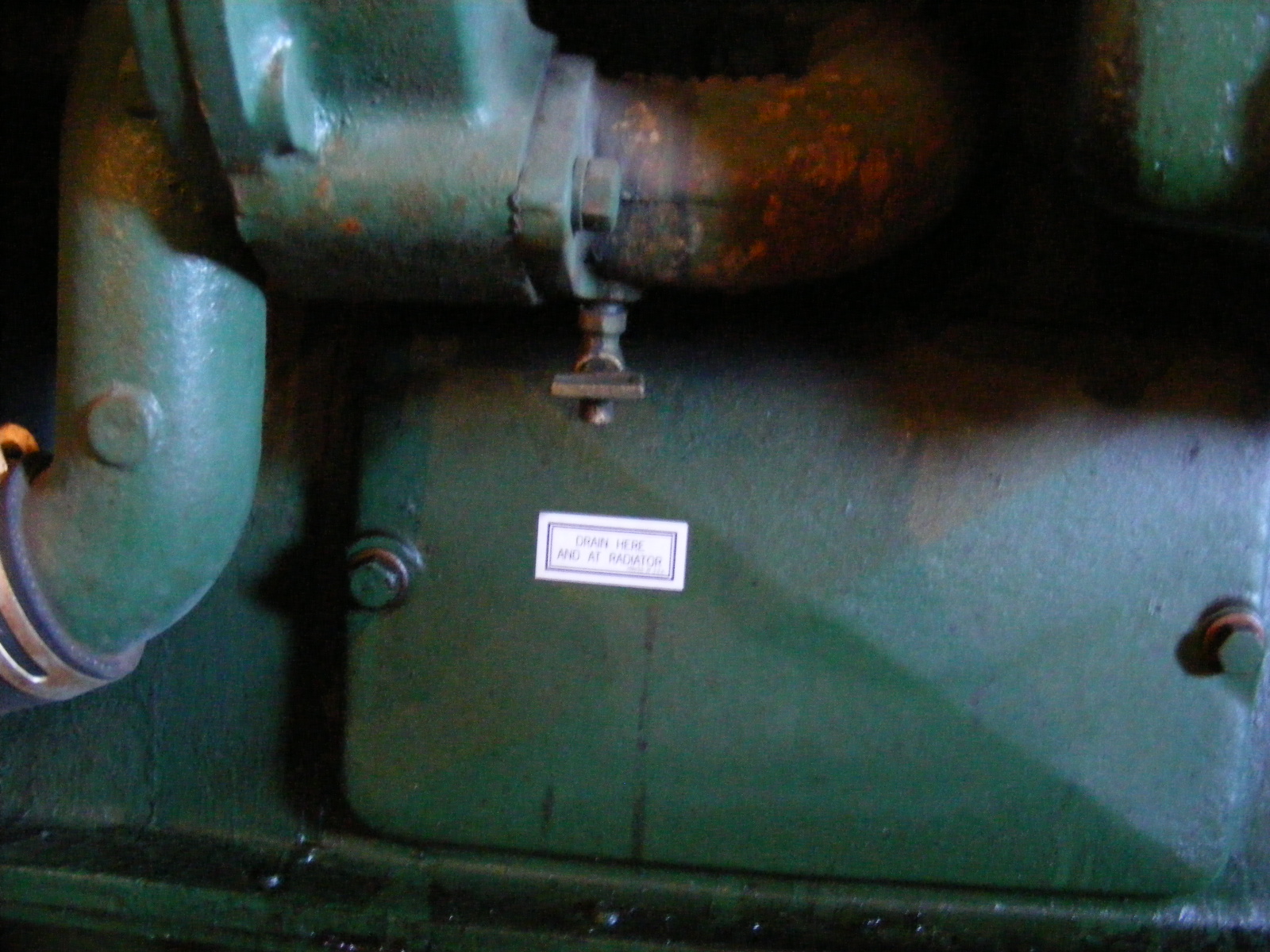

The small oil filter, water drain and clutch lube decals are obvious in the pics. I don't know about the tank diamond decal. I've seen some with this and some without. (Sorry about the blurry pics, but I think you can make them out.)
