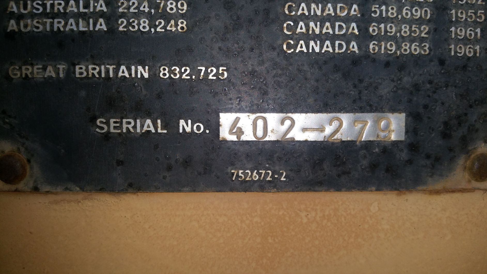

HI EVERY/ONE,   IM NEW AT THIS BUT I WOULD LOVE A LITTLE HELP OR ADVICE PLEASE.     I HAVE A LITTLE DD GRADER 402-279 WITH A SICK STARTER MOTOR,

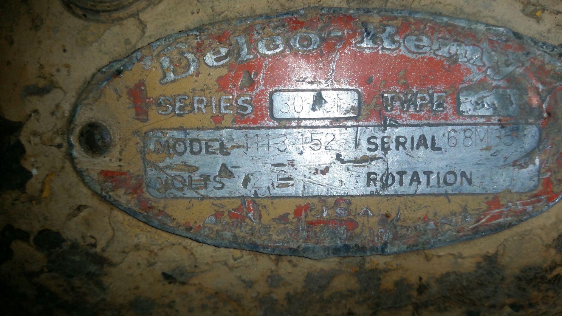

ARMATURE IS BURNT WHERE THE BRUSHES RUN,
HAVING TERRIBLE TROUBLE SOURCING ONE IN AUST,  STARTER OR ARMATURE,
CAN ANYBODY HELP OR ADVISE PLEASE,    PLUS DOES ANYBODY HAPPEN TO KNOW THE YEAR MODEL OF THE GRADER GOING BY THE SERIAL NUMBER .

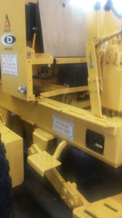

The number given, 3 digits-3 digits, is not a serial #.  Find the serial # on the tag, on the right side of the grader, where you step up, to get into the operators station, on the lower frame.  Should be a 4 digit number.Wink
On edit, noticed you are from down under.  Australian AC's had their own numbering system, my books don't cover those...Wink
Edited by DiyDave - 04 Jul 2020 at 5:01pm

North American (Canada & US made) have the serial number here:
   I do not know about your grader's production. If you can send us pictures, we probably can help sort it out.    Ross D.

From Dave above "The number given, 3 digits-3 digits, is not a serial #."
From my rounds with an AC Forty Five that is likely the serial for an Australian production.
If you have a parts book you can play the "modification game" - "mine has this, doesn't have that" and arrive at the general area of what it would be in US numbers
The starter will likely be same as a US produced one if you can find a tag on it - I'd guess a Delco of some sort.  And if it is like the "45" a current Delco series might bolt straight in.

YOU ARE VERY CORRECT       THE SERIAL No IS AUSTRALIAN,

I WILL GIVE YOU THE NUMBERS ON THE STARTER        YOU MAY EVEN COME ACROSS ONE YOURSELF, YOU NEVER KNOW. Smile
DELCO
MODEL      1113152
SERIAL     68M05
VOLTS     12
SERIES     30 SOMETHING [DAMAGED PLATE]       THANKS MATE.

ILL SEND YOU THE NUMBERS ON THE STARTER PLATE,   JUST MAYBE WITH A BIT OF LUCK SOME BODY MIGHT STUMBLE ACROSS ONE LOL  Smile .
DELCO
MODEL     1113152
SERIAL     68M05
VOLTS     12
SERIES     30 SOMETHING [DAMAGED]        THANKS MATE.

ILL SEND YOU THE NUMBERS ON THE STARTER, MAYBE YOU CAN COME UP WITH A SUGGESTION LOL,
I CAN SEE MYSELF CUTTING AND FITTING FAIRLY SOON,
DELCO
MODEL     1113152
SERIAL     68M05
VOLTS     12
SERIES     30 SOMETHING [DAMAGED]       THANKS MATE Smile Wink

You might be further ahead to get a reman starter:
https://www.google.com/search?client=safari&hl=en&q=delco+starter+1113152&spell=1&sa=X&ved=2ahUKEwiVmtfJ3b3qAhXQB80KHWg0BWsQBSgAegQIBRAC&biw=667&bih=325
Looks to be the same as D17 and D19 Diesel. Also for DD grader.
