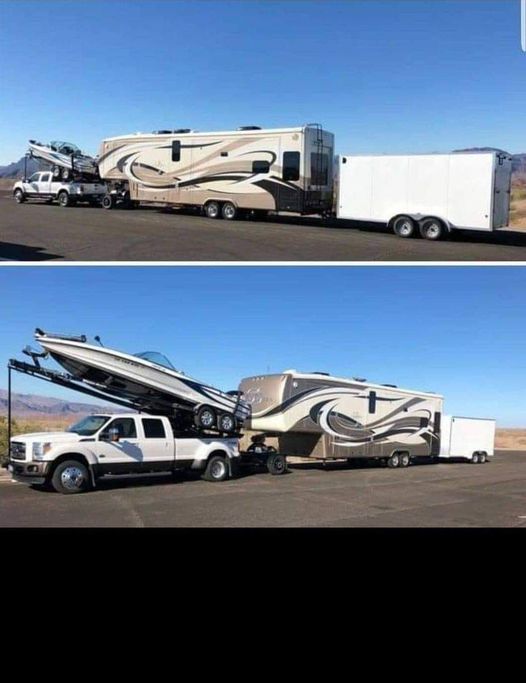

Think this was just a stunt??  Just to get a pic?
NOBODY can be THAT dumb can they?

While it is dumb and dangerous, I'm kinda impressed

That's actually a legal load.  Driver will need a Class A CDL, and in most states, an endorsement for doubles and triples.
Let's break it down:
First off, the Gross Combined Weight of the tow vehicle (tractor) must not be exceeded, and Gross Axle Weight Ratings must also be respected. That appears to be an F450... but COULD be an F550.  My F450's were typically 18,000gvw, with 6000lb steer and 13,000lb drive.  Without the (heavy) service body, my chassis wet weight was 8300lbs.  With the 9'x12' service body EMPTY, that went to 10700, and with all my tools and equipment, it was 15,200.  THIS Truck's GVW is certainly not exceeded with that factory pickup box (they're only about 900lbs) boat on top, that fish'n ski only weighs about 2100lbs dry (tandem axles are for durability when running with water in the baitwells).
The dolly accepts a significant amount of the 5th wheel's nose weight.  The camper has tandem singles, they're clearly nothing exotic... the 'standard' largest axle capacity common to campers is 8 on 6-1/2" bolt pattern 7,000lb, and trailer tires commonly match this.  Two 7000lb axles, plus 10% on the nose comes to 7+7+1.4=15,400lb GVW for the trailer... and probably under 1000lbs for the dolly assembly... so 16400 if it's fully loaded.
The enclosed trailer at the back appears to have 5-bolt axles, which  puts them in around the 3500lb class... so that trailer will be in the 3500+3500+10% = 8000lb GVW range.
So let's say the Tractor's GVW (not it's loaded weight) is 16,000, TOWED stock comes to 16,400 + 8000, for Gross Combined Weight of only 24416.
The pickup's Gross Combined rating ('towing capacity') is upwards of 28-30,000lbs.
As long as all axles have brakes (in this case, electric), all lights work properly, the total length, height, and width combination is within the driver's CDL endorsement, this is legal, and there's towing capacity to spare.
A bit extreme for some?  perhaps.  Dangerous?  Certainly not when done properly, by experienced professionals.
Would I do it?  No... but that doesn't make it idiotic, and I would know-  I'm a well-experienced  and versatile idiot.

There's insufficient clarity of the photos posted to determine the lug nut count or tire size, but I know my F450 service trucks well... my team's fleet consisted of 8 F450's starting with 2003, all the way up to 2019... and yes, one COULD get an F450 with a pickup body, as we changed out our entire fleet every two years, or after ONE of the trucks hit 100,000mi.  After we removed our service bodies, our F450's were fitted with dually pickup bodies and sold to construction contractors and RV'ers.
From these photos, it's clear it's a Crew Cab, and a DRW.  Let's assume it IS an F350, and while I don't know the year, most of the specs don't change much year-to-year (except the introduction of the aluminum body, which reduced tare, thus yielding a higher capacity at same GVWR).  As an example, I looked up the 2019 specs sheet, which lists the F350 Crew Cab as a 14,000gvwr truck, and advertises it's payload capacity as 6550 (for the 4wd) and 6970lbs (Rwd)... the difference clearly being that the 4wd version had an extra 450lbs or so of driveline to lug around.  That boat weighs under 2100lbs, so there's a whole lot of load room left.
Towing capacity is expressed in Gross Combined Weight, and nothing else.  It doesn't matter if the entirety of the load is in draft, or distributed to the vehicle, it is part of the full combination.  In a 5th wheel application, a significant portion of the load is borne upon the tow vehicle, just like a semi-tractor, and when that hitch is placed slightly forward of the rear axle, the towed load is proportioned onto the front, as well as rear axle.  When a bumper hitch is used, the tongue load bears well BEHIND the drive axle, and the result is a higher axle load than the actual tongue load (because it is now an overhanging load) and also, the steer axle is reduced... lifted up.
In the case of this setup, the 5th wheel dolly acts just like a heavy-haul 'booster', carrying a significant amount of tongue load, but keeping a little on the hitch to assure stable tracking.
Gross Combined Weight Rating for the F350 goes all the way up to 31,300lbs.  There's no reason to suspect this rig exceeds the truck's GCWR.
It is a legal configuration in many states, and I've weighed plenty of them.

Go ahead and accept the minimal game, I do not, will not. Truck is a rolling dumpster fire looking for a reason to destroy itself and much more. If need all that ‘stuff’ and have the money to afford can take a flight rent a car and stay at a Five Star Cheaper. Do the math, it is pretty simple. As to campgrounds, list the ones that will accept that mass of garbage, fewer than 250 nationwide as have been explained and costs reflect unavailability.

I just wanna know how high the bow of the boat is.

That's a valid concern-  based on the angles of those two photos, it looks to be mebbie a couple inches higher than the top of the RV.  If there's an AC unit, open vent, or TV antenna atop the RV, then they're about the same height.
