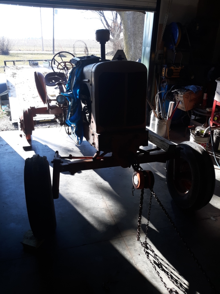

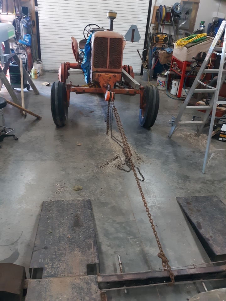

Here it's being dragged in off the tilt trailer. Since the tires are off, I removed the snap coupler set up so it would roll on the wheels. I put 2xs underneath to prevent them from gouging the floor and new trailer deck. In another thread there was discussion about hoists. Here I'm using a chain fall anchored to the lift to pull in. Funny, just yesterday I saw Ian on Full Custom Garage do this very thing.That's 3 time in 6 months I've had to do this. Now considering an anchor on the back wall with a winch should work better.

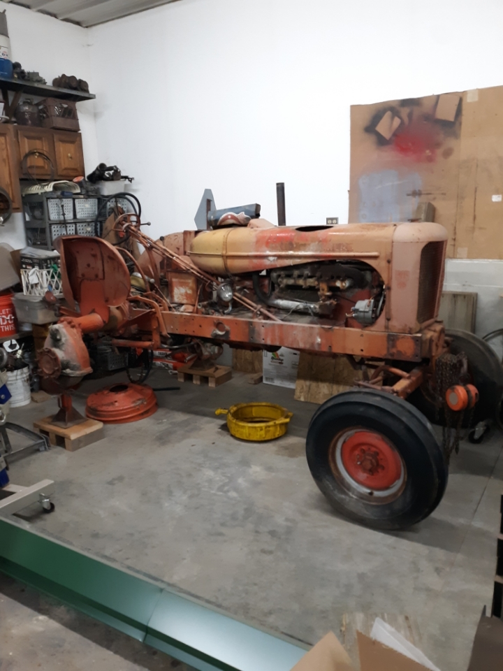

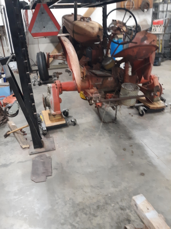

Rear wheels off and on the skates to spin 180 and to the right.
In position for tear down
My stepson says this is where the magic happens. He redid a Nova here and is where the 170 got an engine overhaul and new clutch.

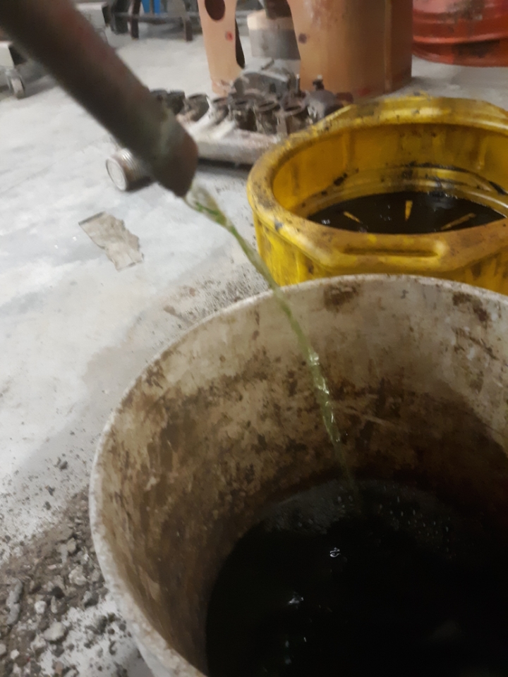

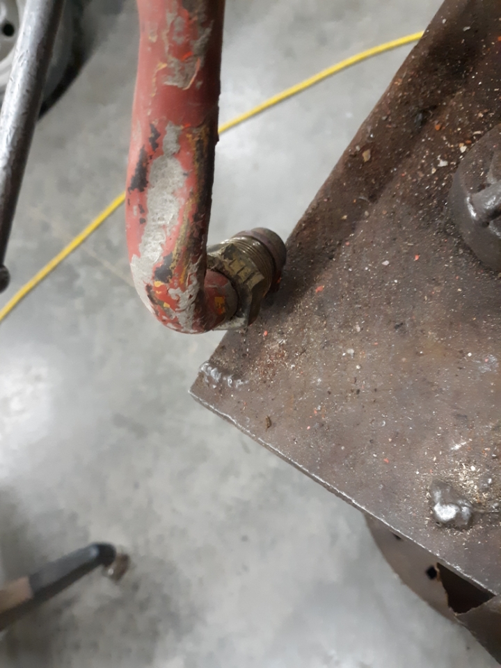

One thing I dislike about draining coolant is it can be such a messy process. I found a bit of copper tubing that I cut to fit the drain valve and routed to a bucket below.
Or maybe you guys already figured this out.
I was surprised how clean this coolant looked.
I also fabbed one to drain 7XXX's

That is a neat idea! thanks! Now to remember it!

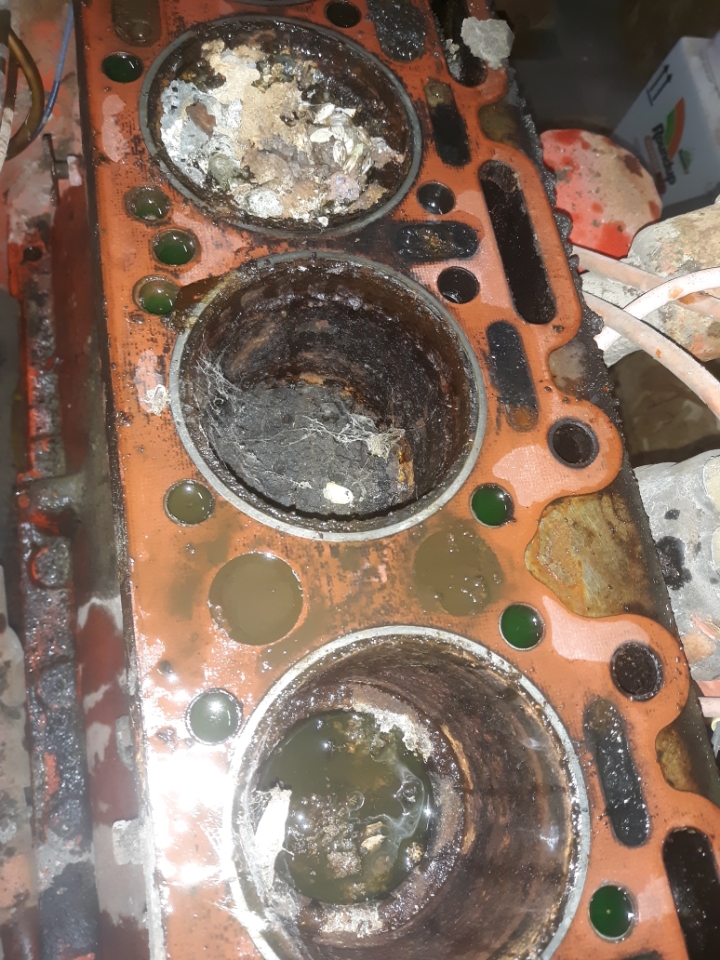

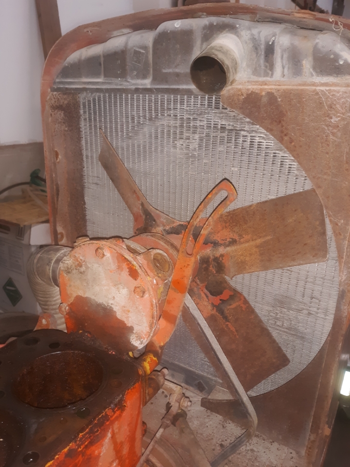

Teardown begins. Started with the head to assess cylinders.
Not good. But had little hope. Some of it is my fault as I had the plugs out for some time. Was pouring lubricants in there hoping to loosen this stuck engine. No luck. It was smoking pretty good last it ran so figured sleeves would need replacement.
Someone cut the fan shroud so I will need to repair that.

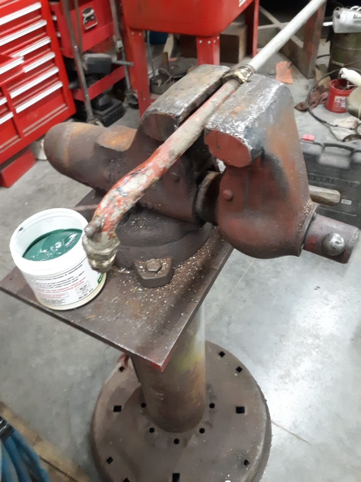

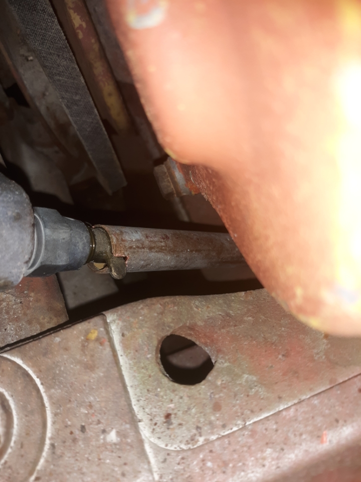

There's a big dent in the bypass tube for the cooling system.
I'll just put it in the vise and tap a ⅝ rod through and push the dent out.
Ok what just happened?
That's not the rod.
Please tell me this is not someone's diabolical plan to restrict flow in the bypass. Unless someone has one, I guess I will try to braze this shut.
Points: 8734
Post Options Post Options   Thanks (0) Thanks(0)   Quote SteveM C/IL Quote  Post ReplyReply Direct Link To This Post Posted: 07 Mar 2021 at 8:16pm
Maybe who ever flattened the tube stuck that in there to keep from total crush?....but had it lodged and couldn't remove it?

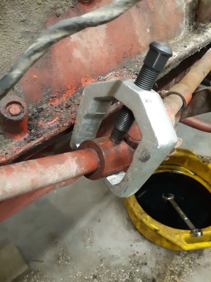

Yeah, I don't know maybe. Would there be need to restrict flow there?. Anyway time to the rails and steering off to remove engine. I cut and drilled some 3" channel to support the torque tube once the rails are off. Had a devil of a time separating the frame from the steering box. I used pry bar at the end w/ pressure as I tapped(well, hammered) on the rail to get them apart. In hindsight maybe a large cold chisel would have been better as a wedge? Now to the steering shaft u-joint.

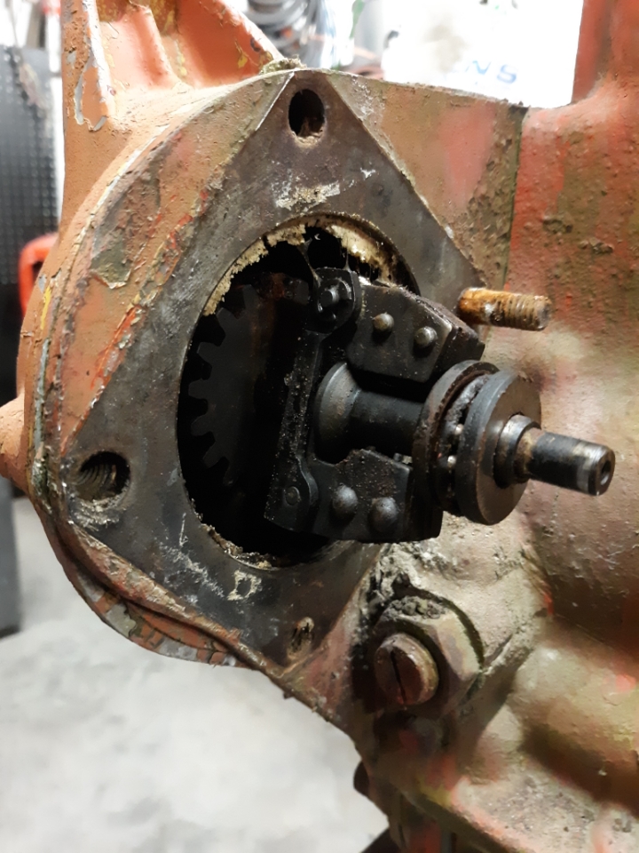

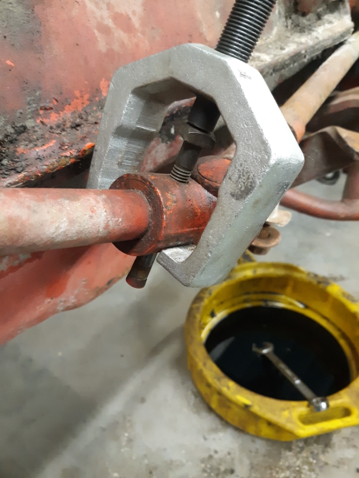

I could not steer this thing at all and figured moisture had gotten to the gear box.
Much easier to get to shaft pin. It's a solid pin not a roll pin and stuck good. Using a separator tool to drive out the with a series of nuts and bolts as drive pins.
Turns the gear box works fine. The u-joint is seized up. There is no grease zerk in it or the shaft support bushing.

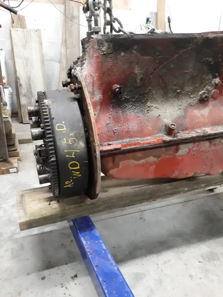

Engine out. Flywheel from a WD45D.

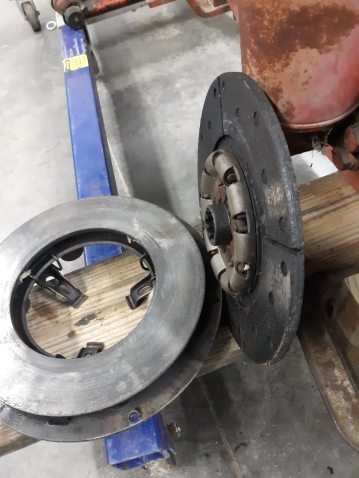

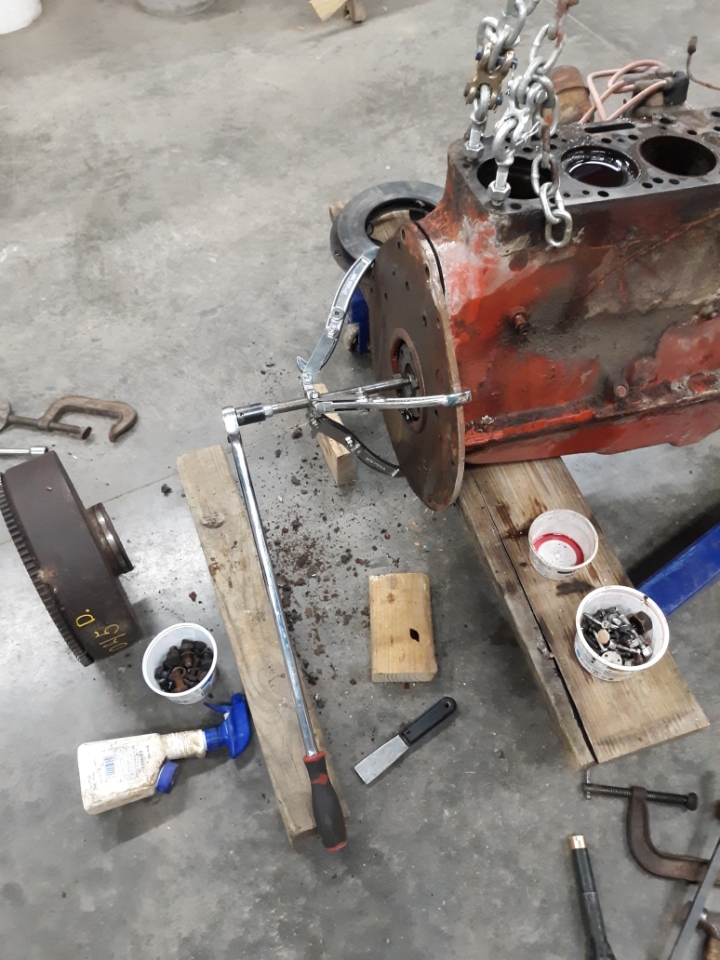

Cutch apart. I see stress cracks in the pressure plate and although there seems to be plenty of material on the clutch disc, I think it is saturated with oil. Way back when I was trying to pull start it I could tell the clutch was slipping. I know the rear seals were leaking cuz it was dripping out the inspection hole back when I was rolling it inside.
Needed a 3 jaw puller to remove plate from back engine
That flywheel is HEAVY!!

Send that PP & clutch assy off to Rick. He'll take care of that puppy!

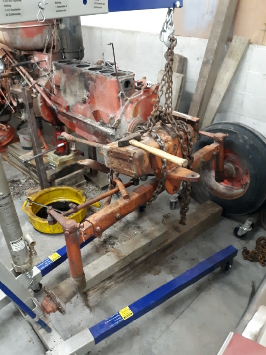

Everything needs attention yes. The price you pay for wear and tear and then leave it sit so long

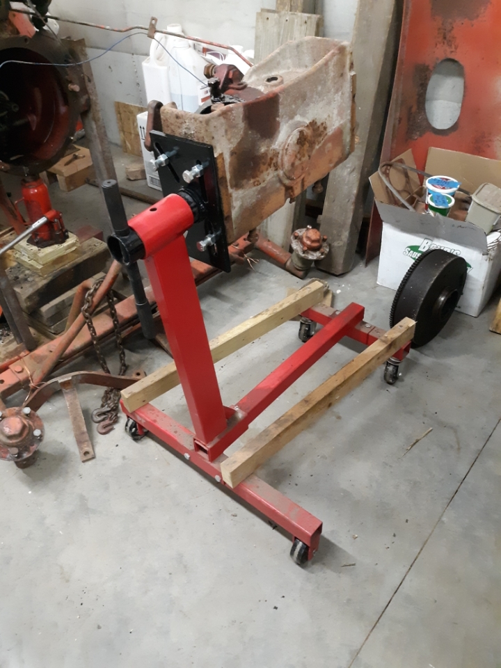

I thought it might be a good idea to hang the steering box on a stand.

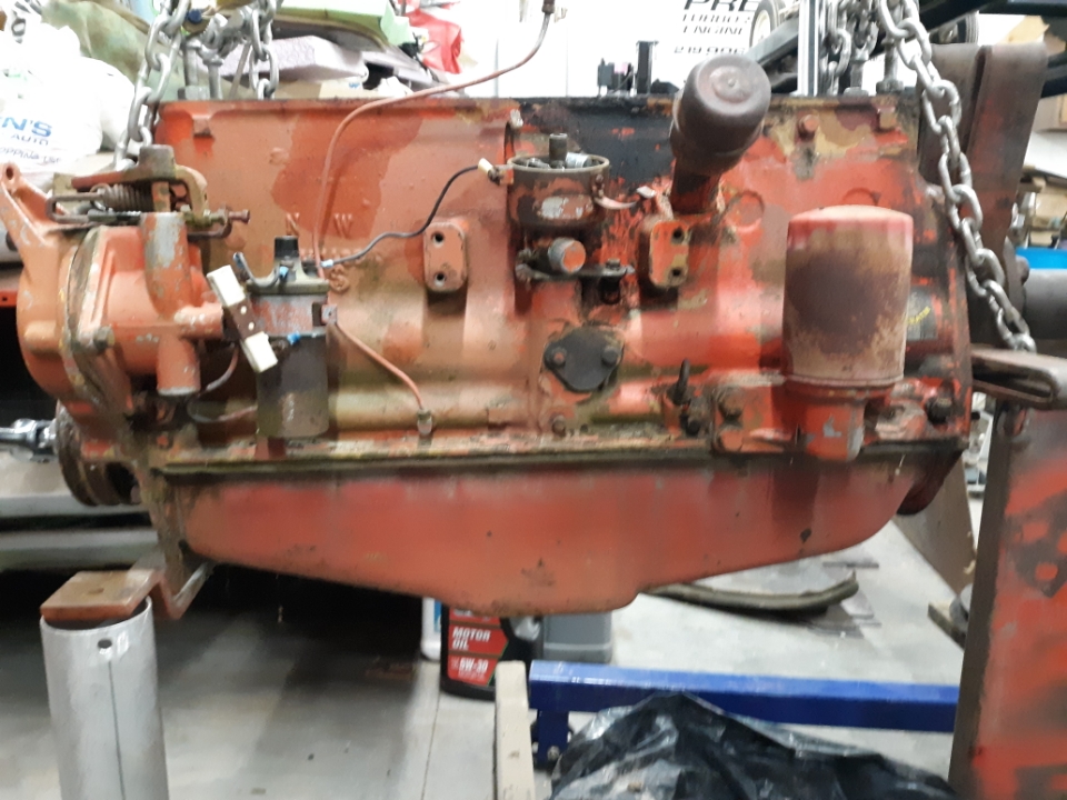

Engine on Dad's home built stand
Taking lots of pictures for reference later

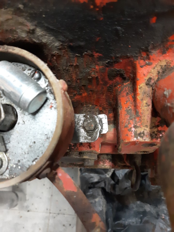

Interesting timing mark. Unique to this engine? I do have a service manual

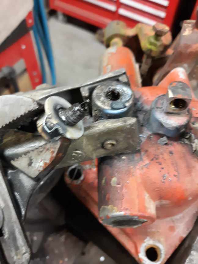

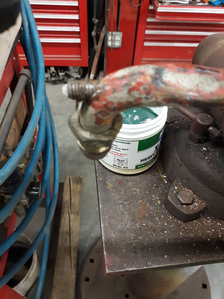

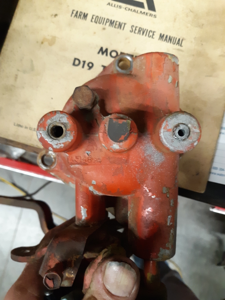

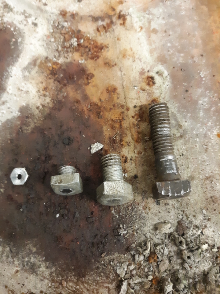

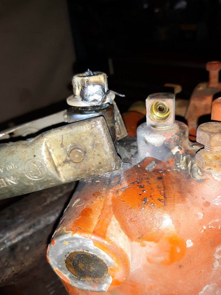

The ignition coil bracket is bolted the aluminum governor cover and yes a bolt broke off in the cover. Removed the cover to get to governor and it is crusty.
Looks like a cage bearing will need a close look.
I held a nut over the broken bolt and used a transfer puch try center punching the bolt. Reasonably to drill and use an easy out. The easy out was a fail so I welded a washer and nut to it.
That process has worked several times for me. But I was concerned initially because I didn't want to hurt the aluminum.

Have tried many ways of removing broken bolts but never thought of welding a washer to the broken bolt then a nut to the challenge or using a nut to help find the center to punch a starting point through. Goes to show you are never to old or experienced to learn something new. Thanks for the tips, good luck with the project and keep the pictures coming.
