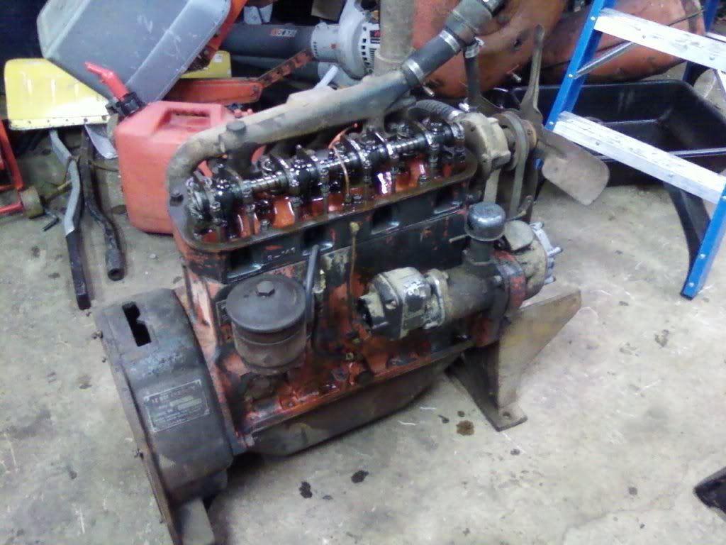

I accidently stumbled on the long lost carb for my d201 this morning, and it inspired me to get some more work done on the engine. I finished the bottom end and got it off the engine stand. All thats left to do is double check my mag, put the valve cover on and a flywheel/starter and i should be able to see if it will make smoke. Then the "plan" is to put it in the wc so i can dyno it, and then back in the chopper. This project has been going on longer than i'd like to admit and it feels good to see the light at the end of the tunnel.

You're a little bit farther along than I am with my 262 diesel. Just found out tonight that four of my ARP head studs are about an inch too short. Soon as I get the correct ones I can put the rockers on and bolt it back in the tractor. It got pulled apart a year ago in Sept.

Originally posted by powertech84 powertech84 wrote:
Dont care about the 226. My leroi engine is a 201, no fancy canted rods.
Hey Powertech.
Does your Leroi 201 have a plate on the right side like a WD 201 engine does?
deereequipment1 View Drop Down
Joined: 31 Mar 2011
Location: Southern MD
Points: 261
Post Options Post Options   Thanks (0) Thanks(0)   Quote deereequipment1 Quote  Post ReplyReply Direct Link To This Post Posted: 25 Apr 2011 at 8:05pm
Hey Powertech.
Joined: 31 Mar 2011
Points: 261
Post Options Post Options   Thanks (0) Thanks(0)   Quote deereequipment1 Quote  Post ReplyReply Direct Link To This Post Posted: 25 Apr 2011 at 8:14pm
YES YES YES>
thanks you Powertech.
The photos are great!
I have this same engine in a WD45 that I just bought.
It has the same coolant manifold, with no thermostat in it.
It has the same oil filter housing.
It has the same little plate underneath the oil filter housing.
It has the shorter head on it, as a WD 201 engine would, and I was thinking I had a WD45 engine, with a WD head, because I didn't have the big plate on the side of the engine that the WD had.
Now I know I have a D201 Leroi!
Thank you!
