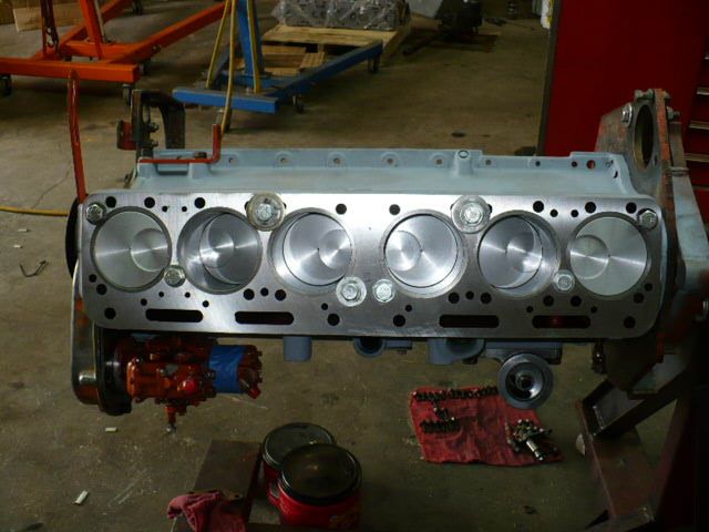

I hope she gives you years of trouble free service! This rebuild was a little tough to do with none of the newer D-19 pistons with the valve relieve out there to be found, so we did the next best thing, milled the set of older ser # NOS D-19 pistons he had in-stock to work with the newer head/camshaft, then decked the block and re-cut the counter bores.
I think it turned out fine.

This how the inside looked as it was built, note the piston tops and you can see the mill work done to them.
