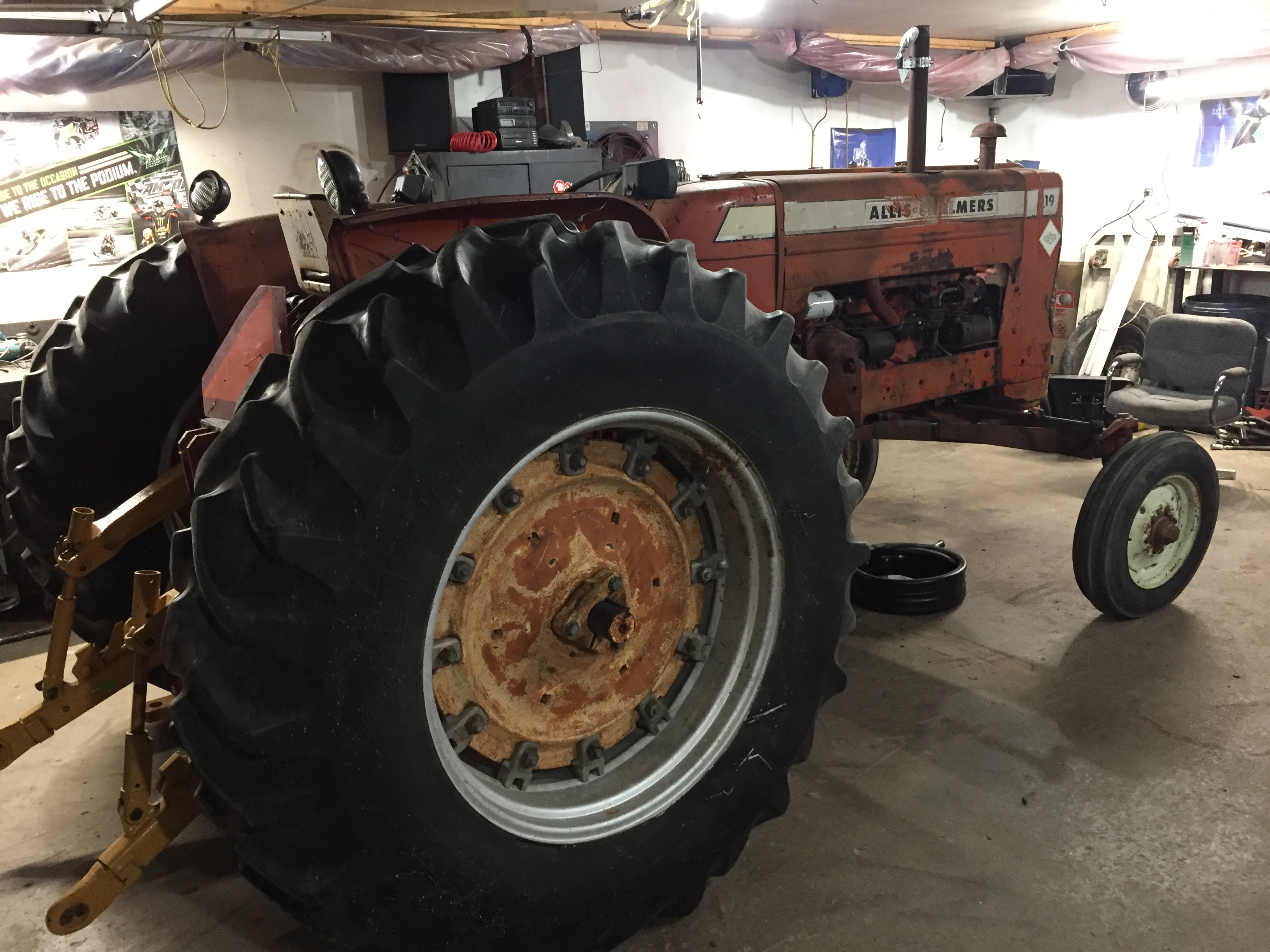

Can anyone give me an educated guess what this early D19 gas tractor would weigh. It has 18.4-34 tires with cast centres, and a 3ph off of a 190, I think. I would like to pull in the 6500 lb class on thurs night. It is serial # 1041.

It would be close without calcium.

Per 'Tractor Data' web site
6650 to 11,210 pounds.

Brian you'll be close mine is 5500 with no hydrolics no snap couple and a real light front end with cast CT wheels and no water

Ok thanks guys. I seen the tractor data, but was unsure if that was with 3 point or snap coupler. I will be looking for a narrow front for this tractor. Preferably in Ontario. Also do the make a hub that you can bolt a 38" rim to. I would like to put 18.4-38 on it.

We pull 6500 with a narrow front diesel but nothing else taken off. I would guess youll be over weight.

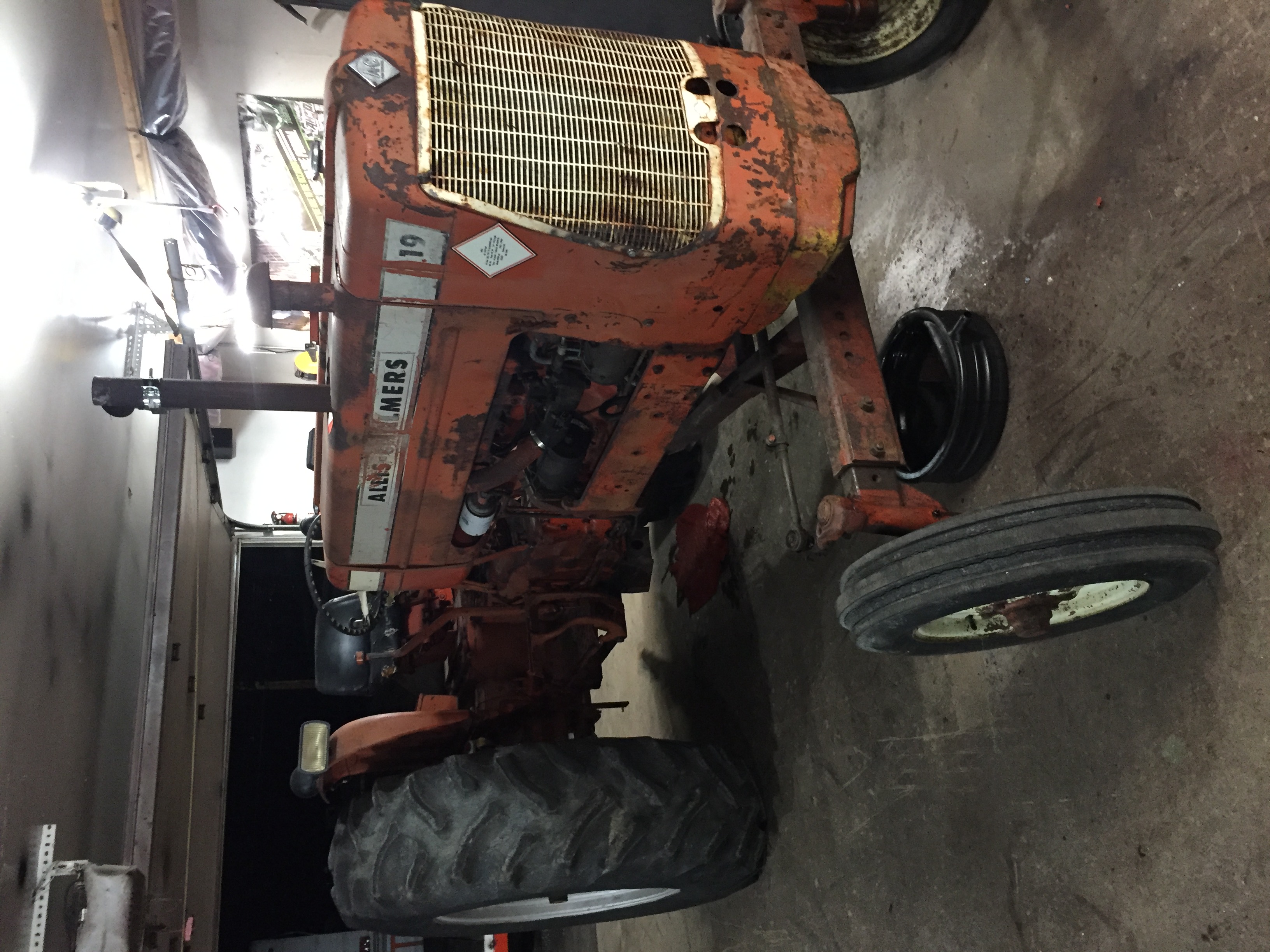

Looks like one of the Nesbitt tractors!
