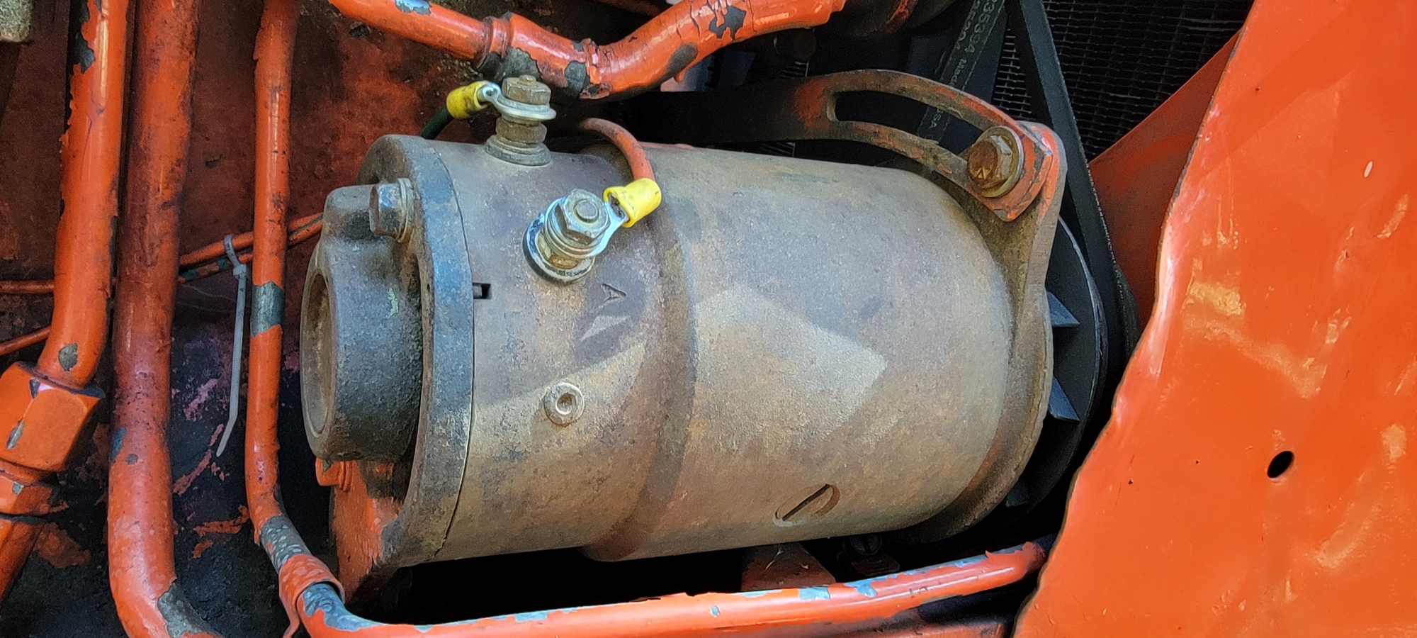

It seems that this is getting better by moment. Here is what we discovered today.
The battery is grounded on the negative side. However it appears that the original generator is still installed. And it appears that that coil that we blew was wired backwards. Meaning, the feed that comes from the ignition switch is attached to the positive side of the coil.
It "looks" like some one tried to convert this tractor to negative ground. Is that even possible while keeping the original generator installed?
I'll post a pic of the generator, or at least what I assume is the generator. I dunno if they make alternators that look like generators or not, but it sure looks like an old generator.
Edited by WIAllisFan - 30 Sep 2021 at 12:23pm

Post Options Post Options   Thanks (0) Thanks(0)   Quote Alberta Phil Quote  Post ReplyReply Direct Link To This Post Posted: 30 Sep 2021 at 12:29pm
That's a generator.  It will work with negative or positive ground.  Just have to polarize it correctly  by briefly jumping a wire from the battery terminal to the armature terminal on the regulator.  If everything is in working order, it should show a charge when running.

Post Options Post Options   Thanks (0) Thanks(0)   Quote WIAllisFan Quote  Post ReplyReply Direct Link To This Post Posted: 30 Sep 2021 at 1:09pm
Excellent! Thanks Phil!
I see some "how to guides" recommending I remove the belt and have the tractor running when I polarize the generator. Is that necessary?
I think I see why converting to alternators is so popular, it seems to be more simple.
Alberta Phil View Drop Down
Location: Alberta, Canada
Points: 3985
Post Options Post Options   Thanks (0) Thanks(0)   Quote Alberta Phil Quote  Post ReplyReply Direct Link To This Post Posted: 30 Sep 2021 at 7:41pm
I've always done it with the tractor shut off and everything in place.  I have nine Allis tractors here with 6 volt systems, all with generators and I very seldom ever have any electrical issues with any of them.  They will all start any time I need them.  I've had two generators rebuilt over the years, but they were non functional when I bought the tractors.
