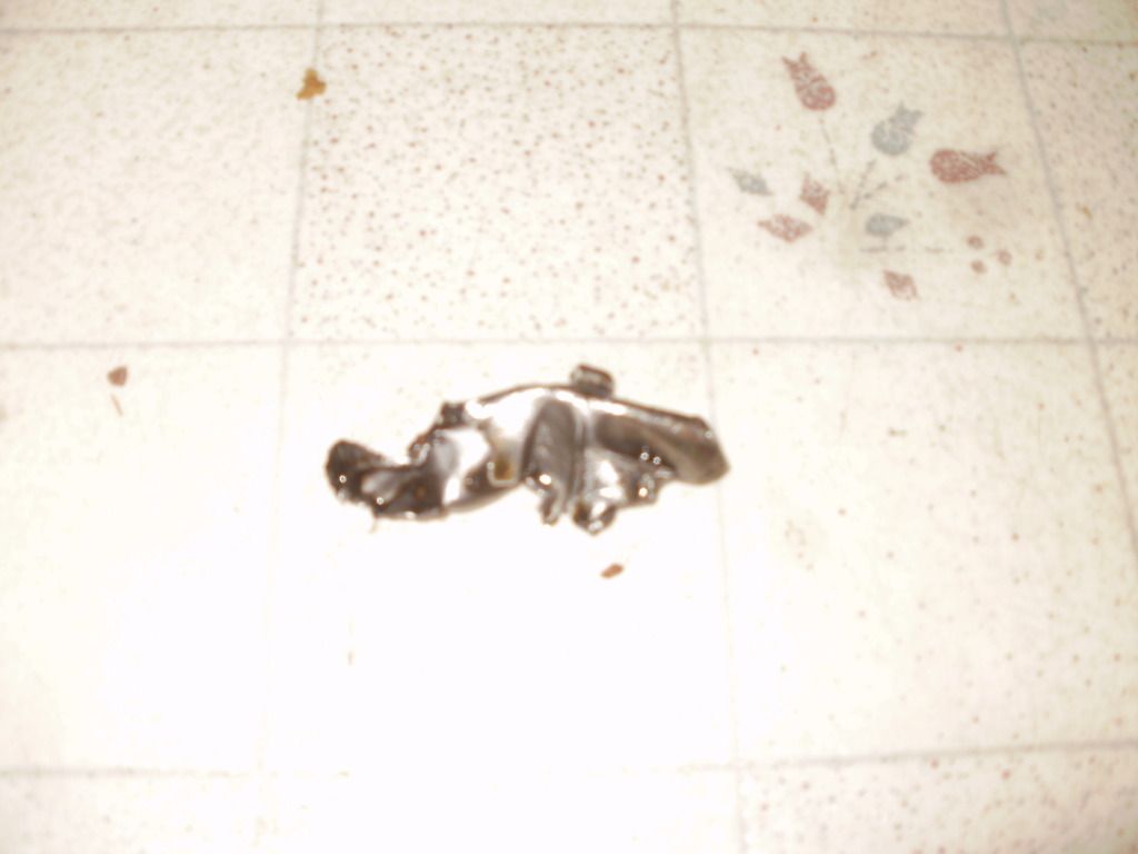

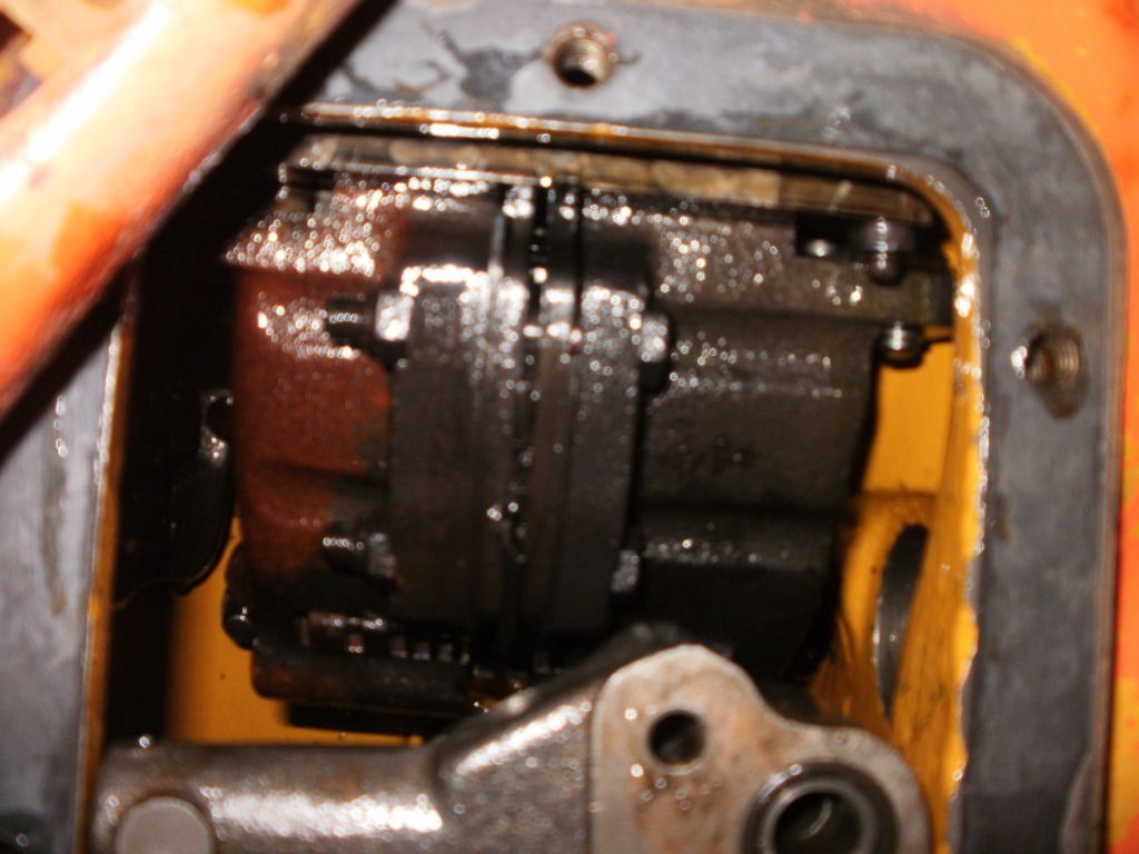

Here are some pictures. This is one of the clutch links that still has that piece of metal on it. The other two that piece of metal is ripped off and in the bottom of the housing. What would cause this piece to rip off?
![]() Here is one of the pieces I pulled out of the bottom. ![]() Here is a picture of the shims, although not a great picture. Hopefully you can see how chewed up things are. ![]() How hard is it to split the tractor to get full access to the power director? Things are looking like it might end up that route. I will be doing alot of reading of the manuals before bed.

Not to hard to split but becarfull reassembling there is a needle bearing in the clutch shaft that you do not want to damage As for the tins they are just oil slinngers to help reduce the power needed to rotate the PD in the oil It seems to me that D19s are more prone than others for having water in that compartment and if it was started will cold out there could have been ice chuncks i have seen 3 D19s with brooken hyd return lines due to beeing full of water then freezing

Makes sense Jesse, and this D19 has the cap missing off of the top of the dipstick where the breather material is so I'm sure at one time, water got in there. Hopefully I can clean things out and adjust some shims and be good, but I think I will be more into it then that by the time I'm done.

After you get the tractor split and have
the power director clutch apart, there is one critical thing to note. When you reassemble the power director, the total of all three shim packs must be the correct thickness. Then, if you need to remove, say, a .015 shim from the low range clutch, you need to add a long .015 shim to the middle to maintain the exact dimension of the complete power director assembly. Hope this makes sense. The service manual will give you the dimensions of the shim packs for each location. |

Well, I had time to take a better look at things before our club meeting and the center shims that were added are all short shims, so at a minimum those will have to be replaced as well as whatever I will need to take out of each side to get back to spec. The rollers do all look ok from what I can see from the inspection hole. I am going to try and see if I can measure and adjust it properly by adding shims to the center, but if not, I think I may have a line on a good used one.
