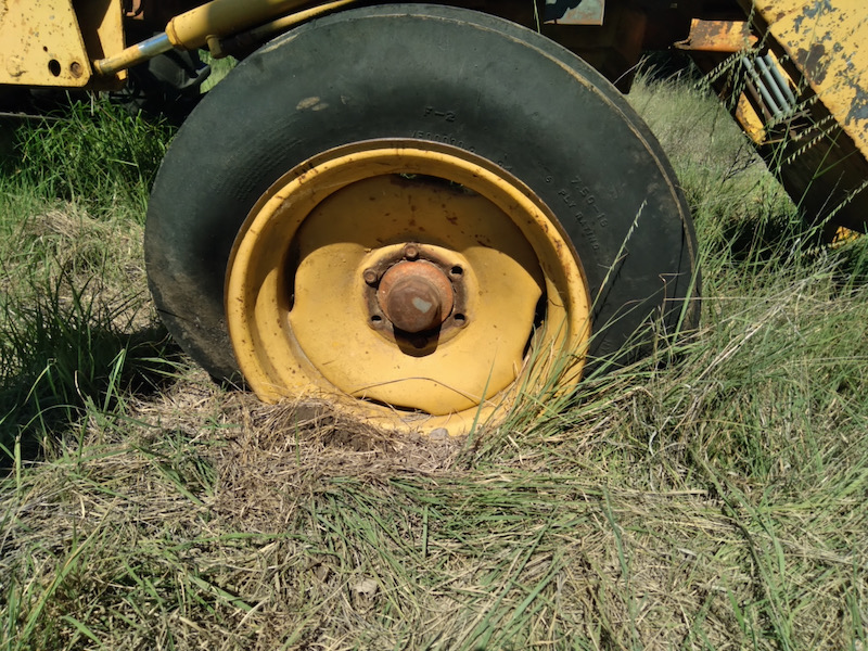

Someone put front wheels from something else on the front of my D-19. They're 18" instead of 16" and it looks like they had to torch the wheel centers to fit over the hubs.
I'd like to put correct 16" wheels and tires back on it, unless I'm really better off with the 18" for higher load rating for loader use. I would need new tubes and one new tire if I were to try to reuse the 18" rims, so not much cost difference from getting the correct 16" stuff.
The loader is an IH 2000 and has approximately a 2000 lbs. lift capacity. Carlisle 6.50-16s have a 1250 lbs. load rating, so 2500 lbs. total between the pair for the weight of the front of the tractor and loader plus the load. Might be a little light. If they have enough clearance, Carlisle 7.50-16 tires have a 1710 lbs. rating which would give me 3420 lbs. as well. Anyone with a D-19 or similar model with a loader have any insight? Wish you had something different for front tires, or what has worked for you?

I'm wondering if I can stick with the stock 16" rims by going up to a 7.50-16 SL F2 (8 ply) which gives a 1710 lbs. rating, not much less than the 9.5L-15 SL 8 ply which is 1870 lbs. I think I'd feel pretty good about being rated for 3420 lbs. under the front end as long as there's enough clearance.
Does everyone feel that the stock D-19 front rims (not implement rims) were strong enough (thanks Lon - in case I go that route)?
