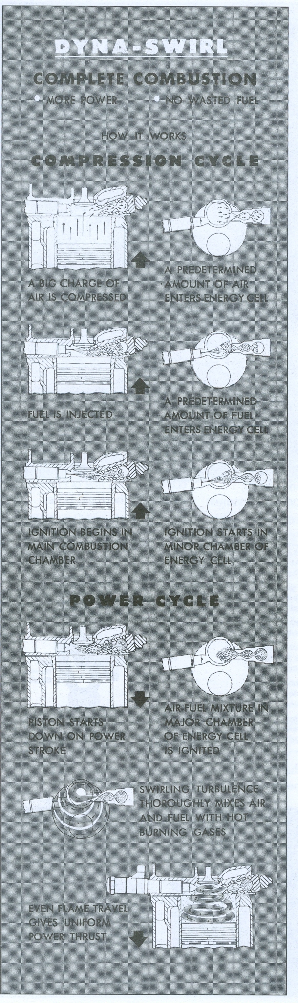

Since the Lanova system is being discussed here I can post a picture we took of the cut-away WD45 diesel head and air-cell with an injector firing.  The main portion of the fuel pulse is directed into the air-cell. Since the stream flows across the combustion chamber in the head some of the outer mist from the injector misses the air-cell hole and ignites there. The piston is still on its way up during the injection pulse so the beginning of the flame in the combustion chamber enters the air-cell igniting the fuel there. All that exploding pressure is metered out through the orifice of the air-cell. You can see that the WD45 air-cell has two spherical chambers with metered orifices, not sure if the D19 air-cells are the same. I put together what information I could find on the Lanova system back in 2006 when I was working on mine.  Here is a link to that:
http://www.allis01.com/fossto/Lanova_System.html

Post Options Post Options   Thanks (0) Thanks(0)   Quote TomMN Quote  Post ReplyReply Direct Link To This Post Posted: 21 Apr 2016 at 11:44am
One more fun picture of the Lanova cycle.
Tom that's a nice cut away and tells the story way better that I can, good job. Thanks for posting it.
