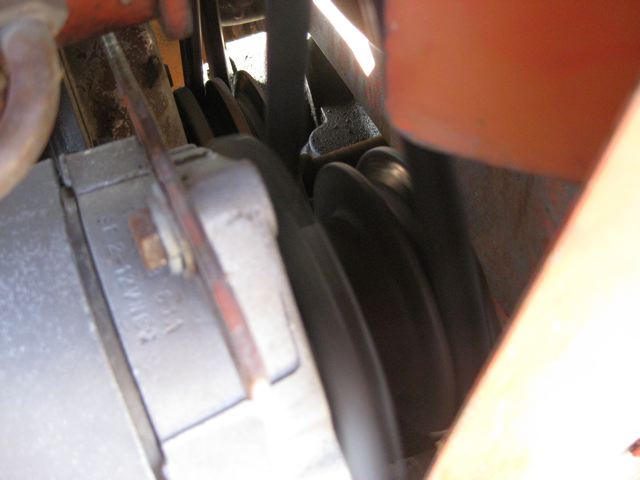

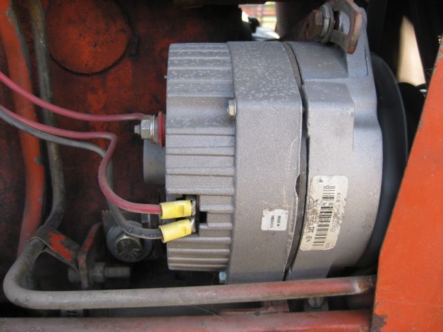

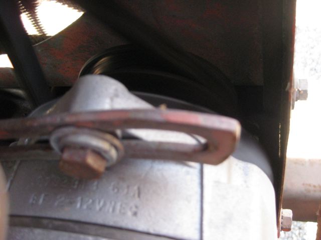

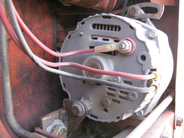

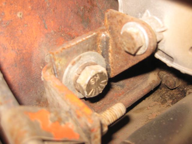

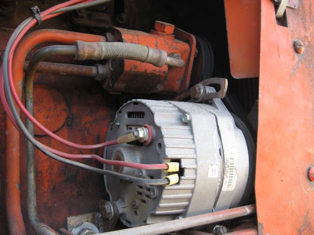

Heres some pictures.  Hope this helps you.  Brad

Thanks for the pics!
Looks like that generator bottom mount is different from any of the others I've dealt with.

That 7071 3 o'clock version fits in there just right. Its pint size "CS-130" cousin would give you more room in tight quarters like that, but that "SI" seems to fit with a little room to spare. Nice job Brad. Looks great! 3 wire which is what you want on a Tractor, and a nice simple mounting bracket to. Lookin' good!
