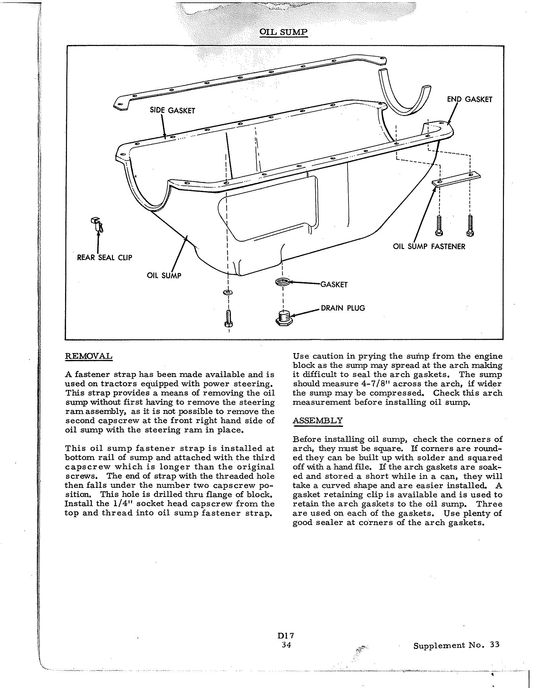

If the tractor is a gas and has power steering the right hand side rail of the pan is above the steering ram. From the factory AC had a one allen head screw that came in from the top for the one cap screw that is completely hidden by the steering cylinder. Even if it has the allen screw, the lip of the pan is hard to get out from above the cylinder. Also, if it has ever been apart, it may of been changed over to a regular cap screw inserted from the bottom. I was taught by a long time AC mechanic that it is easier/faster just to pull the front end to remove the pan.

Yep...that's the reason it's easier to slide the front pedistal back to get the oil pan off...the power steering ram/cylinder is in the way. If it don't have power steering,then the oil pan comes off easily.  Rick

Post Options Post Options   Thanks (0) Thanks(0)   Quote roscoe Quote  Post ReplyReply Direct Link To This Post Posted: 15 Mar 2012 at 7:08am
I just happend to have my service manual open to that section, because I need to replace the governor weights and gear. (different story)
Anyway, the service manual says:
