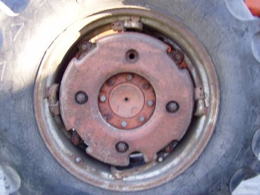

Does anyone know if the wheel hub size for a D17 and a 180 are the same? I do not know what series the D17 is. I'm looking at a set of rear weights (one piece) online that are supposedly from a D17. Brian Ahart's website seems to suggest the sectional pie weights work for both the D17 III & IV and 180, among others: http://www.brianahart.net/weights.htm
But I don't see anything regarding one-piece weights
The owner indicated the hub diameter at 28". My father measured our 180 at 26" but one or the other measurement might be flawed.
Any advice appreciated!!

The short answer is yes they will work if both have the factory 28" tires. The "correct" weights will differ but they will fit. I have section weights on my series one D17. WD45 weights will work also.

Most all weights will work, but if is the weight you have pictured they, will not work because that is the early hubs and the track bolder on nearer hubs will not work.
