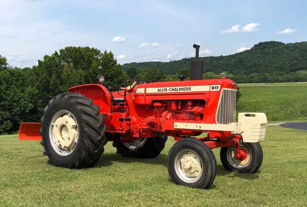

uploads/1181/2-D17_Series_IV.jpg
This is the Series IV that has been in my family since new. I've had many D-Series tractors, but this one is definitely my favorite.
