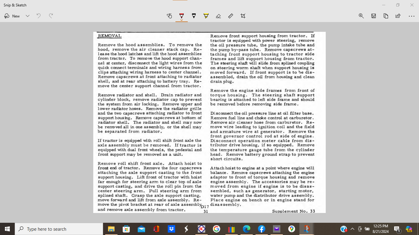

Post Options Post Options   Thanks (0) Thanks(0)   Quote WF owner Quote  Post ReplyReply Direct Link To This Post Posted: 21 Aug 2024 at 11:29am
WF owner View Drop Down
Joined: 12 May 2013
Location: Bombay NY
Points: 5180
Post Options Post Options   Thanks (0) Thanks(0)   Quote WF owner Quote  Post ReplyReply Direct Link To This Post Posted: 21 Aug 2024 at 11:34am
You need to get a real Allis Chalmers Service Manual. I prefer the online versions that I get instantly (after buying them). I print out the pages that I need and I don't worry about getting the pages dirty because I can always reprint them.
You should be able to easily pull the engine in less than 8 hours. Of course, it always seems like something will give you trouble that you least expect.
