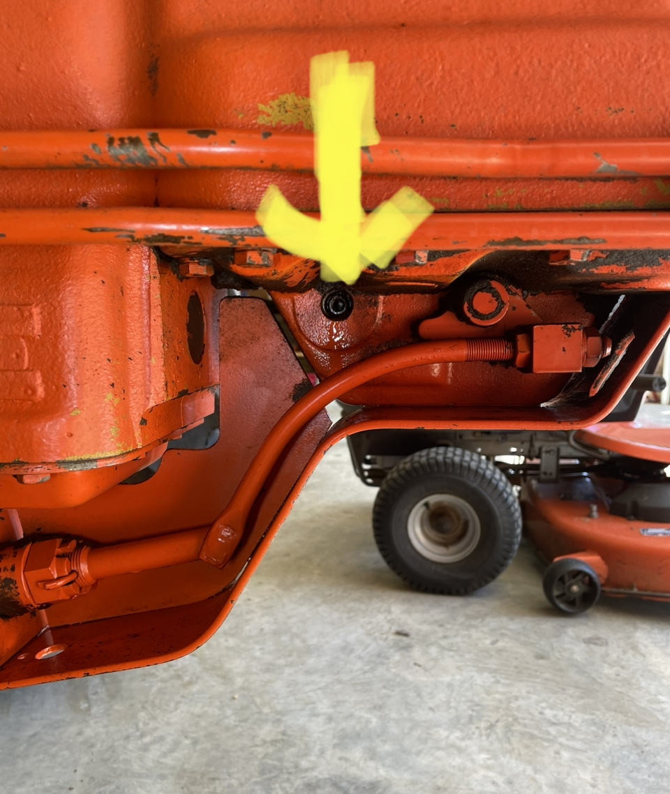

I have a leak and I am trying to upload a picture to see if someone can help me identify how to fix this issue.

Can someone please tell me how I can upload an image?  So much easier than trying to explain where the leak is coming from.

Missing drive-in plug. Shaped like a disc blade.

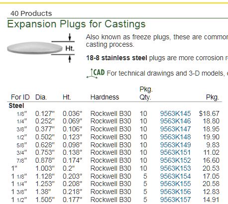

McMaster Carr catalog.... size chart..

I am looking at that pic and it looks like an Allen head plug in the middle of it. Am I seeing it wrong? Right under the yellow tape at leak.
