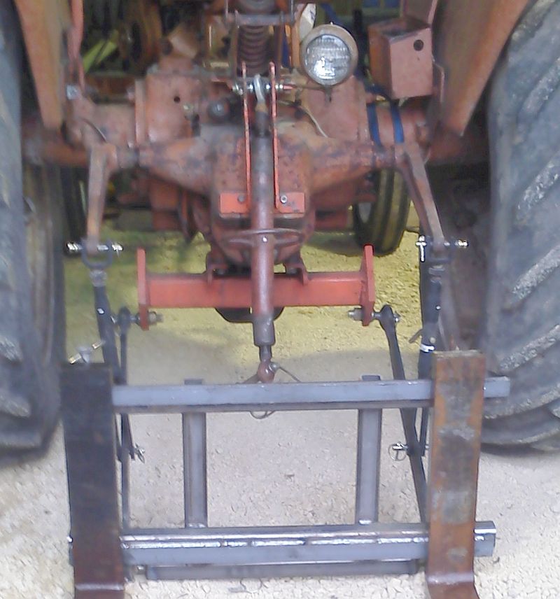

So I have been looking at and researching the 3 pt hitches on Series II, which also brings up the series' III & IV.
I've got it pretty well figured out, just have a bracket under the floorboards and a pin on the inside of the brakes/under the axle that have me curious as to their purpose and whether or not I could/should incorporate them into my 3 point setup?
I know buying one would be easier, but my Dad is a welder by trade, and uber excited about the idea of us working I it together. Anywho, here are the pics.
This is one of the brackets under the floorboard. Looks like it may be for a belly attachment, but I didn't think Series II were set up that way? Which I very well could be, and likely am, dead wrong.
[/IMG]
This is the pin that I'm just curious about. The PO is digging up the manual for me soon.
[/IMG]
Sorry for the size of the pics, I tried to make em smaller. Thanks again in advance!

Post Options Post Options   Thanks (0) Thanks(0)   Quote Alex (wi) Quote  Post ReplyReply Direct Link To This Post Posted: 07 Feb 2015 at 11:13pm
D17SeriesIV,
Is the top picture of your tractor? If so, it looks like your D17 was set up with an aftermarket three point at one time. It looks like the only thing you are missing is the lift arms? it's kinda hard to tell, but you might be pretty close by just going down to your local farm store and get the lift arms.  Your set up looks similar to what is on my Series III D17.  Otherwise, your best bet is going to be finding any holes that are already cast into the rearend housing, and building your frame from there.  It looks like the hitch you have is a good start.
~Alex

We had a D17 in the early 60's that had that piece on it in the first picture. It came with a mounted AC mower. Can not recall the model number , maybe it was 72. It was a snap coupler mower, but needed a third point to hook to.

Post Options Post Options   Thanks (0) Thanks(0)   Quote DaveKamp Quote  Post ReplyReply Direct Link To This Post Posted: 08 Feb 2015 at 10:00am
http://www.allischalmers.com/forum/uploads/2752/D17_3_point.jpg
Look at mine. You have everything but lower lift arms.
There are lift arms that were made to clip right into the snap-coupler... looks like a big wishbone.
I made mine by using aftermarket lift arms from the farm store, and just welded up a bracket to hold the tractor-end of the arms.
You already have the top-link bracket, you'll need a top-link and pins from the farm store, but you're 90% done...

I'd suggest you look at a conversion for the D-17 made by Cross Mfg. Yes you could certainly design and build your own 3 point conversion lift arms, however there is a lot of geometry to try and figure out. The pivot points for the lower arms as well as the upper link all need to work together correctly or your implements will lift at strange and unworkable angles and even bind up, lock and not work at all. Trust me it's a lot easier to buy a tried and true, well engineered conversion than to try and make a homemade conversion work properly. While it may not be rocket science, getting the pivot points in the wrong place or the arms too long or short, will be an adventure in frustration that will have you thinking about the economics of buying well engineered parts.

Post Options Post Options   Thanks (0) Thanks(0)   Quote DaveKamp Quote  Post ReplyReply Direct Link To This Post Posted: 08 Feb 2015 at 4:16pm
Originally posted by John (MO) John (MO) wrote:
... there is a lot of geometry to try and figure out. The pivot points for the lower arms as well as the upper link all need to work together correctly or your implements will lift at strange and unworkable angles and even bind up, lock and not work at all. Trust me it's a lot easier to buy a tried and true, well engineered conversion than to try and make a homemade conversion work properly.
Apparently it's easier for some to figure out the geometry and build, than others. It's certainly easier for some to throw money at a problem, than it is to posses conviction, and exercise skills on their own behest.
Here's my local farm supply store:
http://www.farmandfleet.com/farm-livestock/equipment-parts/tractor-parts/3-point-hitch-supplies/
He needs two generic lift arms, $40 each. Two pins @ $5 each, one adjustable lift link, $26, one top link, $27, and some snap pins. $150, or you might already have 'em lying around from another tractor.
The bracket underneath certainly ain't rocket science. Cut the tube and plates to space the arms out about 24", and put their front pivots about 10" in front of the back edge of the PTO shaft, and about 12" down from it. In this vicinity, the drawbar will still slip in and use the snap lock, making the traction-booster functional.

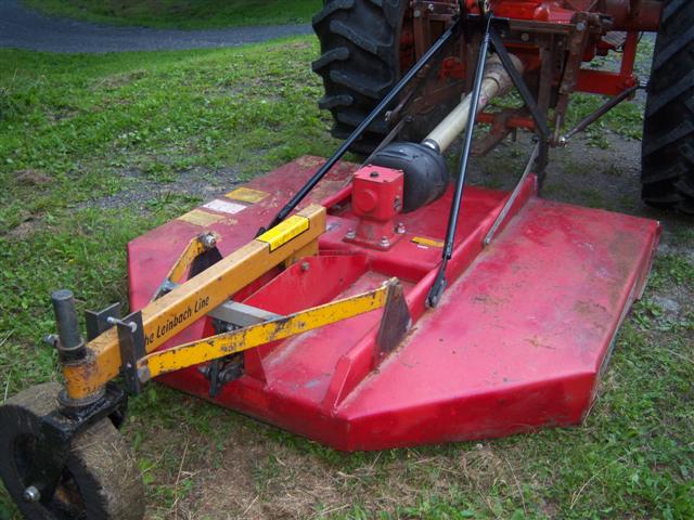

My D-17 came with a home-built 3 PH adapter.
Not the greatest but the anti sway system using those adjustable arms works really well on heavy equipment like a Bush Hog.

If you're expecting any of the 3pt adapters to work like a 3pt hitch on a tractor that
came with a factory 3pt you'll be disappointed.

Sway blocks are something most aftermarket 3pt hitches don't have and are real important on a 3pt.       MACK

My Saginaw 3 point has an outstanding anti sway system, problem is, they quit making them.  If you can find one it is your best choice.  I should probably get a pic or 2 of it for these kind of questions.
