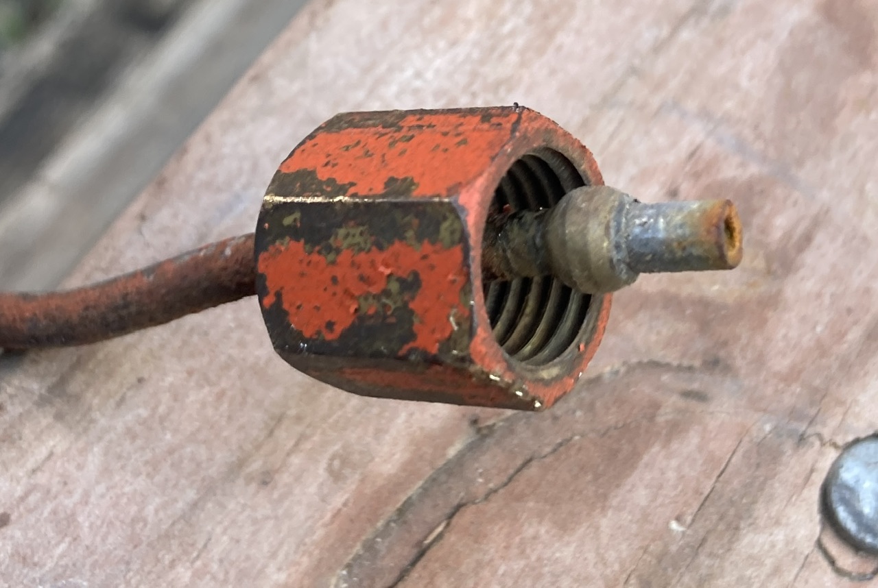

Previous owner disconnected the traction booster gauge and then pinched off the hydraulic oil line right after the square 90 where it taps into the hydraulic system.  The hydraulic line that was pinched off is 1/8" steel tubing the traction booster side uses 1/4" tubing.  I am needing help with figuring out the transition from 1/8" steel tubing to 1/4" steel tubing? Also can't find a source for 1/8" steel tubing?

Post Options Post Options   Thanks (0) Thanks(0)   Quote RedHeeler79 Quote  Post ReplyReply Direct Link To This Post Posted: 26 Mar 2025 at 4:29pm
Appears that the guage end is just a compression style fitting with a brass ferrule and the larger nut. The opposite end is a double flared connection like a brake line.
