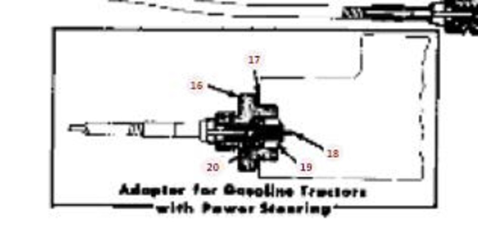

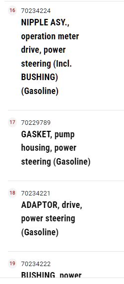

from the AGCO Parts book.... if i am looking at the right thing, it looks like you remove the PLUG and install a NIPPLE ( #16) that is a plug/ threaded nipple combination... i dont see that part number anywhere on a Google Search..

That’s what I was looking at and now that I’m rereading it, it says, “bushing included” so that must mean that the nipple I bought from djs is just the nipple and doesn’t include the bushing. I guess that a trip to the hardware store might yield a reducer bushing but I am pretty sure most stuff they would sell is NPT, and not NPS, which is probably what it would be since its got a copper crush washer behind it, like an oil drain plug. So I guess I can just take the nipple and the hex plug to the hardware store and see if I can match something up. Seems like I should be able to do that. With my luck, it won’t work, but I will try that first. It’s a pretty good sized plug. I don’t recall seeing anything like that on the shelves before. Maybe if I order it from agco I will get the bushing also.

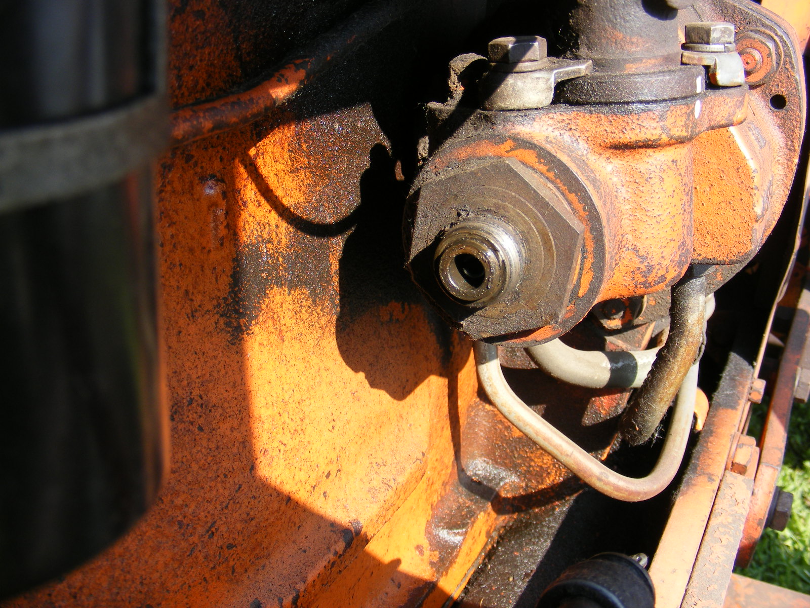

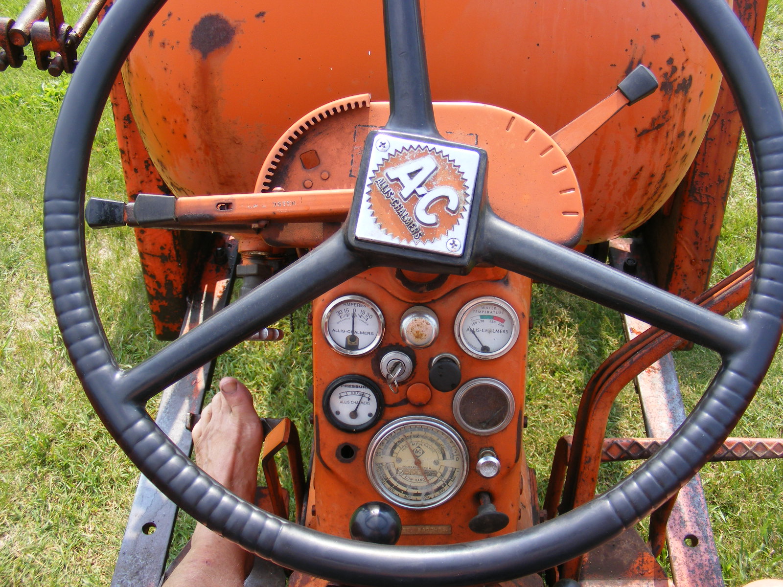

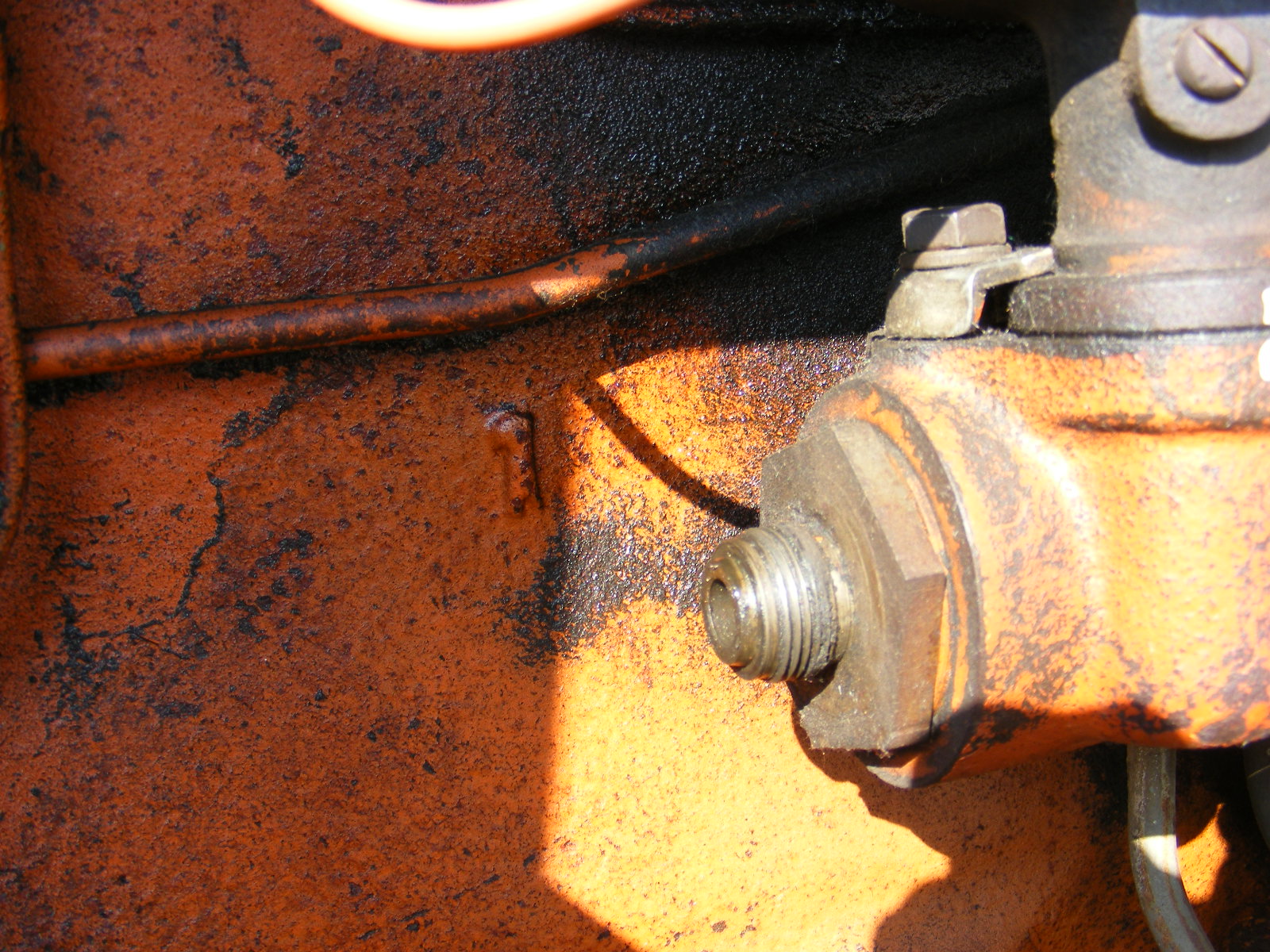

Here are some pics of my early D17 tach drive.  This tractor has the factory power steering.
Edited by Alberta Phil - 08 Jul 2023 at 10:48am

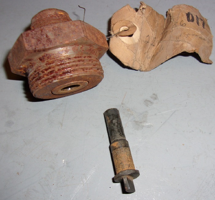

Post Options Post Options   Thanks (0) Thanks(0)   Quote Alberta Phil Quote  Post ReplyReply Direct Link To This Post Posted: 08 Jul 2023 at 10:46am

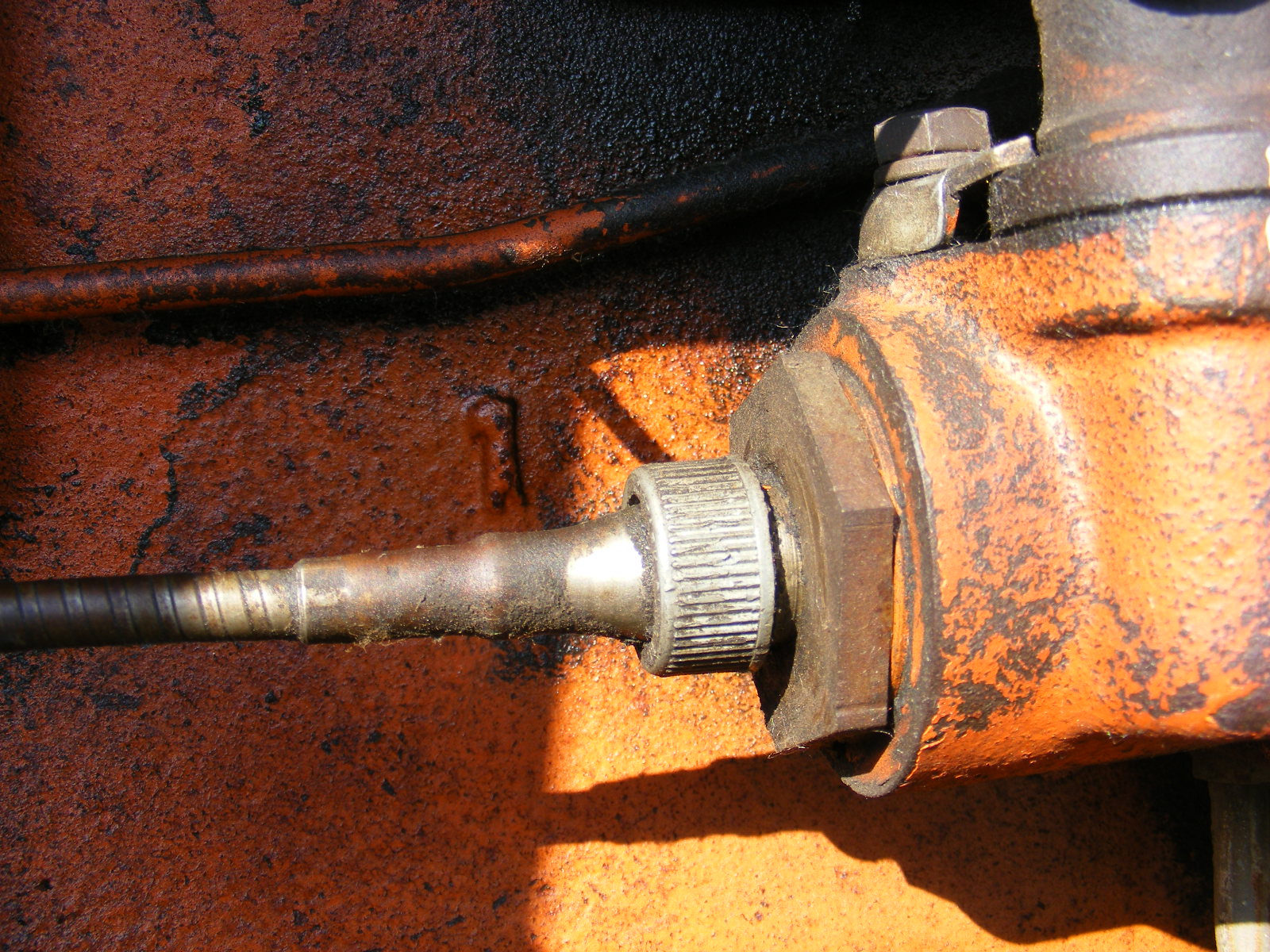

Post Options Post Options   Thanks (0) Thanks(0)   Quote Alberta Phil Quote  Post ReplyReply Direct Link To This Post Posted: 08 Jul 2023 at 10:48am
Today it will only let me post one pic at a time!!Angry  Hope these help.

From Alberta Phil's pictures, These are the 2 parts you need. Contact me if interested

Yep! That’s what it is supposed to look like.
I really appreciate you taking the pictures and posting them. That is a Really clean tractor. Is that the original paint?!? Looks great!

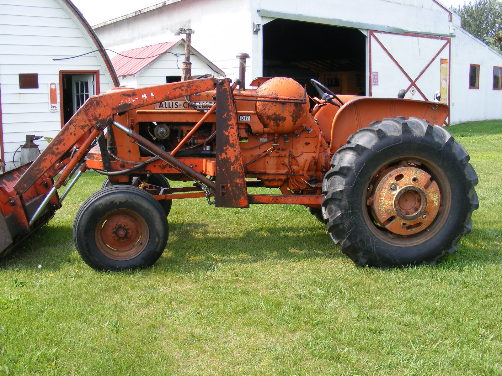

John,  here are a couple of pics of my D17.  Yes,it's all original and I bought it from the original owner. It's a factory LP model and was ordered with the 500 loader.  I bought it needing rear tires and a clutch.  After replacing the clutch and rear tires, it's been my main workhorse for many years now.
