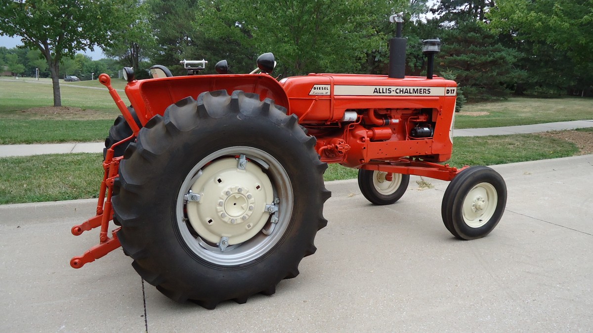

These are 16.9x28 "Power Mark"  tires on my D17serIV.  Made by Kelly-Springfield at the time.  Then later, Titan.
They look proportionally good and have high tread.  But, I don't know if these can still be purchased as Titan quit marketing them.

Originally posted by Gatz in NE Gatz in NE wrote:
These are 16.9x28 "Power Mark"  tires on my D17serIV.  Made by Kelly-Springfield at the time.  The later, Titan.
Gatz not to get off topic but that is one BEAUTIFUL d17!!!!
