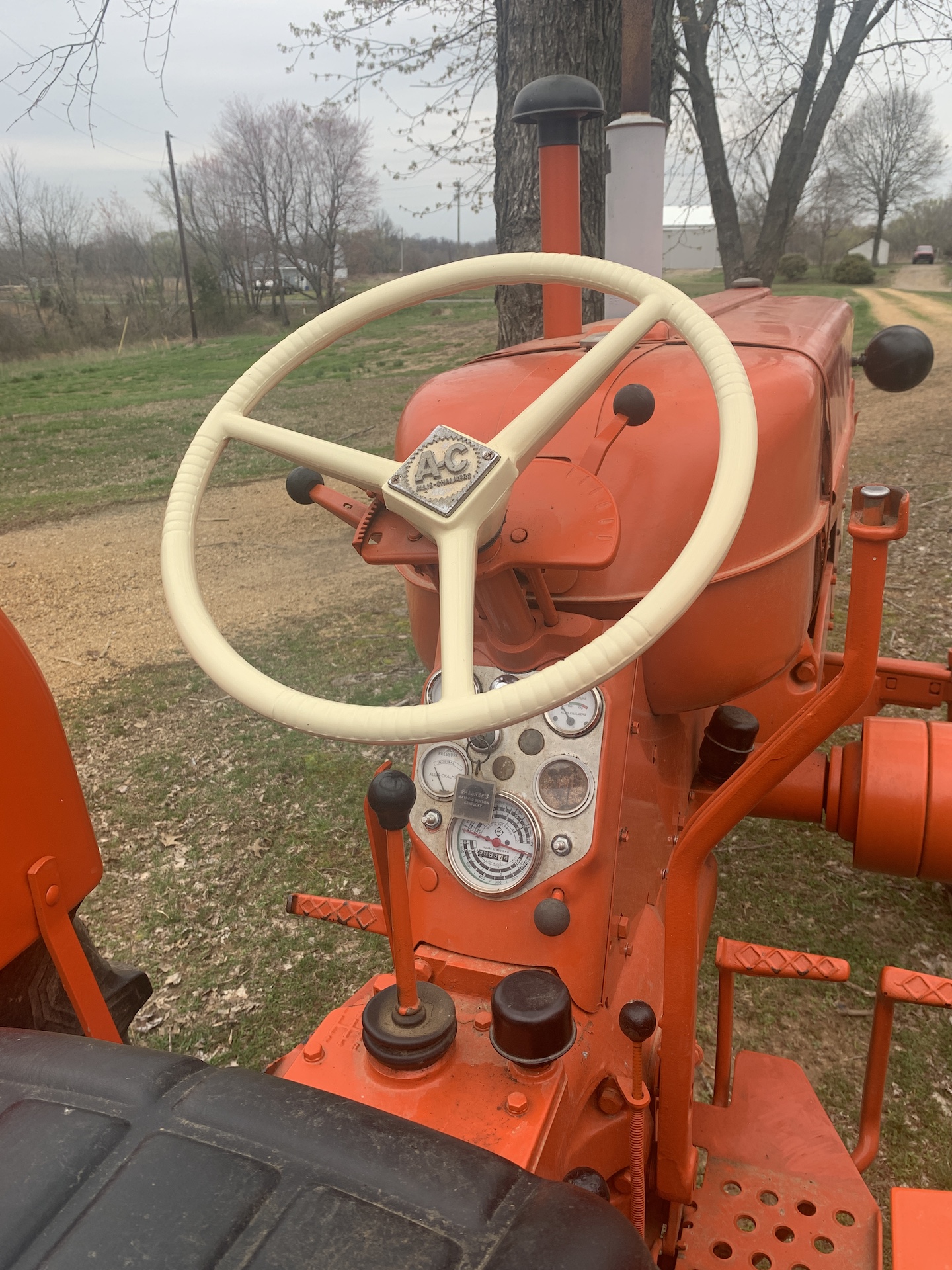

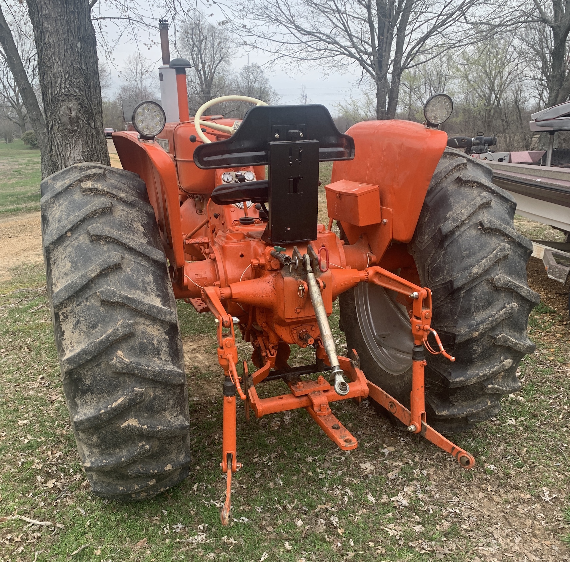

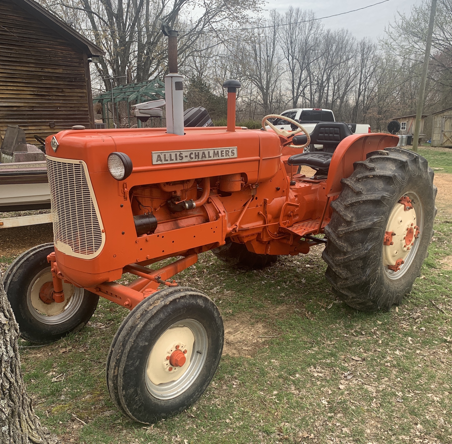

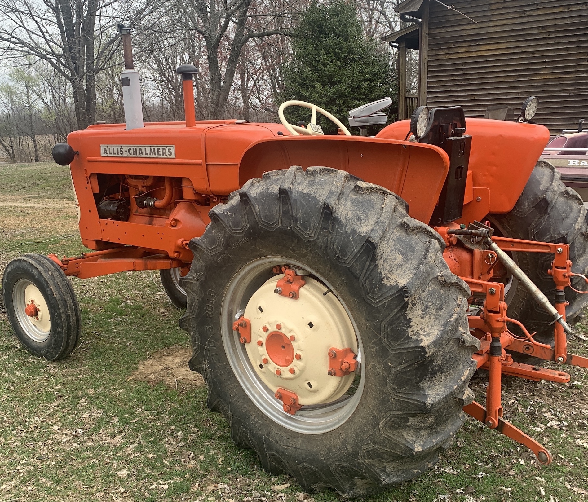

Post Options Post Options   Thanks (0) Thanks(0)   Quote ric44 Quote  Post ReplyReply Direct Link To This Post Posted: 09 Mar 2023 at 11:46am
Here are a few pics of my " Alice " .

Except for the seat and rear lights, it looks exactly like mine.  Your foot pedals look almost like new which is a great thing.  I hope you enjoy your Series II as much as I enjoy mine.  The Series that got forgotten.  Have fun!

Post Options Post Options   Thanks (0) Thanks(0)   Quote DrAllis Quote  Post ReplyReply Direct Link To This Post Posted: 10 Mar 2023 at 8:18am
Better take a close look at the spring from the blocks drain cock to the carburetor. Someone has it connected to the throttle butterfly, instead of the choke. That usually means the governor isn't adjusted or working properly. It will NEVER run up to max speed or HP like that.

Post Options Post Options   Thanks (0) Thanks(0)   Quote ric44 Quote  Post ReplyReply Direct Link To This Post Posted: 10 Mar 2023 at 7:46pm
Oh and I did get that spring moved to the proper position on the choke rod .
