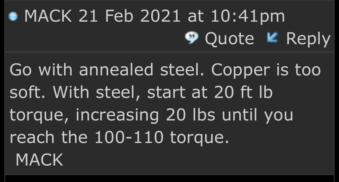

The fire rings on mine look new, would you know were to find those aftermarket ones though? Would his posts still be up somewhere?

Search for posts by MACK. Others on here have bought his fire rings and may be able to divulge some info on them. I’m not sure of the material used, but here’s a thread with some specific info for you.
https://www.allischalmers.com/forum/mack-fire-ring-questions_topic173226.html

Post Options Post Options   Thanks (0) Thanks(0)   Quote 55allis Quote  Post ReplyReply Direct Link To This Post Posted: 5 hours 23 minutes ago at 9:20pm
Here’s a snapshot of what MACK told me on my d262t.
