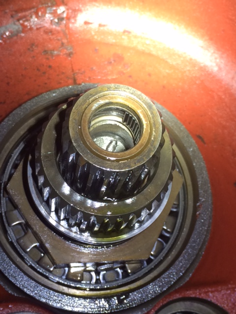

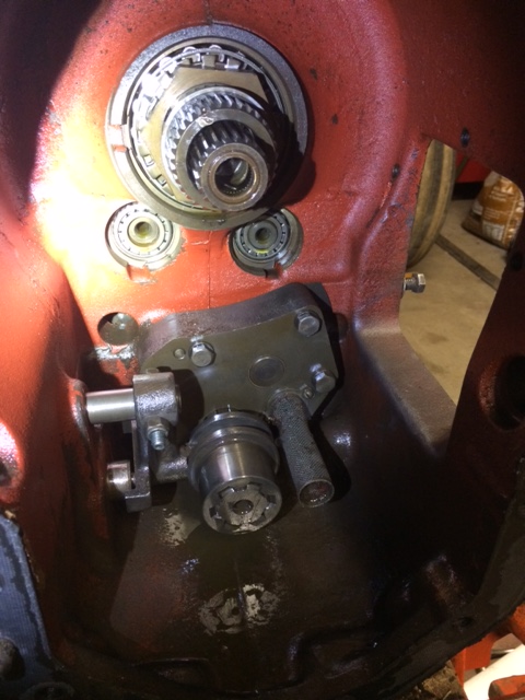

D17 S1 split at torque housing (Clutch shaft bearings)

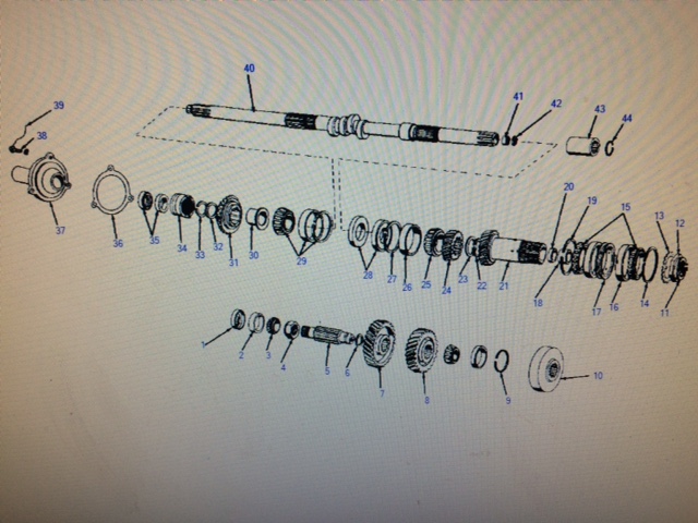

When we split the tractor I noticed that these bearings don't seem be all there. I didn't see any drop out... this is the engine clutch shaft correct? looks like I need to order #41 and #42?

Yes, those are the parts that you need for the clutch shaft. Be sure to also replace the seal on the transmission input shaft behind the power director assembly.
