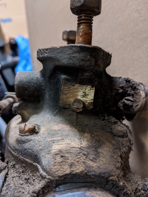

It looks to be a TSX 773 with a number 59 under the TSX part and number three under the seven seven three part here's 2 pictures of my carb off d17.
Edited by Hunt4Allis - 22 Mar 2020 at 9:03am

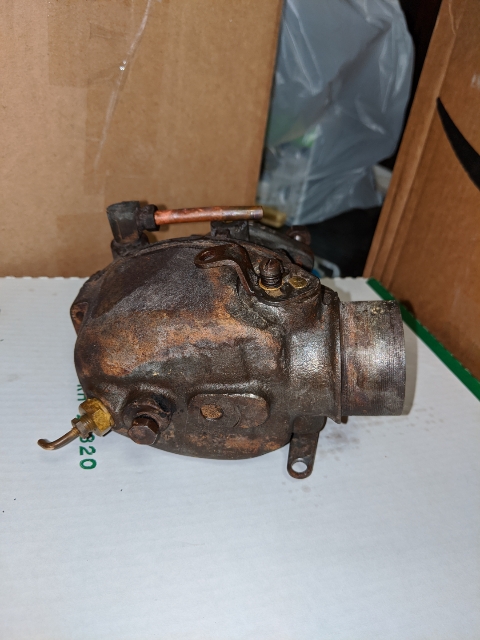

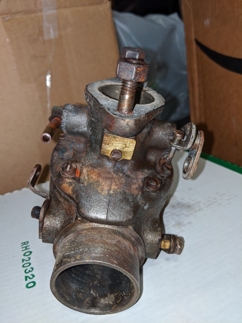

 If you are using a rubber gas line between the sediment bowl and the carb, that may be adding to your problems. They can look fine on the outside, but start breaking down internally and fill little holes in the jets with pieces of rotted rubber.
 I know it's the easy way, with rubber hose, but the original steel lines worked fine for decades and are still the best way to go IMO.
 I had the neighbors 770 Oliver here some years ago and it would run fine for maybe a couple minutes, maybe 5 or more, then die like you shut the key off. I kept thinking the coil or condenser was bad. Come to find out, there were about a dozen of those stinking 'Asian' lady bugs in the tank. They must be able to skinny in thru the gas cap somehow,, when looking for a winter home.
Edited by CTuckerNWIL - 25 Mar 2020 at 8:44am
