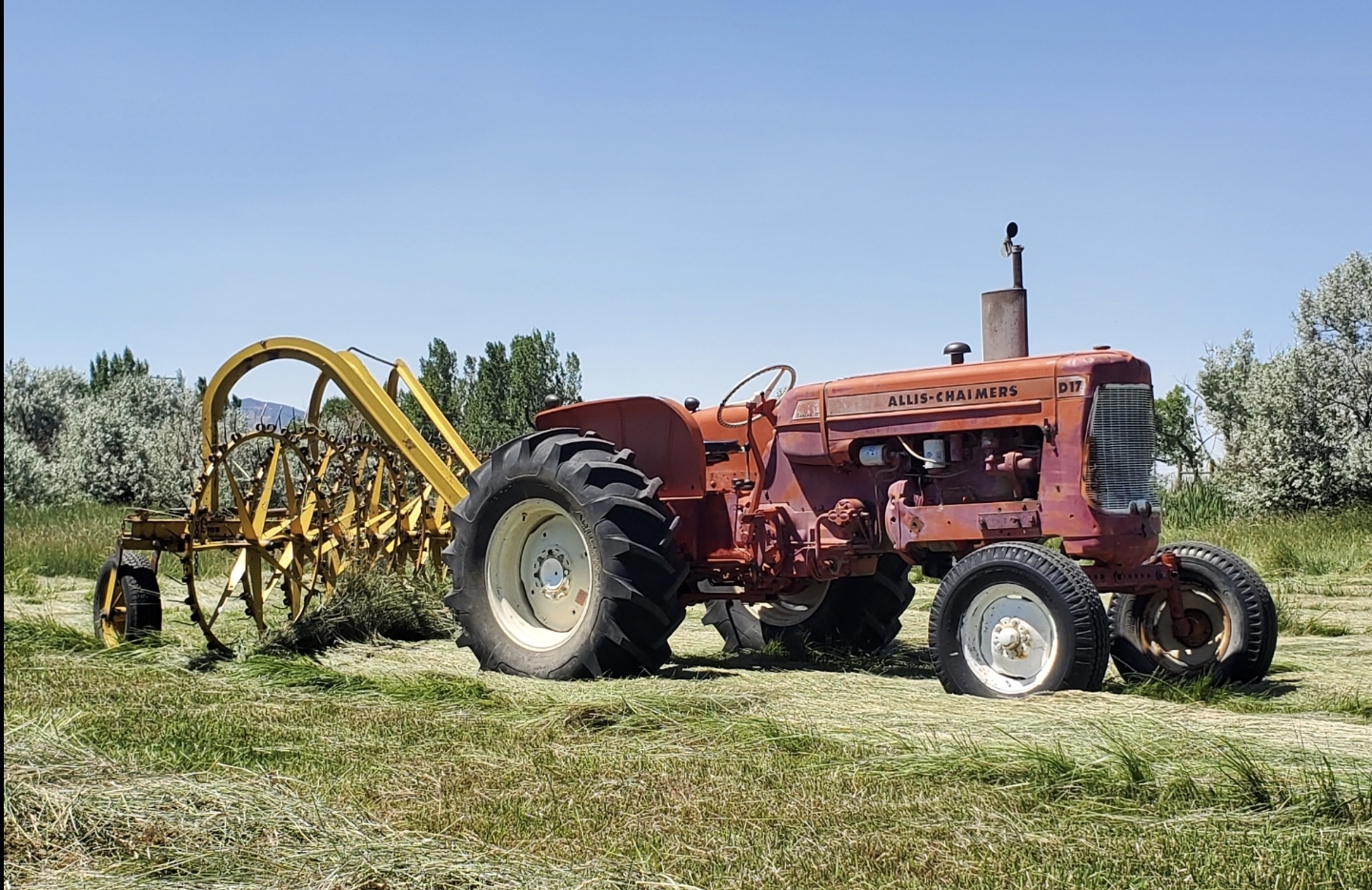

Post Options Post Options   Thanks (0) Thanks(0)   Quote AjsAllis Quote  Post ReplyReply Direct Link To This Post Posted: 07 Jul 2024 at 1:27pm
She's a good tractor I thought I should share a photo for the group.
Points: 22787
Post Options Post Options   Thanks (0) Thanks(0)   Quote DrAllis Quote  Post ReplyReply Direct Link To This Post Posted: 07 Jul 2024 at 1:30pm
You didn't say it was a series 4 with a factory 3-point hitch !!!
