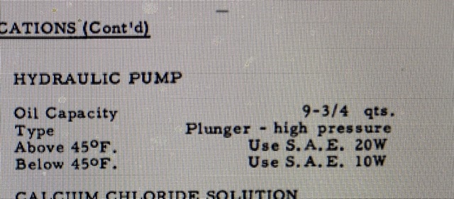

Yea put 28Qt in the transmission/gearbox to the right of the shifter and 9.75QT under the fuel tank. I do Understand the not being able to go into the line as there's no pressure in the gear box to blow it out but didn't know if there was a seal somewhere below that could leak into the sump where the hydro pump is or something. Like thru the drive line from the engine or something. This is my 1st Allis so im not terribly familiar with their internals as I've never torn one apart to know how all the systems are broke apart but I grew up around green and red tractors and working on Diesel stuff out of my shop. I will drain them all tomorrow and make sure I didn't do something stupid and recheck the quartages but like I said when I checked them before starting the tractor all levels were reading full on the stick I did on accident fill the hydro without the lift arms down 1st since mine came without them it didn't even cross my mind perhaps that difference could massively overfill the hydro system not sure how big of a difference that makes in fluid level but perhaps that could be the issue with it being massively over full with putting in 9.75qt?

My Owners Manual says 8 quarts for the hydraulic system.

Your hydraulic is overfull !!  8 quarts not 9 3/4 quarts.

Weird the digital manual I just purchased from Agco must be wrong if your positive? Was this a common problem with their manuals?

My Owners manual says 8 qts. You're the one with oil overflowing on the ground. Why don't you try 8 quarts and see how that works.

I will just weird it was reading full before hand but like I said ill drain and refill tomorrow starting with 8 qts. But was it common for the manuals to have misprints like that just curious if it is what else I will need to double check on down the road before working on to cross reference.

DrAllis you were correct about the Quartage my service manual from AGCO is incorrect guess I had better double check all specifications on this tractor and cross them on here from now on to be sure they are correct. Thanks
