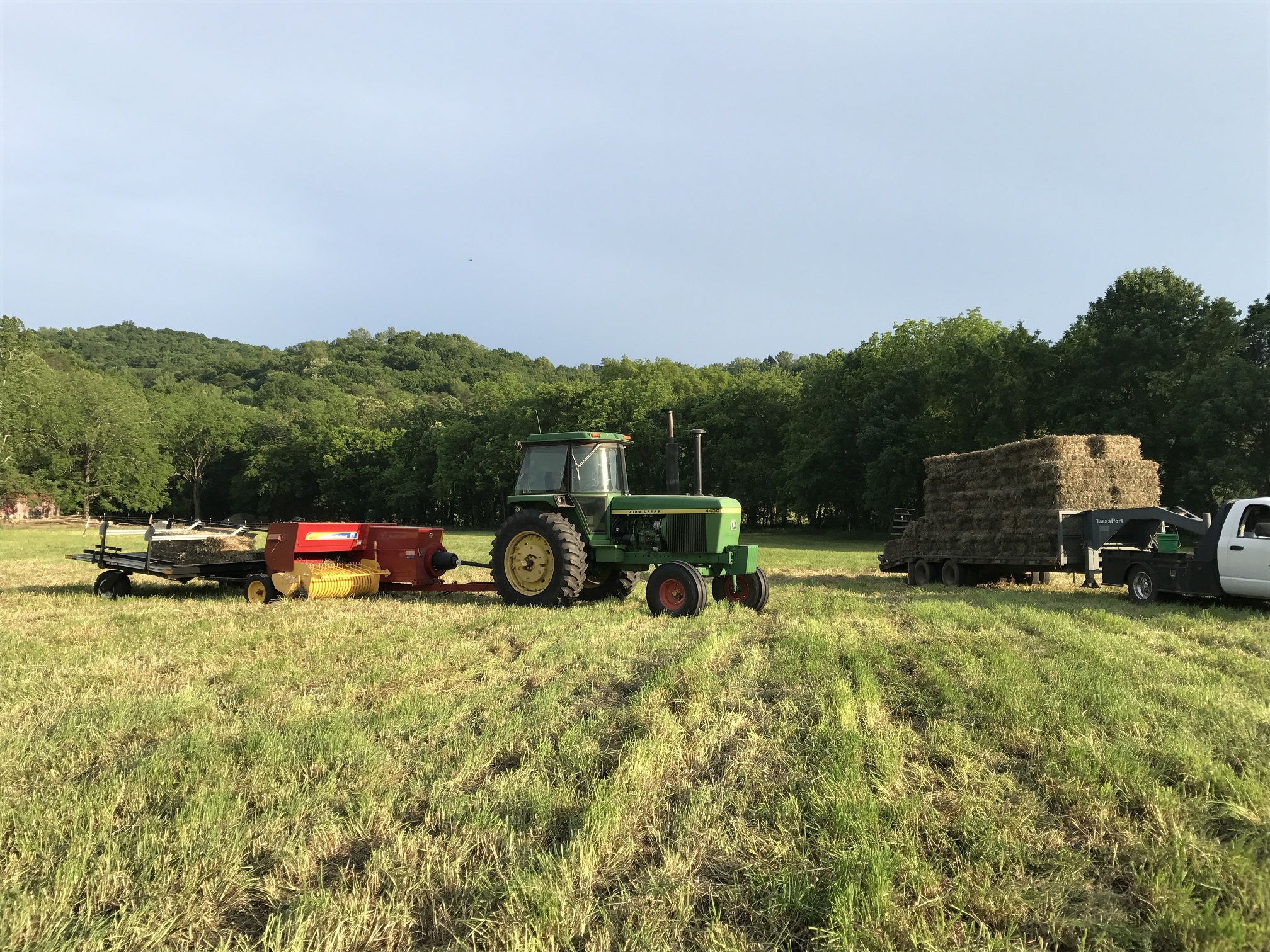

well i bought a hoelscher 1000 accumulator and i was planning on running it with the d17 yesterday and plumed hydraulic and nothing but disaster all day. we thought valves was stuck and i moved about everything i could. well i learned about open and closed center systems and we move some hoses and settings  no change go and get a deere and things works perfect lol
acd21man View Drop Down
Joined: 07 Jan 2010
Location: tn
Points: 831
Post Options Post Options   Thanks (0) Thanks(0)   Quote acd21man Quote  Post ReplyReply Direct Link To This Post Posted: 17 May 2017 at 8:26pm
and thats no joke. we worked all day and nothin it was awfull the 17 was getting in a load bad a times and you could move the table tilt lever and the arm that slings the hay up would come up or the arm lever and the table would go up or sometimes the arm would shoot up. there is 2 setting for open and closed systems hooked the 4430 to it and like a new machine really kinda mad about all this but its ok
then comes the adjustments for the size bale lol but its working good now

Post Options Post Options   Thanks (0) Thanks(0)   Quote acd21man Quote  Post ReplyReply Direct Link To This Post Posted: 19 May 2017 at 6:28pm
dan73 its just a 1967 d17 series 4 has good strong hyds. i was talking to a AC dealer in athens ga and he said that he has fooled with this stuff alot and sometimes its can take a act of congress to get one to function right....
but i did end up getting 800 bales up with it with very little sweat lol since my AC is out lol
i think the gleaner wheels are what saved the day

Post Options Post Options   Thanks (0) Thanks(0)   Quote Dan73 Quote  Post ReplyReply Direct Link To This Post Posted: 19 May 2017 at 7:18pm
Looks like you did a great job stacking those up. I have trouble lining up square enough to get them stacked too high.
I would think the serries 4 hydraulics would have plenty of flow for the accumulator.   I would probably check the pressure release to make sure your system is developing good pressure. The other thought that comes to mind is does the valve kick off when the accumulator comes to the end of stroke some valves will pop back to center. I don't know how the serries 4 hydraulics are actually setup as I have ever used one.
