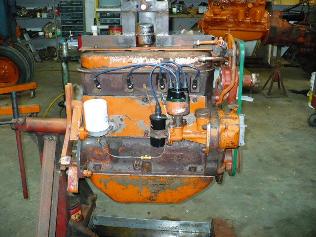

Here's a shot of my angle iron bracket, works nice with three bolt holes on top.
