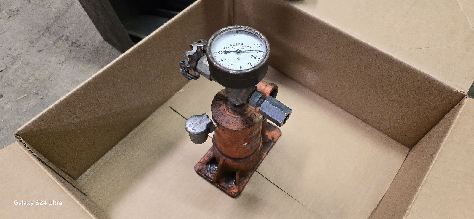

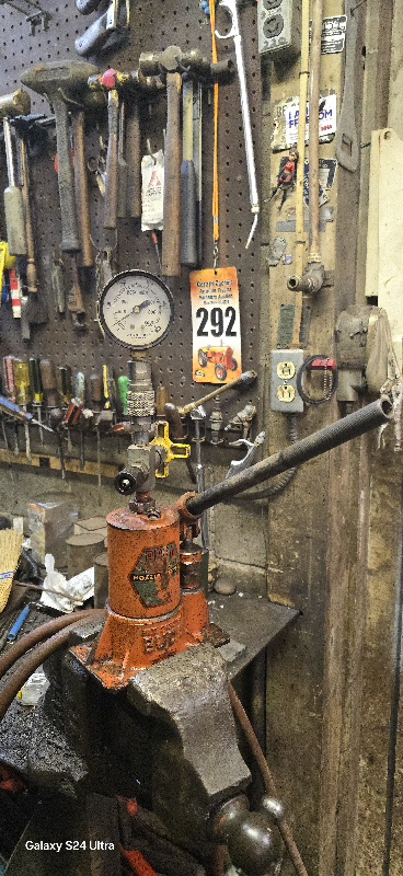

Post Options Post Options   Thanks (0) Thanks(0)   Quote Macon Rounds Quote  Post ReplyReply Direct Link To This Post Posted: 16 hours 49 minutes ago at 7:21am
Previous owner let rain water get in exhaust.
Was just gonna replace 2 damaged pistons and sleeves but found 6 new pistons and sleeves....
It otta run like new now....
Injectors all pattern well...
Tractor had been well maintained as engine had been overhauled in the past...
As well as newer starter, generator and brand new tire....
It did have a steering issues and i belive that's why they parked it...
