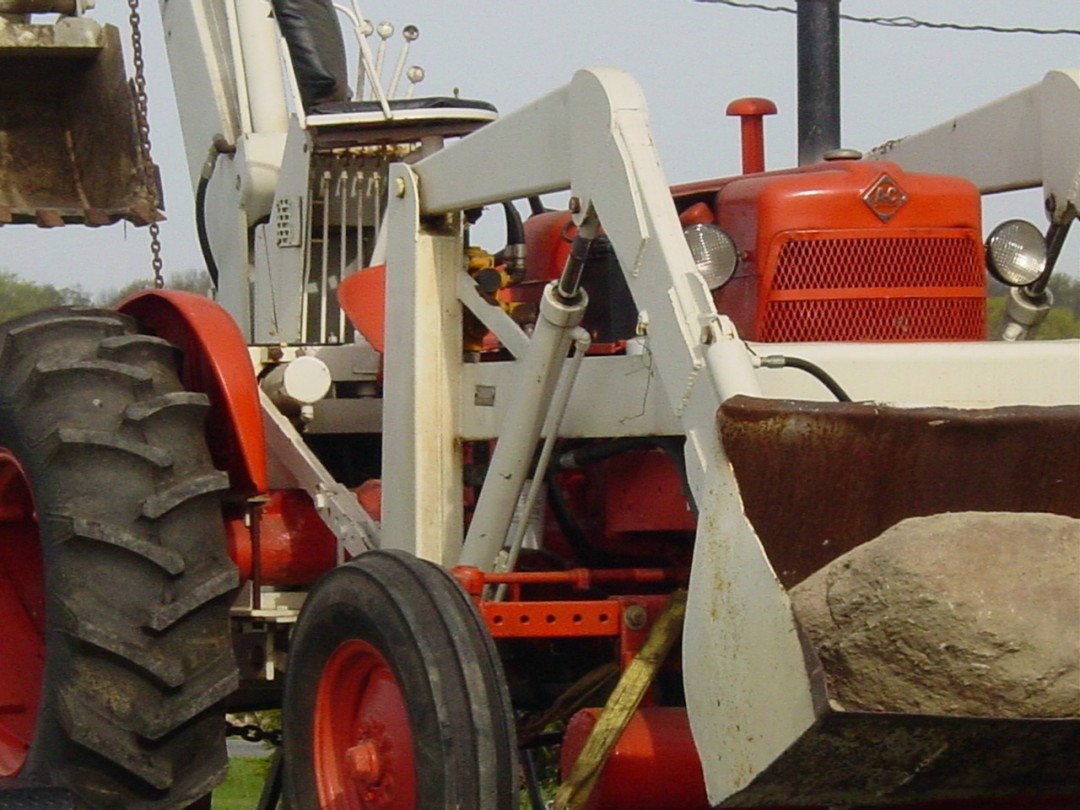

I have one too, although mine really isn't much to look at yet.  The backhoe on mine had been cut off with a torch so I don't have that either.  Here is a link to what mine looked like when I brought it home.
http://home.comcast.net/~old_allis/ac-D17.html
Here is a picture someone posted some time back:

Thanks for the pic tomMN is that book available or is that your own collection. How does it look now any luck putting it together?

I just copied that picture off the forum, it was quite a while back and I can't remember who posted it.  It's not in a book I have.  I haven't done much with mine except take it apart.  The shuttle clutch looks to be good.  The block was no good, it was all split open on the bottom webs between cylinders and the center split through to the main bearing.  I have another block that looks good, but I have not devoted much time to it.
