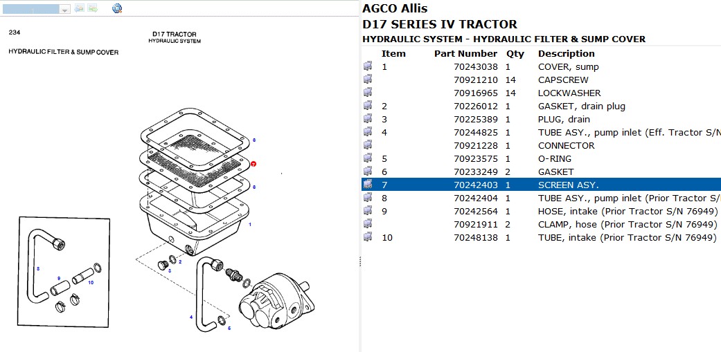

Post Options Post Options   Thanks (0) Thanks(0)   Quote Gatz in NE Quote  Post ReplyReply Direct Link To This Post Posted: 08 Nov 2016 at 8:25pm
The screen on mine was close to being completely plugged.
Not only that, but the ring magnet inside the sump had so much metal & debris on it, it looked like a Chia Pet.
Was surprised the pump even worked.
Like Ryan, there were some areas where the screen mesh had separated from the frame-work.
Soldered it all back up and after making the 2 gaskets, got it all together and it worked fine.
Gaskets are item 6 below.  Use plenty of Permatex #2 when assembling. That's alot better than silicone sealants.
And, Like Ryan said the screen is not available either.
If yours isn't any good, you might check around to see if any AGCO dealers might have one stashed away.
It's p/n  70242403  item 7 below
Otherwise, repair it so that the mesh is 100% complete.
BTW, I don't see a magnet on this parts breakdown.. IDK if that was an option ?
