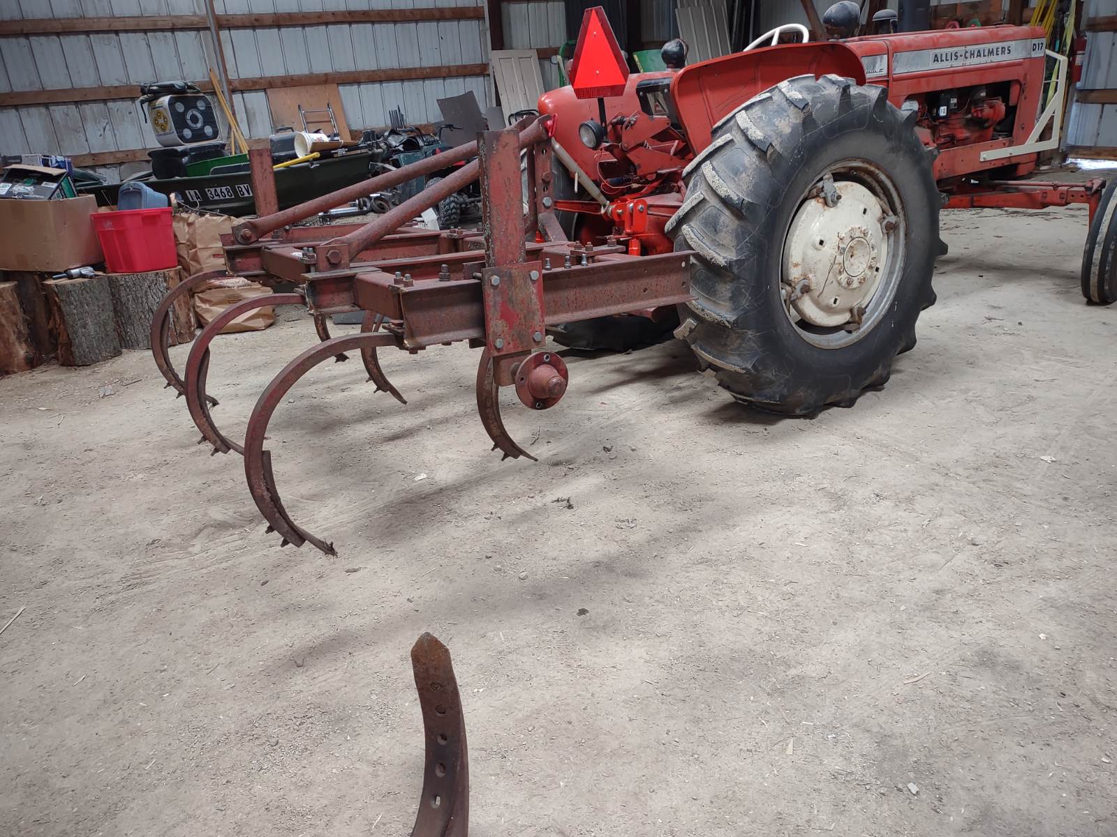

I'm having the same issues with my D17, which I'm trying to start using for food plot work.  Just bought and cut down a chisel plow and it still wont lift it.  Weak 3 point lifting, hyd oil was low, trans oil high.  Sounds like Doc's Dx.   I think I have a manual here somewhere - I need to find it, but have never split a tractor before.
Should it lift this, if working well?

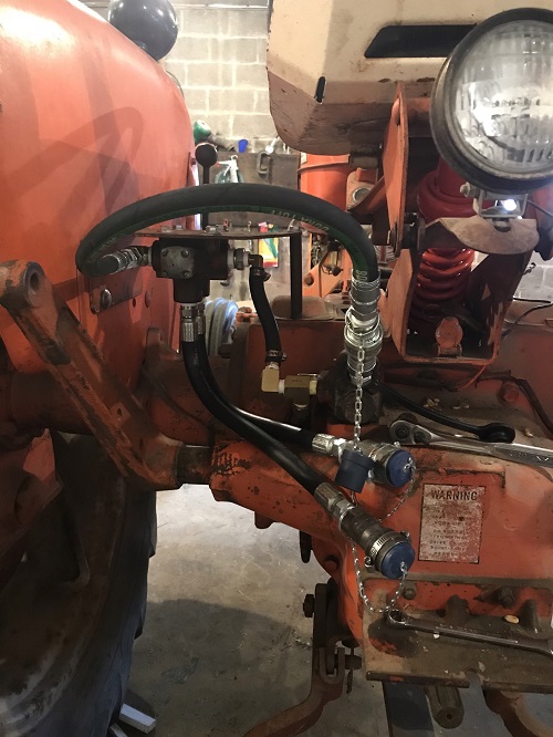

  I can't say I've ever seen a remote valve plumbed like that one. Don't know how it even works. All wrong as far as I'm concerned.
Ha!  I'm glad I posted that pic.  I don't know if the remote DOES work.  I didn't install that, nor have I ever used it.  I've only had this tractor for a few years, and only recently installed the 3 point conversion to even try to raise anything.  I will have to re-do that too (or maybe just remove it completely).  The rear remote is not needed for the lift arms to work, is it?
Thanks!!!
Edited by GSTROM99 - 13 Mar 2024 at 7:48am
Points: 22777
Post Options Post Options   Thanks (0) Thanks(0)   Quote DrAllis Quote  Post ReplyReply Direct Link To This Post Posted: 13 Mar 2024 at 8:19am
EXTRA dual-acting remote valve not needed. Where your hose is connected to the Transport valve is normally where the remote female coupler is installed. You'll have to remove the tee to make things work as OEM. Be sure to use two open end wrenches on that brass elbow or you will crush it/ruin it.

Here's a picture of how I connected my vavle a year ago. Mine is plugged into the remote and can be disconnected to use your standard high pressure system cylinder.

In reference to the hydraulics ….. Our ‘58 D17 Diesel had sufficient hydraulic power to lift the entire wide front end off the ground.  We discovered this when using our home-built platform to transport a rotary hoe across a small stream.  I had to climb on the front axle to add some more weight while Dad drove the tractor.  Nearly got my toes smashed doing so.
Edited by Gatz in NE - 13 Mar 2024 at 1:44pm
Points: 22777
Post Options Post Options   Thanks (0) Thanks(0)   Quote DrAllis Quote  Post ReplyReply Direct Link To This Post Posted: 13 Mar 2024 at 5:34pm
Agreed. A healthy hydraulic system can usually raise an unweighted front end off the ground.

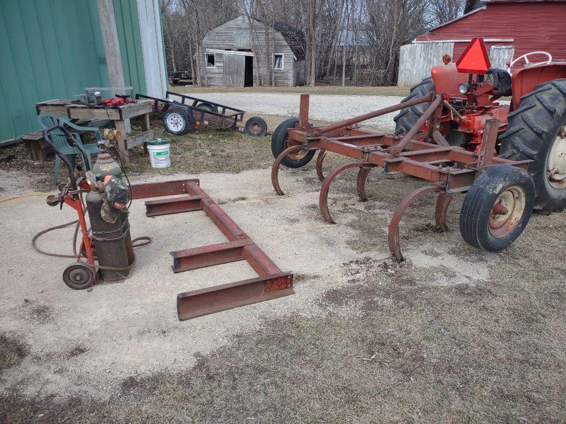

Looks like you have a Cross aftermarket 3 point on your D17, you will still be pulling off the snap coupler because the 3 point attaches to the drawbar which attaches to the snap coupler bell.

now you have to weld the digger back together
GSTROM99 View Drop Down
Joined: 12 Dec 2020
Location: Greene, IA
Points: 246
Post Options Post Options   Thanks (0) Thanks(0)   Quote GSTROM99 Quote  Post ReplyReply Direct Link To This Post Posted: 17 Mar 2024 at 9:14pm
Na, not gonna do that.  I'll replace the bad points and run it with 6.  If it pulls real easy, I can add wings and two points, at the front.  The frame came with the wing mounting holes at the front corners already.  I think pulling 8 shanks would be hard, with only fair tires and not much added fluid in the tires  (20%?) now.
