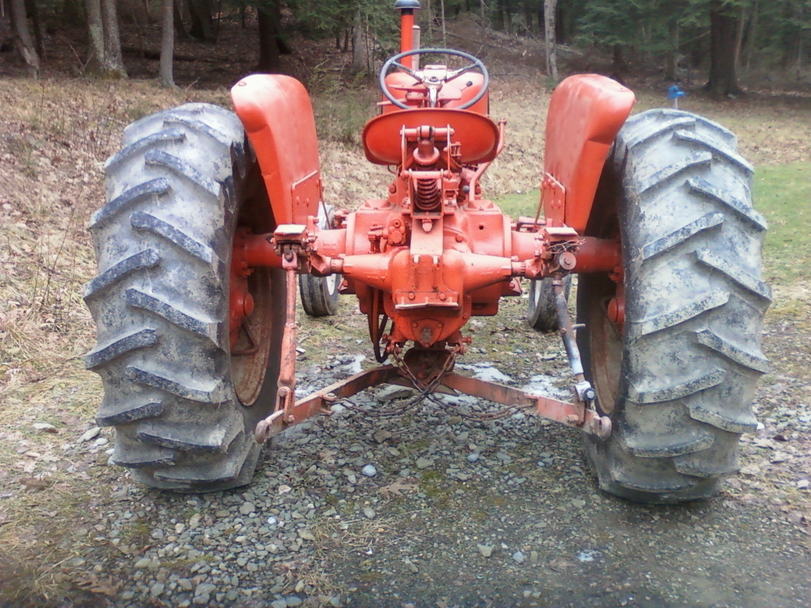

 I recently purchased a 1961 D17.  I believe this would be series II. Runs great back tires new, new paint, Had a B before and then a 59 Massey, which threw a rod snowplowing my driveway. Sold the Massey and bought this D17. Problem is this. I was told it was a three point, but upon further checking, I"m not sure what is hanging off the back of this tractor. I think I kinda might have jumped too quickly on the new tires and power steering without figuring out how to attach my backblade to plow snow. Anyhow I'll attach a picture of what I got and quite possibly someone can fill me in. The swivel balls for the blade pins are not there. Anyhow I'll try the picture idea.

its snap coupler to 3 point conversion hook the side of your blade into your lower armslike normal and get your 3rd member and hook up to the bracket on the back of the lift assembly behide your seat and hook to the top of the 3 point on your blade. and you have it.  exact same as we have on grandpa's d17

What you have is a snap couple with a 3 point adapter, which will work fine.
The holes might be larger then you need, but you can get reducers for them. I have one like that on my CA and WD with class 2 mounting holes in the arms and I use 1 to 2 reducers to make it work. The mount for the top link is there, all you will need is the pin. Bob

the balls are missing, you will need to cut the ends off and go buy a set of replacement ends at a farm and home or somewhere and weld the new ends to the lower arms, but you do have the 3pt adapter on the ol 17.  nor you could buy new lower arms and cut them off and bolt the stubs to your lower arms with a little drilling, either way not a big deal

  I know I need a few small pieces to get the snaps working correctly, I also need the two leveling arms. One is welded and the other is bent. I am pretty fussy guy so I'll need gauges also. Oil pressure is the only  gauge that works. Needs a Creme colored steering wheel and also the tach is missing.Starts and runs perfectly with no smoke or rattles,clutch and brakes are good. Power director works as it should too. PTO runs quiet.Lights are all gone. Power steering smooth and quiet. I know it's POS ground, but I;m not sure if it's 6Vor12V.3rd gear has some noise,but does not popout.

To your point about the swivel balls missing from the three point, I see what you are saying, unfortunately they were probably cut out, they are pressed into place on all three points I have ever seen, unless you have a rare style were there are slots, that they can be inserted and turned, you may be out of luck with that adapter.  Rest assured you have the right tractor, but you may have to find another adapter to make the three point work right.  Doesn't mean you can't use what you have, but it will wear funny, push crooked, and be a basic pain in the butt.

Unfortunately, you're missing a few pieces that originally came with that A-C adaptor.
The stabilizer chains go in the holes ahead of the "clevis" type brackets to which they are now attached. Those "clevis" type brackets are used to connect either the Top link crossbar when utilizing the "traction booster" feature or the stabilizer when using the 3-PH without that feature.
Since you're tractor is equipped with the top-link bracket, I assume that hitch should have originally come with the stabilizer.
The original adjustable lift link has a neat little gearbox with a crank; see picture.
I am postimg a picture showing the pieces that originally came with the adaptor and how they worked.

 Cut off ends and welded new pieces on them. Straightened the adjustable link and fixed the snap with a new rivet and springs. All I'm planning to do with my hitch is plow snow with a back blade. I don't plow backwards anyhow. Driveway is too steep and sliding backwards down it I've already tried a few times with my Massey with chains and I decided against anymore of that. I have no cross piece between the hitch arms, just chains. I guess if it snows anymore I'll give it a shot and see whats happens. Just looking at the hitch arrangement, I agree it doesn't look like pushing is a strong suit. I am goling to need stuff, but I have to do things a little at a time.

 I guess I should have looked at the back of this tractor a little closer before I jumped. The stabilizer bar that I'm missing mentioned in an earlier post. Can someone send me a picture and are they still available anywhere ? I don't plan on doing any heavy farm work with this, just a little driveway grading and snow plowing. I see by the other drawings that the chains are attached at the wrong point on the arms. The tractors saving grace is new tires and engine is very strong, Director works as it should and although 3 gear is somewhat noisy it doen't pop out in high or low.Someday I'd love to put a loader on it,even a trip bucket would work for me.Had a Freeman Trip loader om my 50 and althought it greatly added to the steering effort, it would move alot of snow.And once you got the hang of it you could move dirt and grade with it. And I checked,it is 12V Pos grounnd. no problem for me.I'm gonna need a tach and I'm sure drivecable.Haven't checked distributor yet. Gas guage doesn''t work. Are they just a mechanical float arm off the back of the guage or electrical ? Temp guage doesn't work,Amp guage wiggles but stays at 12 oclock.Hoorah Oil pressure guage does work. And who sells PappY steps for a D. It's big step for an old fat guy. Oh and yes a creme steering wheel and a new seat bushing kit.Oh and a seat cover for my cold hard metal pan. I guess I have to learn a whole new tractor. Almost forgot two little lever handles for up down lever and traction booster lever. Oh and lights, The list goes on and on......

      Progress, Welded new ends on the three point arms. All new bolts and springs on the snaps. Hooked up the back blade, Liftworks good
but chatters a little,oil Full,Holds like it should. Did learn that it needs to warm up a few minutes before I attempt to pull my driveway. If not it dies as soon as I hit the steep part. Warmed up it's fine. Changed out the trans oil, crap looked like runny driveway sealer. Of course now that it's full I got an axle seal leaking. I had a feeling that it wasn't charging even though I don't trust old gauges. Tester on Battery, No charge. Of course when it was barnyard painted every wire actually everything has a thick coat of orange on it. Tractor sat for a year and a half and battery was almost flat. So what's the easiest test to see what's not working? What exactly is "Genny Flashing" I guess I'll take one thing at a time. Need a seat bushing kit, Steering wheel,Gauges, Etc Etc. But it starts and runs great and doesn't jump out of anything.
