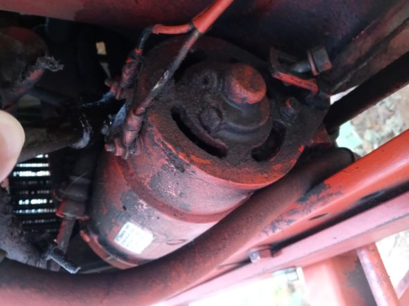

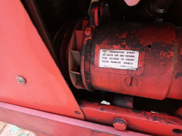

D17 Series III
Two photos.
Generator or Alternator?
D17 Series III
MACK View Drop Down
Joined: 17 Nov 2009
Points: 7664
Post Options Post Options   Thanks (0) Thanks(0)   Quote MACK Quote  Post ReplyReply Direct Link To This Post Posted: 19 Sep 2022 at 9:54pm
generator                           MACK
