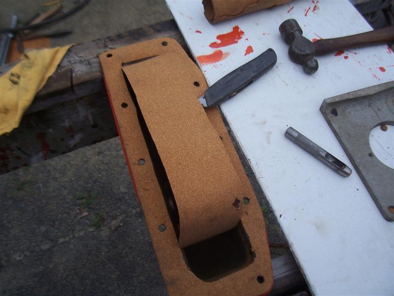

I replaced the oil in the final drives on my D-17 a few years ago.
Dropped the pans and made new gaskets.
I did have the wheels moved out.
I chose to fill the pans before installing them but you could fill thru the fill plug as well.
Not a big job.
