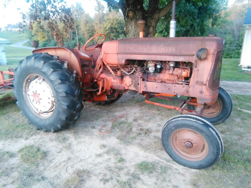

There she is. Used it to mow this afternoon it has plenty of grunt.

The rim and tire I can see don't look bad at all.  Sounds like you are trying to justify to yourself getting rid of it or parting it.

I would like to get an early D17 engine block like the one in the picture. My early D17 has a later block which has a different oiling system.

Not sure how "worn" the D17 really is, but I sure enjoyed discing with mine (ours) today!
Lots of power and the power steering was very comfortable too! Just saying!:) The picture doesn't look any worse than mine. (but my rims are pretty good).
