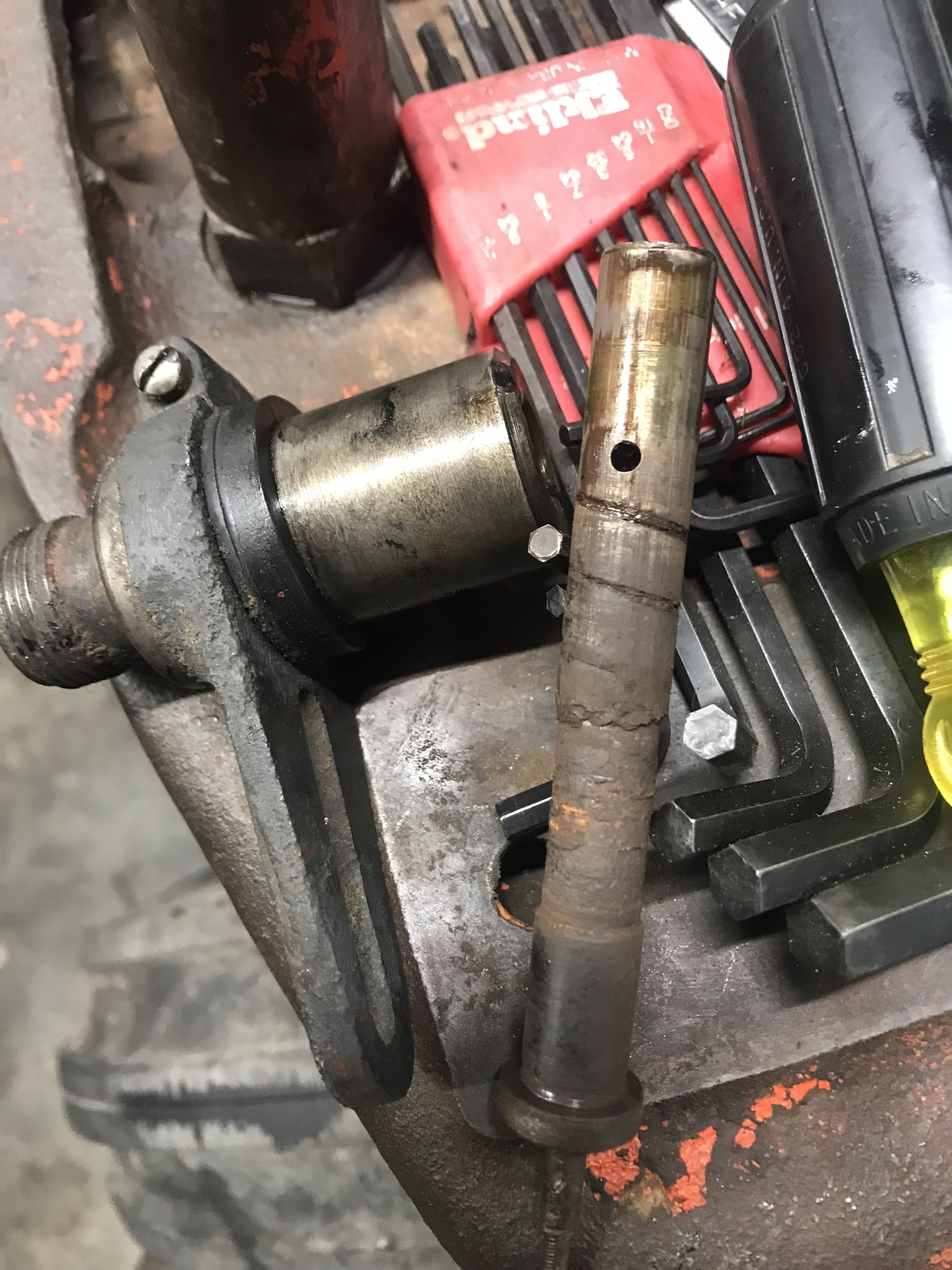

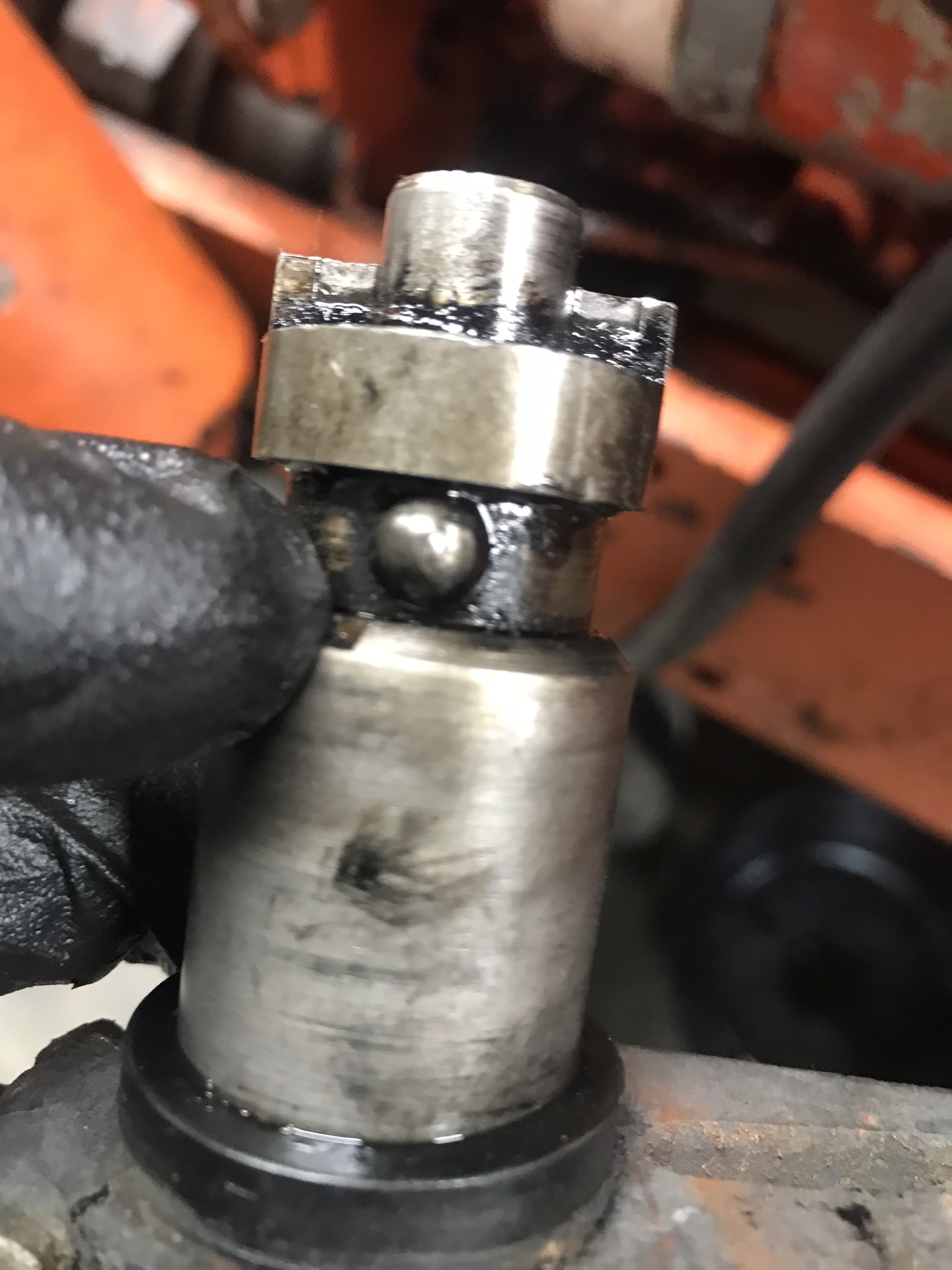

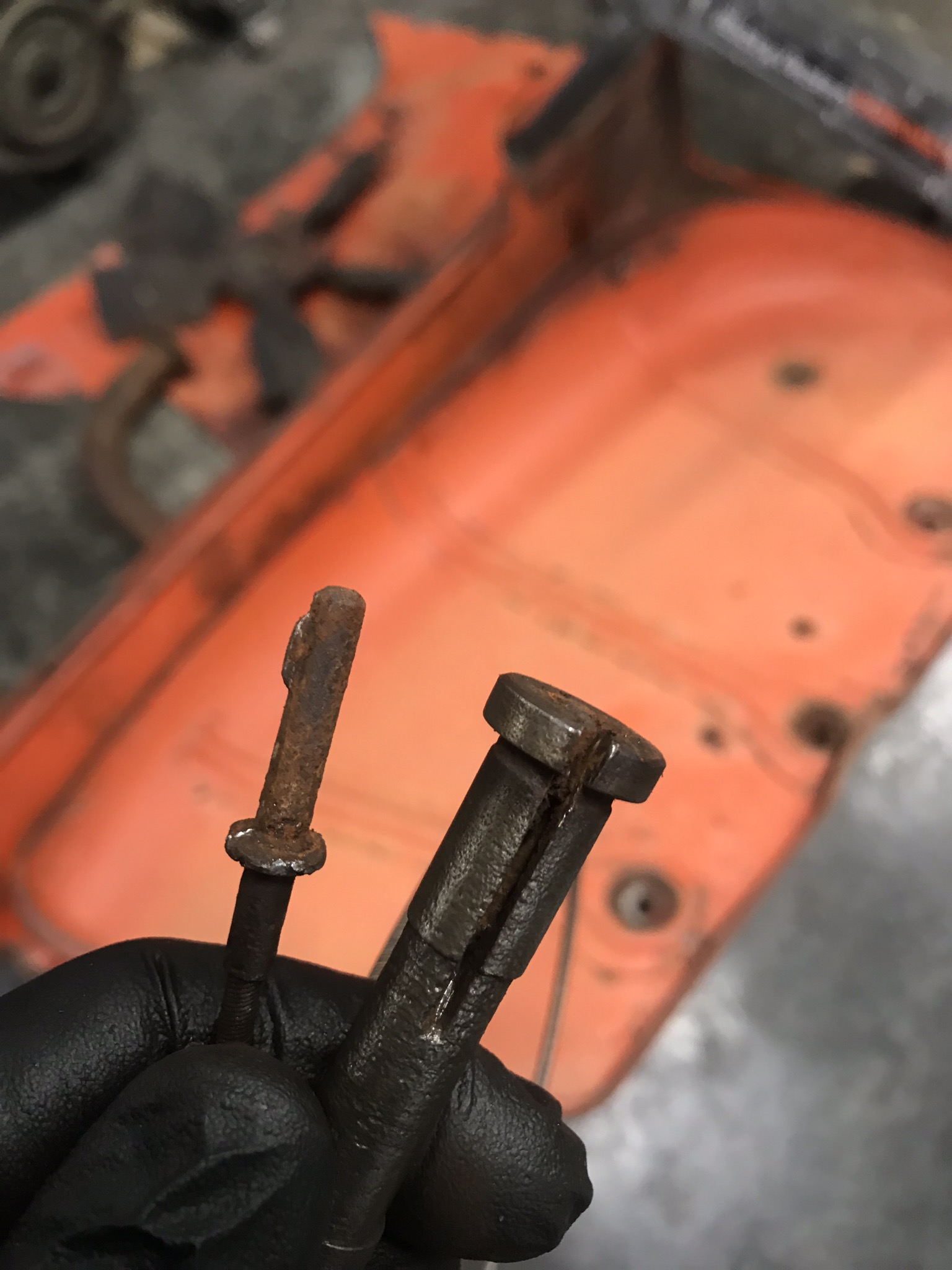

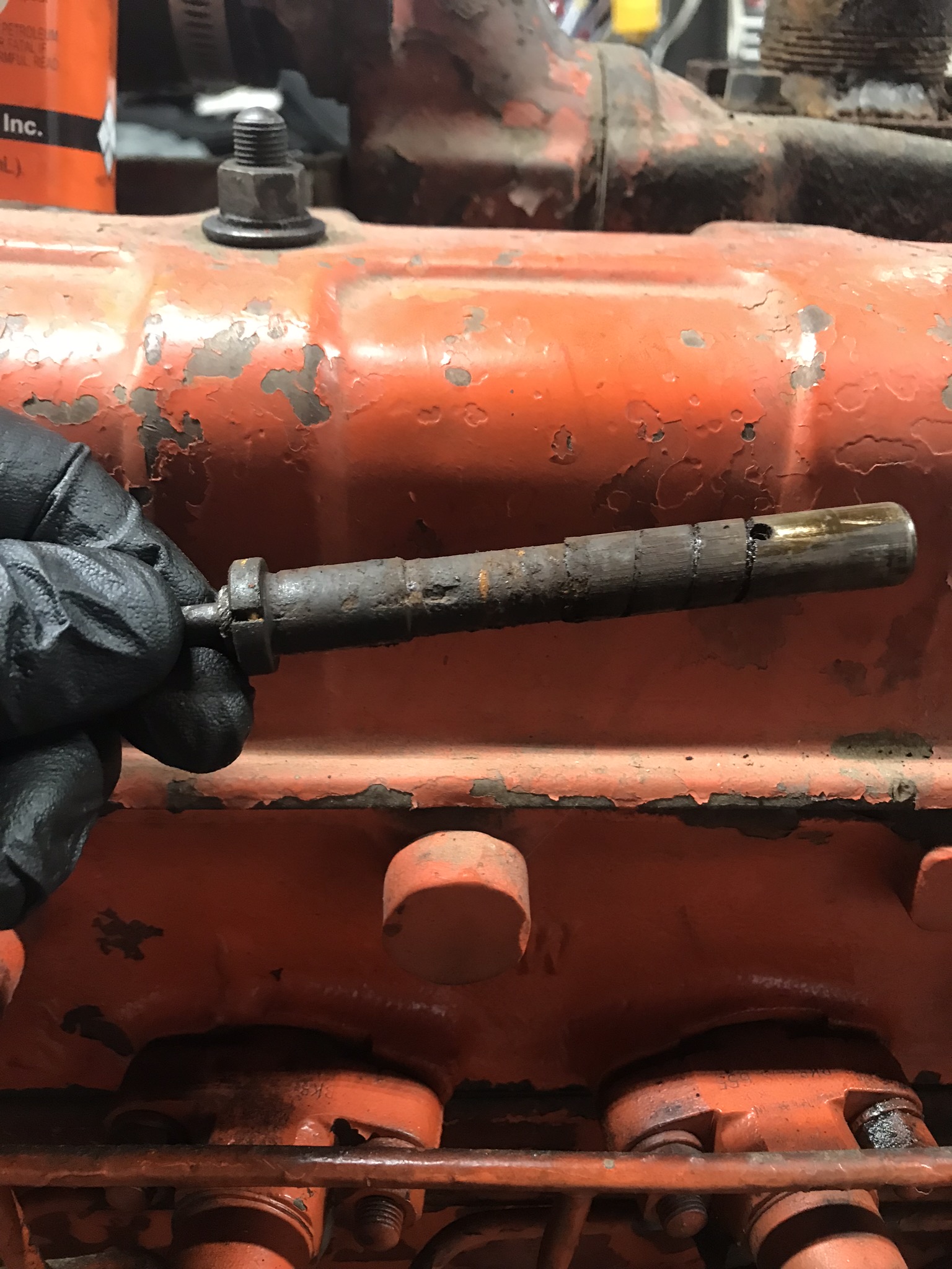

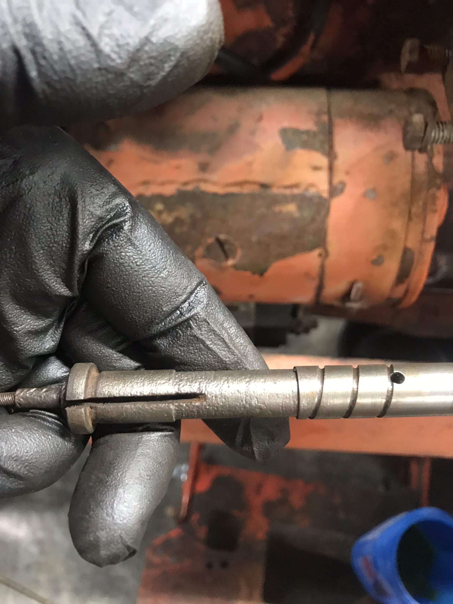

Hope the pictures help. I’m sorry they are so large. My D17 diesel drive. Drive the pin out that I am pointing to. Remove the drive shaft, once I cleaned it up, I used a long skinny punch to drive the tach cable out.
