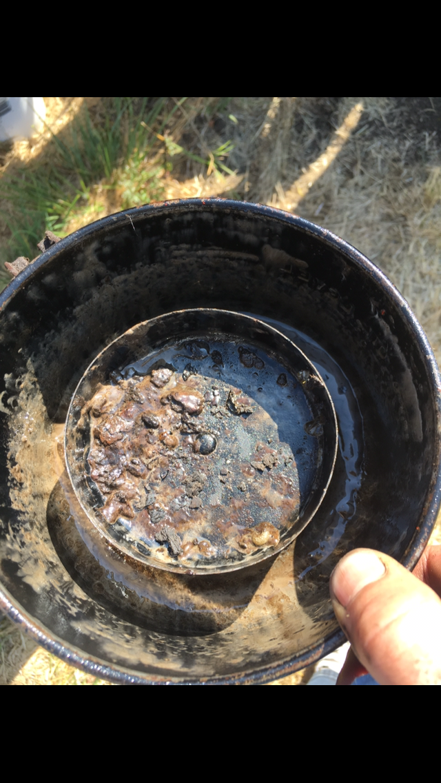

*Oil bath with mesh air cleaner.
Points: 22106
Post Options Post Options   Thanks (0) Thanks(0)   Quote DrAllis Quote  Post ReplyReply Direct Link To This Post Posted: 06 Aug 2019 at 1:57pm
Series 1 and 2 had an oil bath air cleaner. Series 3 and 4 had a dry air filter similar to a car. Or are you talking about the breather cap on top of the valve cover ??
Chisel&Disc View Drop Down
Joined: 04 Aug 2019
Location: Oregon
Points: 9
Post Options Post Options   Thanks (0) Thanks(0)   Quote Chisel&Disc Quote  Post ReplyReply Direct Link To This Post Posted: 06 Aug 2019 at 2:33pm
No I'm talking about and oil bath filter. Funny NAPA did send me a traditional air filter, I figured they were just mistaken. I'll check the serial number and report back.
Don(MO) View Drop Down
Location: Bates City MO.
Points: 6862
Post Options Post Options   Thanks (0) Thanks(0)   Quote Don(MO) Quote  Post ReplyReply Direct Link To This Post Posted: 06 Aug 2019 at 4:48pm
If your D17 has an oil bath air cleaner I'll bet it has the head lights on the front of the tractor (not on the fenders) is the hyd pump mounted on the right side and below the fuel tank outside of the tractor, are the hyd leavers all on the right side of the seat or on the left side of the steering wheel? If you can take a look at all the stuff I listed and let us know then we can tell what Series D17 you have. This just a guess but I thinking someone may have installed Series-4 decals on a Series 1 or 2 tractor.

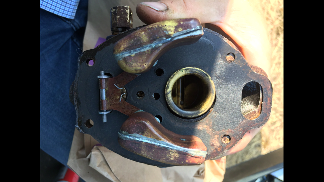

Today I went and picked up a carb rebuild kit although the only items I really needed was a new float and a new glass bowl separator gasket. Neither of which by the way come in the carb rebuild kit. Since I was only about an hour away from Tony's Tractors I decided to stop by and pick up the items which he did have in stock and introduce myself. Anyhow as I said I ended up not using the rebuild kit. I did remove the carb, took it apart again cleaned the body, the jet, and passageways. I reassembled again reusing the old gaskets, they were still very much usable, they don't leak and they don't appear to be breaking down to any discernible degree. Deciding not to continually fight with what I assumed to be the root problem that being the gas tank or more specifically the remaining contamination residing in the gas tank. I decided to take it off the tractor, I repeatedly sloshed it around and quickly dumped out incremental amounts of the previous fuel & carb cleaner mixture attempting to incurage particulate contamination to be picked up and thrown into suspension just long enough to be carried away while dumping. Afterwords I again blew both fuel supply lines out with break clean, cleaned the small screen filter and this time put in the new gasket for the bowl separator after scraping out the rest of what was left of the old one.
Put everything back together fired her up and let her run for a hour plus this evening... No bogging, no hiccups, no signs or sounds of anything except the obvious utter delight of a previously extremely neglected good ol tractor very appreciatively roaring back to life!

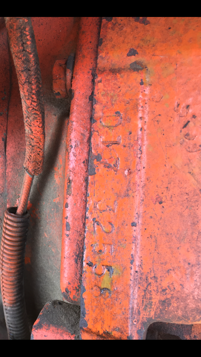

Also while I was at Tony's I had a picture of my serial number D17 32558 and his allis chalmers books confirm as some of you imagined it is not a 1966 Series IV as advertised by the previous owner, instead the serial number makes it a Series II 1961 I believe.

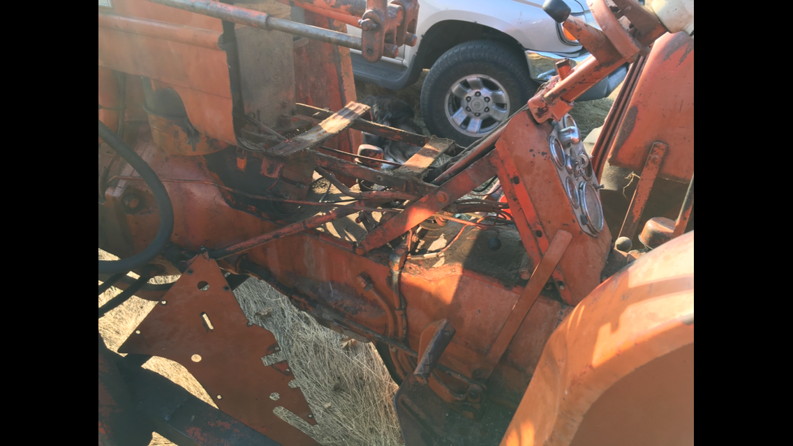

C&D,

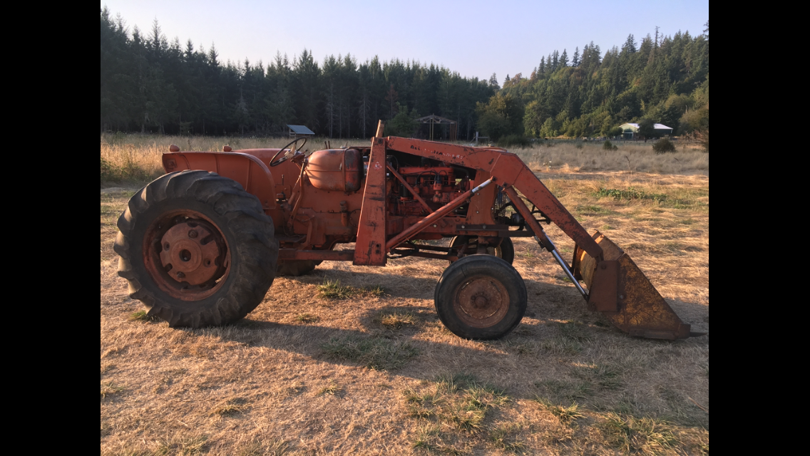

 Thanks for the update on you nice looking D17 series II. I assume you got a new float?
I have done a bunch of carbs and if it was me I would have probably put all the new carb stuff on while it was apart. But if it's running good leave it alone and tuck that away for a time when you might need it.
Does your tractor have power steering?
Joined: 12 Dec 2009
Points: 2014
Post Options Post Options   Thanks (0) Thanks(0)   Quote TimNearFortWorth Quote  Post ReplyReply Direct Link To This Post Posted: 07 Aug 2019 at 12:24pm
Looks to be a 417(?) model loader and good match for the D17 if not over stressed.
May want to lift the front wheels off the ground when you get up and running and check for slop in the "king pin" on the front axle plus double check the drive coupling for the pump at the crank pulley.
Can do plenty of work with that combination, grease gun is your friend for sure.

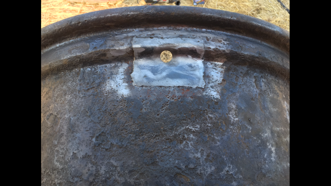

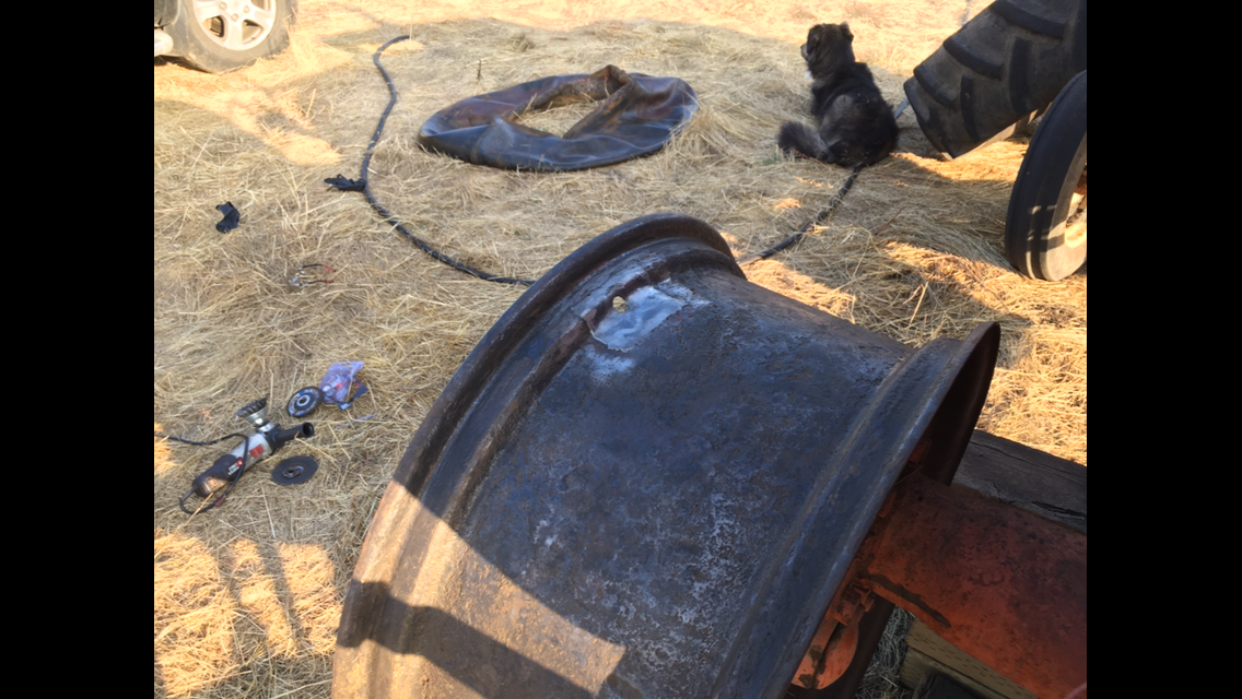

Update...

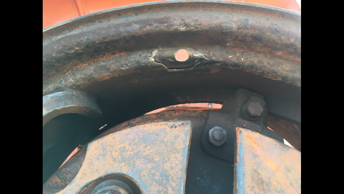

Today I greased her all up, had to use the piston and marvel mystery oil on two zerks of the bunch, one on a king pin and one on the loader but that worked and she's nice and lubed! Got the gear box filled up with 80/90w & hydraulic oil topped off. After that I figured it's time to drive her around the farm and see how well she would do in all gears. Well in the back of my farm there's a switch back dirt road that goes up about 75' in elevation that's in excess of a 15% grade climb. I drove back there in fourth gear which really gets up and moves by the way... Approached the hill in third gear and decided to go for it about 80% throttle. She drove right up without the slightest care in the world in fact almost sounded so good I'd aware She was more stoked than me to be back alive and ready for work!

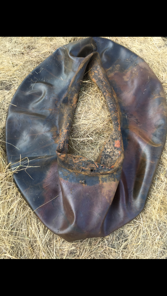

Well that's when I decided the calcium ballast leaking out of the tube and rusting out the left rear rim wasn't going to stay like that any longer.
I forgot to take a before pic of the hole in the rim after taking out the tube.
Here's the tube...
After removing the tube a hole the size silver dollar crumbled out directly around where the calcium ballast had been leaking past a faulty valve core and slowly seeping out of the plastic cap for some time.
Here's after welding in some 3/16" thick flat bar.
Took the grinder with cup wheel and cleaned up the entire inside of the rim, extra thoroughly where the bead will seat. Also took a hand wire brush and small pry bar and cleaned all the deposits off the tire where the bead will seat.
Tomorrow morning we'll get the new tube put in and tire back on.
Edited by Chisel&Disc - 08 Aug 2019 at 2:08am
